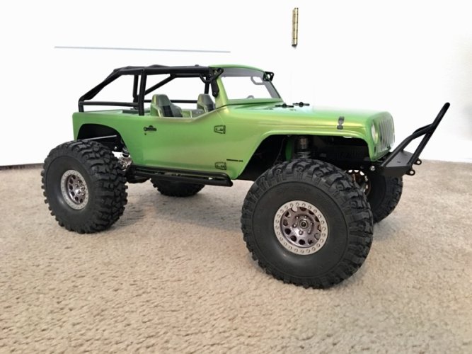

They came out even better than I imagined. I love this truck!

My truck is finished. I got some help from chatting with Ben, and Fracture's build.
Here is how it sits now
Had to use SDI propellershaft for clearance in the front, would not work with stock or MIP. Also had to make a S bend on the panhard to get full compression.
I also shortened the shocks 6mm and mounted them down on the lockouts and c-hubs. Like them low [emoji2]
