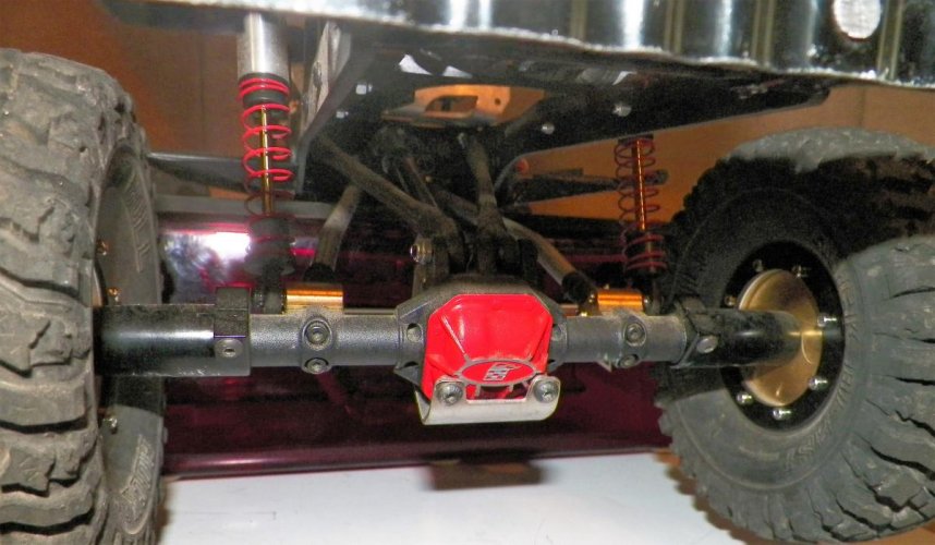

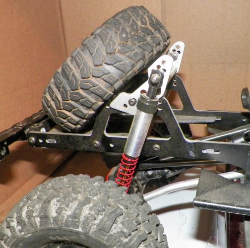

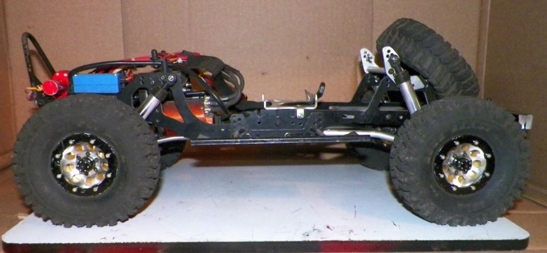

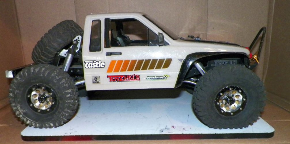

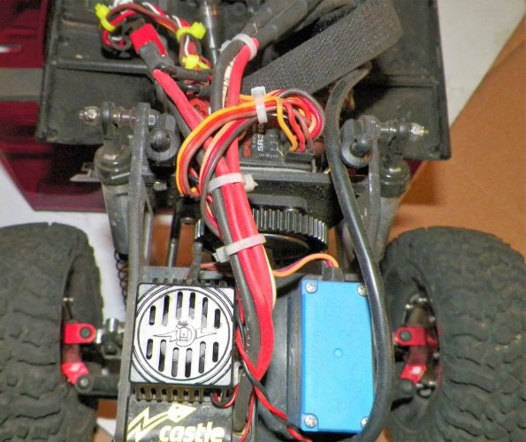

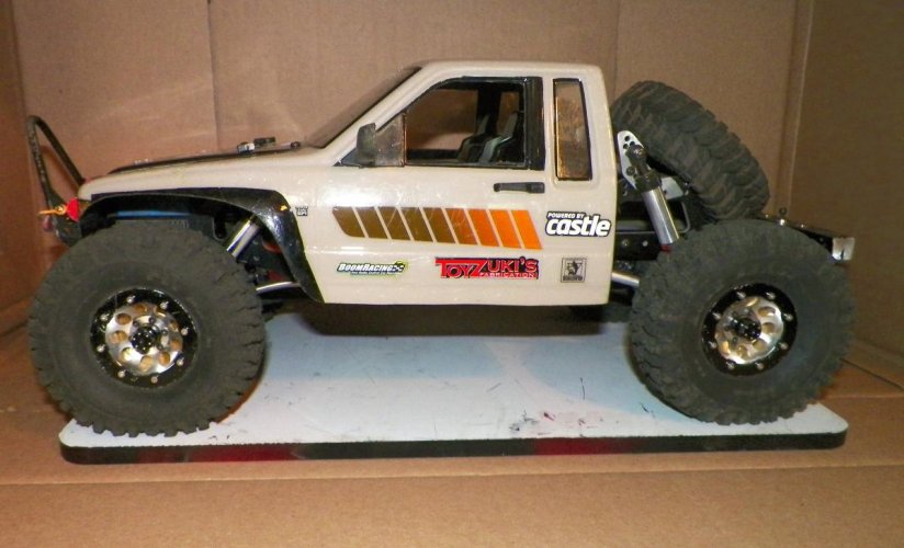

My V2. I've been putting it through hell testing & tuning it this week. So much for the pretty truck bed liner on the ScarerFab armor. Can some one recommend a good light weight 3S. I run some long 20+ minute comps (SORRCA) G6 & long club trail rides. I see some guys running what looks like flight packs. I'm currently running SMC 4400 2S shorties 227g.
