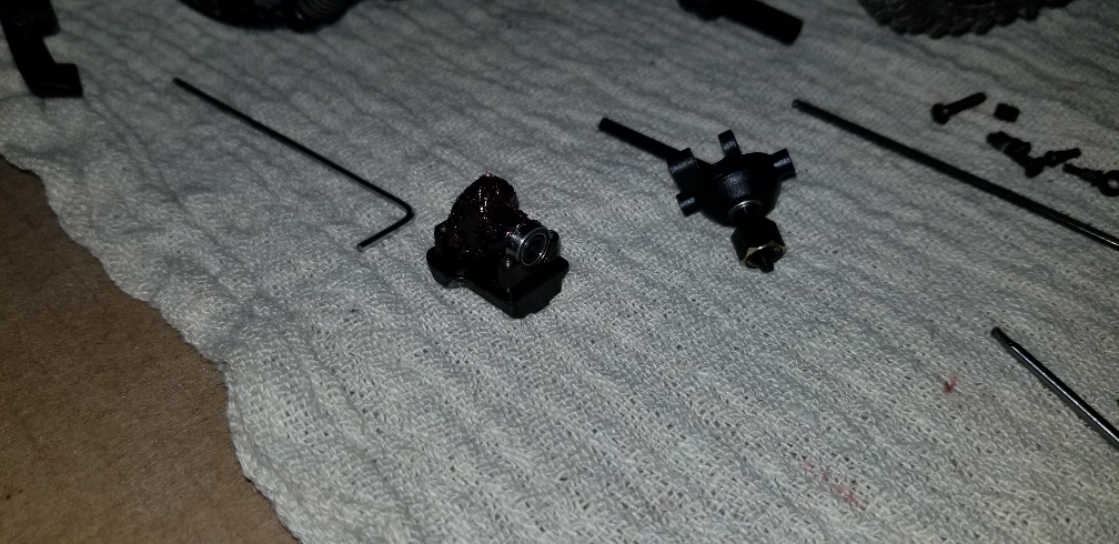

Popped in a set of Injora 12-22 overdrive gears. The Bronco had a pretty good steering radius to begin with but these should help it turn a little tighter and climb a little better.
Slathered with Lucas Read & Tacky and ready for installation. Sorry about the dark picture.

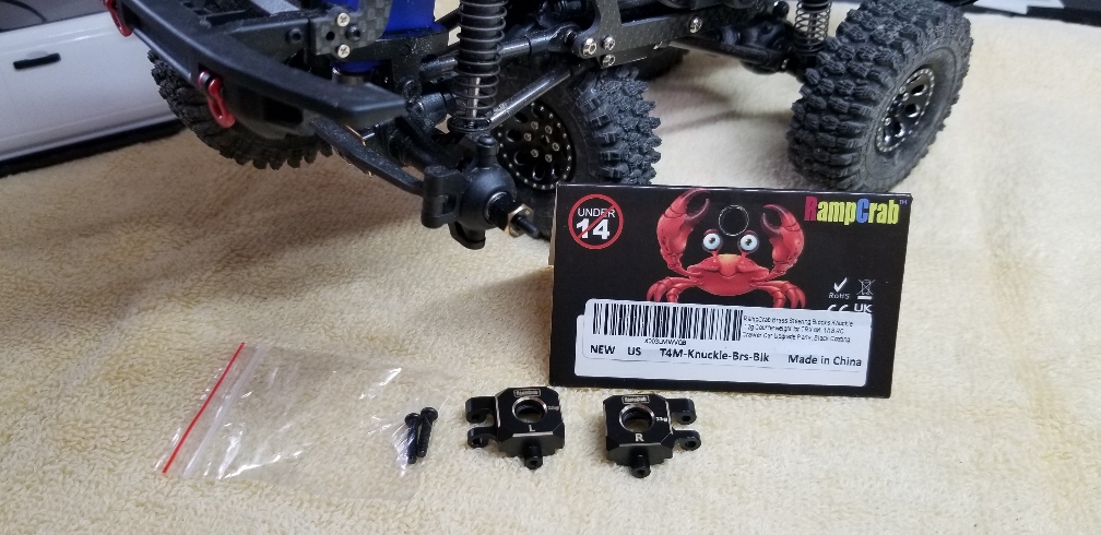

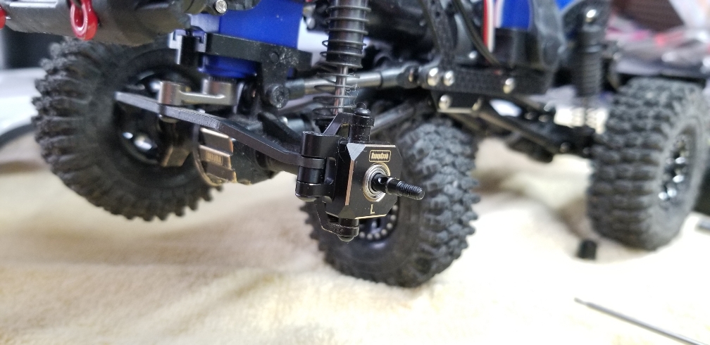

I also reinstalled some brass steering knuckles. I had brass c-hubs and knuckles on there before but took the knuckles off to use on my Defender.
I had to lightly sand off the powder coat on the hubs and knuckles to get these to turn nice and free.
All back together now. Just have to put the hex and wheel back on and we're ready to roll.

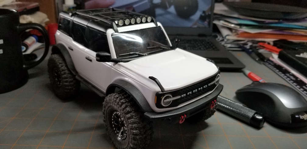

Well, for now I think I have done all the upgrades that I want to this Little White Bronco. I'm very happy with how it has turned out and with how it performs on the trails and rocks. I may in the future take the roof rack off and replace it with an Injora light bar that integrates right into the stock roof rack. That light bar looks much cleaner and would get rid of some weight up top. We'll see?

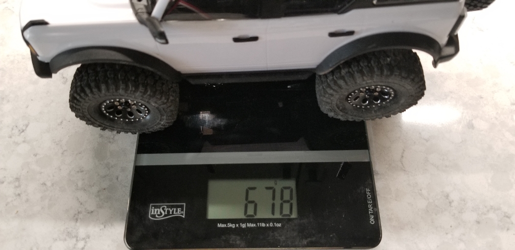

Here is the finish weight with no battery. It started at 509 grams with the Pro Scale light kit installed. It's actually a little lighter than the last time I weighed it due to the Furitek carbon fiber chassis.
Final weight with the battery.

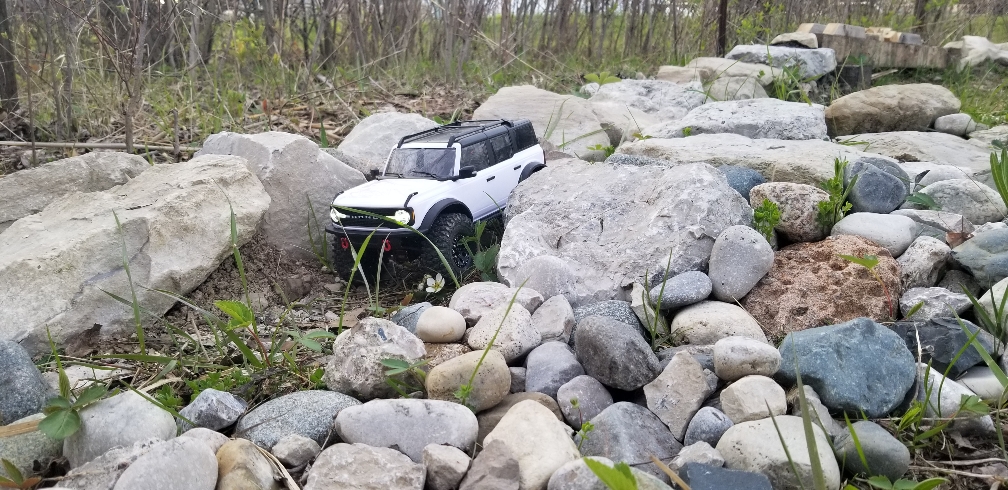

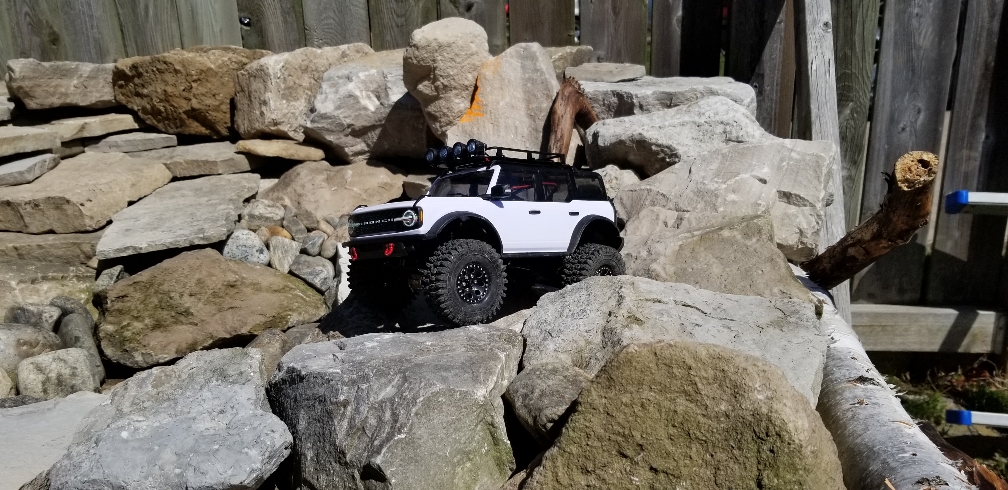

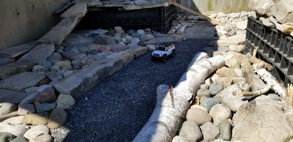

It's a beautiful sunny day here in southwestern Ontario so I took the Bronco out to play in the back yard.

Took the roof rack off the top of the Bronco today. It looks a lot cleaner up top without it and the led light bar was not particularly bright anyway. I'll toss it in the parts bin and find a use for it on some other project later. Less weight up top is always a good thing too.
I ordered up this RC Lions light bar that integrates with the stock roof rack. This light bar looks nice and clean and hopefully it will be a bit brighter too.

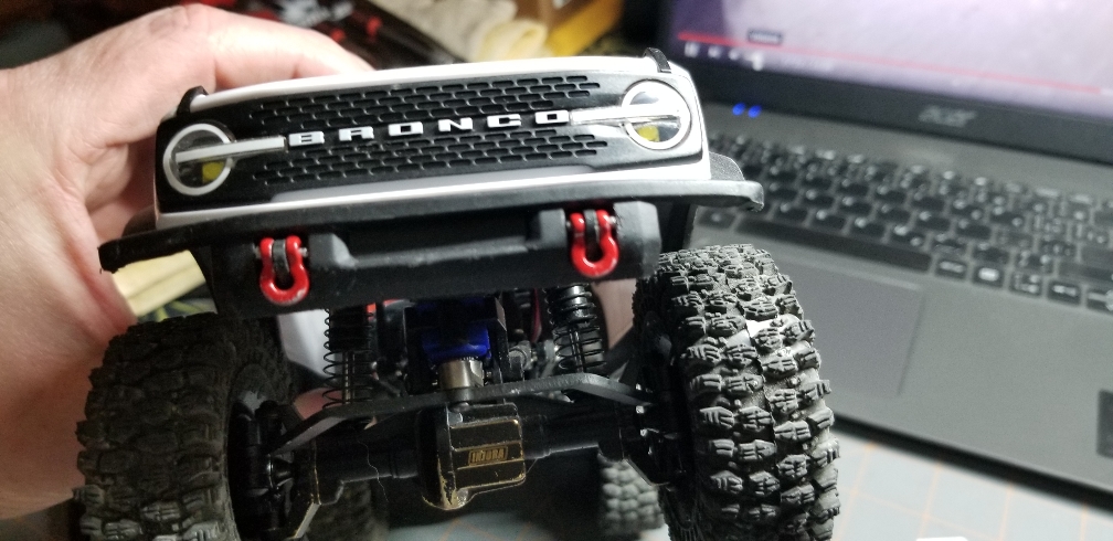

Did a bit more trimming to the front bumper tonight. I decided to trim out the led light buckets since I wasn't using them anyway.
Should give the front tires a better "look" at rocks and other obstacles when approaching.

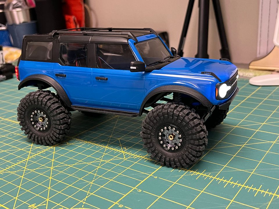

Coming along nicely Jim. I follow your nice Bronco build (and courses)... but swore off upgrades. Well that didn't work! Lol
Did a set of Traxxas wheels/tires and Injora wheels/tires. And a printed bumper.
Need to do the low gear set (hate to lose wheel speed) to make the 62mm tires work - they are a bit much for stock. Then steering.
The little rc sure blows away my Scx24 Chevy in wheeling and realism.
I'm trying to keep up! Cheers
(pic of mine coming along)

Nice!! That's a good looking Bronco. I really like that blue. I keep telling myself I'm done with mods too but as you can see that usually doesn't last very long. My SCX24 Gladiator and TRX4M Bronco are both heavily modified and are pretty close performance wise now, but straight out of the box I think the TRX4Ms perform much better.

Fun little builds for sure! Nate I have the complete crawl trans in hand. Waiting on the 55 turn Injora motor to come, just for the reasons you say (plus I have overdrives in case I need more wheel speed).
I also went down from 62mm tires to 58mm tires, just a tad over stock size. For me it gets too tall & tippy w/62's plus the tires lock up in the wheelwells (I am +2 all around).
I am running without bumpers now using deletes as my high clearance bumpers did not grasp the body latches. Poor print design.
Just my angles from following Jim's lead!

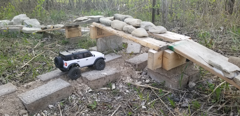

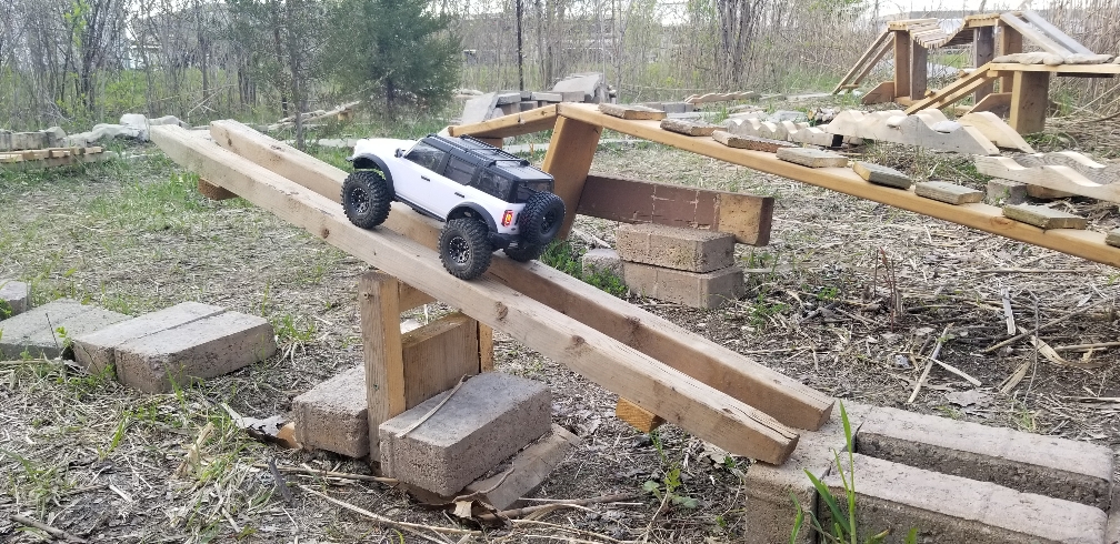

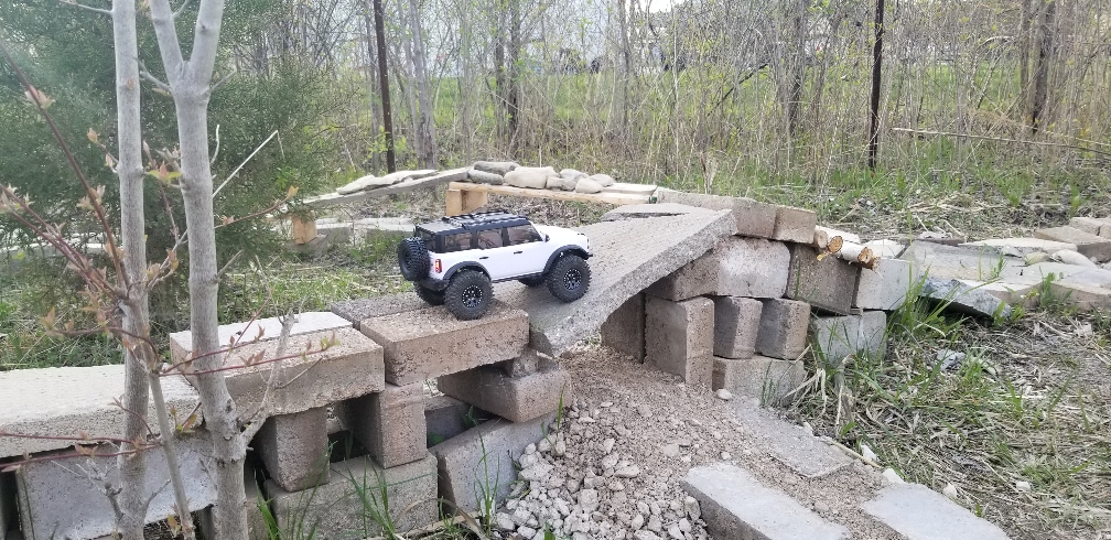

Haven't driven the Bronco in a little while so I took it to work last night for a little spin on the trails.
Under the bridge we go.
And then up and over the teeter totter.
Over the bridge....
....and down through the valley.

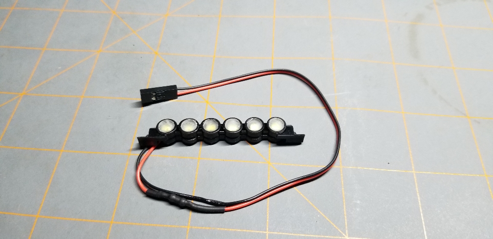

The new light bar showed up yesterday. Gonna see if I can get it installed today some time. Looks like it just clips in under the roof rack? Not a very long wire so that could be interesting.
Sent from my SM-G950W using Tapatalk

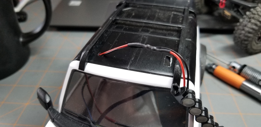

I got the light bar installed today. It was a very simple installation and as it turns out the wire lead was plenty long enough to reach the esc.
I used a body reamer to make a small hole in the roof and passed the wire through after taking the plug end off. I will need to patch and paint the hole from the other light bar.
I loosened the two screws at the top of the windshield a couple of turns and this allowed me to lift the front ends of the roof rack and slide the light bar in place. Tightening the two screws back down firmly holds the light bar in place. A pretty simple and effective design me thinks.
All back together. I like the low profile look and how this light bar blends in better with the lines of the Bronco. Nice and clean.
We have light!! The light lenses are a little hazy but on the bench it seems to throw a good amount of light. Hopefully tonight at work I can see how well it lights up the trails at night.
