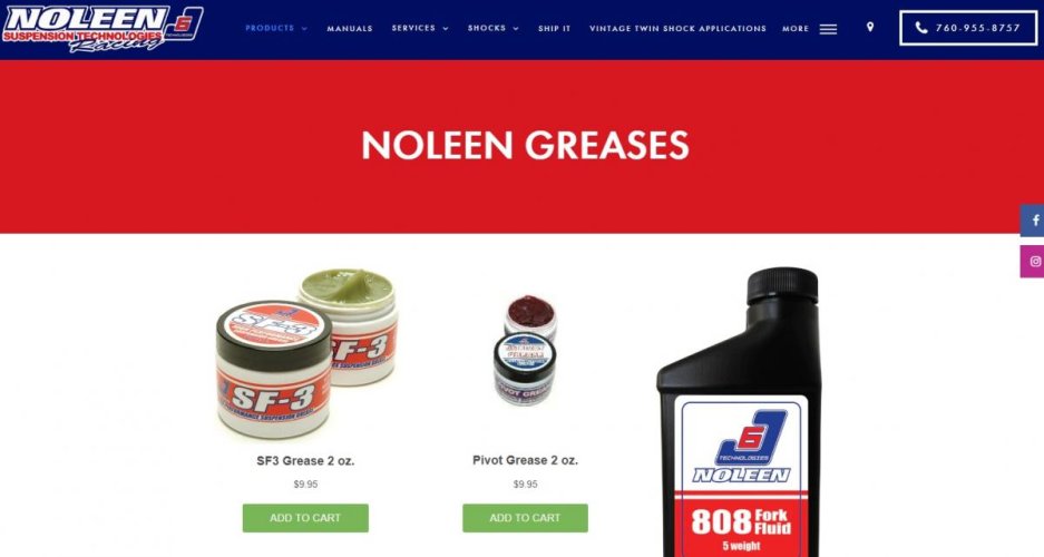

Local retailers don’t seem to want to stock anything anymore. I’d suggest a motorcycle shop to find Noleen products. Bike shops would be another option for other seal greases.
Thank you for the photo of the SRAM Butter. Looks similar to petroleum jelly.
There are tons of seal greases out there for bicycles, motorcycles, etc. I’m sure most would work fine for RC.
Yer welcome J and this was recommended by a friend that owns one of the local bike shops "thumbsup" ... they also rc (bashers) "thumbsup"
Good recommendation then. I am sure our little RCs don't test this seal lube as much as bicycles.
Hey Jim, I bought my Noleen directly from the Noleen website if you ever want to check it out.
lol I'm under no illusion that the shocks will remain leak free for too long lol but yes, it was more than good for me to hear that from him
