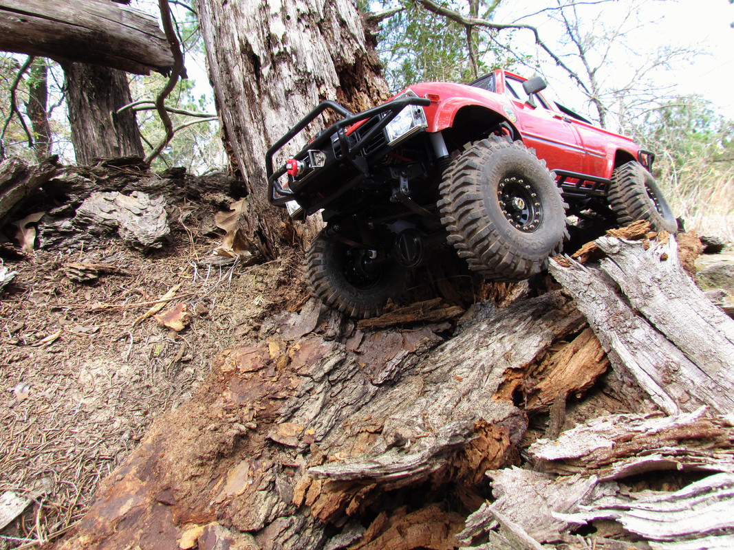

Some pics of last weeks lake trail...
This next one looks just as easy and tame as all get out but at least for this particular day, it was one of the more daunting routes. When I would try to side-hill a little more, she just started feeling sketchy... really loose granulated-silica surface with hard pack dirt under that... all she wanted to do was slide. And I was at the absolute edge on the passenger side. In pics it looks like I could have easily gotten over to the left but it just wasn't the case or at least I didn't feel that it was. A slip up there would've put her submerged upside down in the lake so it was a bit of a butt-clench situation for a few seconds lol.
Coming back was much better since I better knew where to put her...
I absolutely love driving leaf-sprung. I must be crazy but the limitations create challenges and it just makes it super fun. I think maybe I utilize more precision thinking when I'm trailing or crawling the tf2 as opposed to my linked trx4's... at least in an overall sense. Might also be that I may be less willing to totally bash up the Toyota hard body as opposed to my Bronco and D110 trx4's. I cringe more when she rolls lol.
