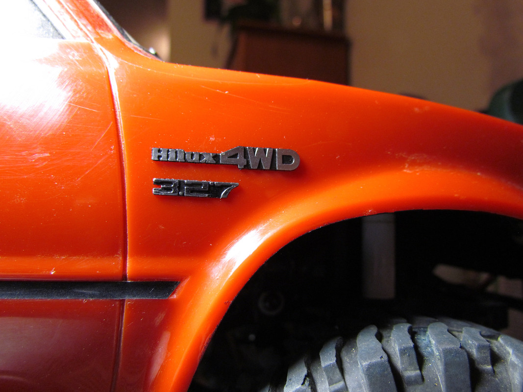

Ha! Maybe that's indeed correct lol. I just installed the badges yesterday and I love 'em. The look of the truck now, only reinforces that it was a good decision to hold off installing the snorkel. After pondering why I got it in the first place, I think that I was just wanting to set this truck apart from the full size Marlin Crawler... so I subsequently wound up buying some stuff that the 1:1 didn't have.
Hey Drifter, your de-marlinized Marlin is looking great! Nice looking wheels. Looking forward to seeing pics of the badges.
Thanks Brian. They were a PITA to do... had to paint em black then sand down for the raised metal to show. Then had to apply the adhesive and make sure to get everything lined up, centered, level, etc before pressing in place. The older I get the harder these tiny detailed tasks are becoming lol.

Next up were the badges. Talk about a delicate project! Anyway... pretty self-explanatory. I painted 'em black then sanded 'em with fine grit. On the Toyota logo front grill badge I actually used a razor blade to remove the black paint from the raised lettering. This was much quicker than sanding and produced great results. I used Gorilla Spray glue ( clear) for the backing. It holds very well with no excess around the edges.
