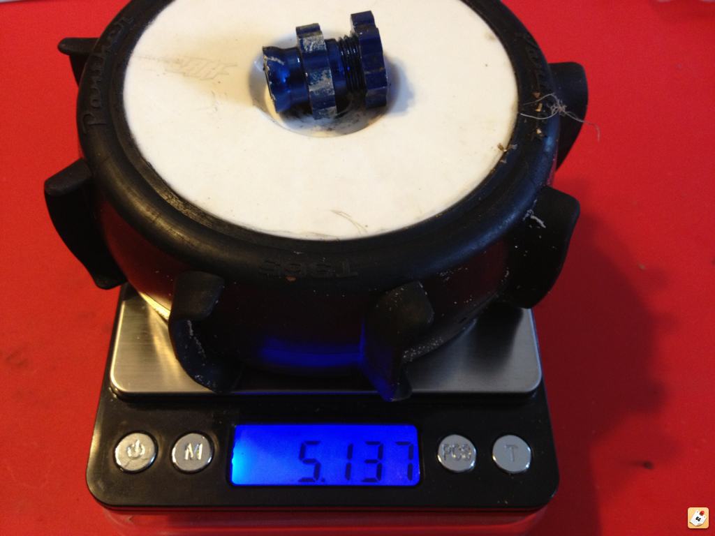

That's quite a weight savings! It worked out better than expected :-)
Now I will have matching track width & wheel offset front & rear, matching height and width paddle tires front & rear. I'm eager to get this to some water to test out.
