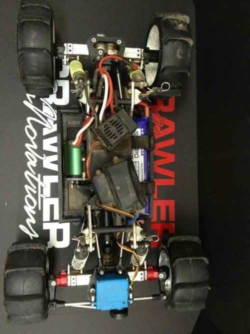

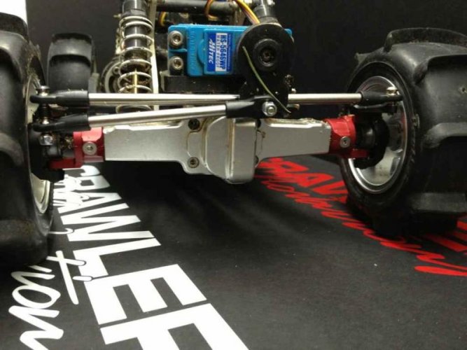

I've been wanting to swap from the stock delrin links that come with the chassis kit to titanium. I'm after some weight savings, added strength, and the added clearance is nice.
Lunsford ti:
Installed:

Back together as running after months of sitting around broken.
Track width is now 10.5" from outside edge to outside edge in the front. I hope this eats up some water :-)

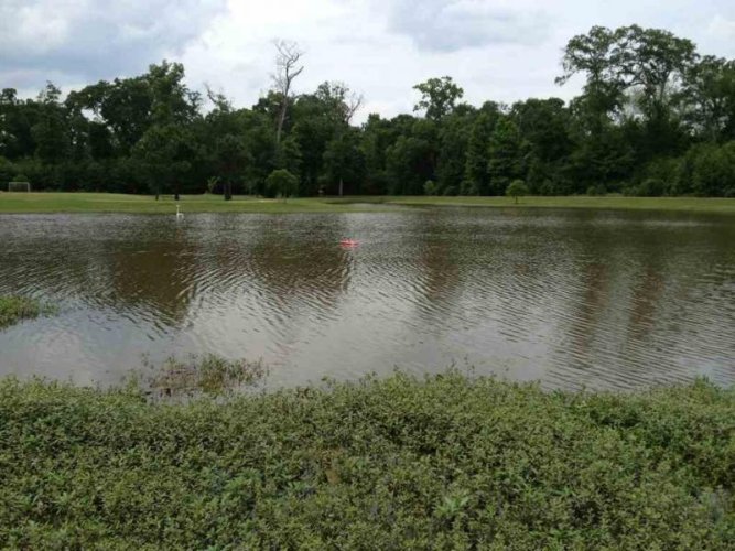

Well the boat didn't fair so good. It stopped in the middle of the pond with smoke pouring out of the canopy. I'm still waiting for the light wind to blow it to shore (hopefully).
I had the same happen to a boat of mine. Lucky the wires from battery to esc melted. The burning stopped then!
So what's the advantage of using skinny tires on the rear of the FOFF rig? It would seem to me the wider the paddle the better the traction on the surface of the water...?
My guess is more rear wheel speed due to the larger diameter which will help keep front of the rig up. Just my 2 cents.

Those wheels look killer."thumbsup" How much do they weigh & what is your new track width?
Can't wait to see new video.:twisted:
Thanks. One wheel (no tire or foam) weighs 2.4 ounces and the new track width is 10.5".

After it blew to shore, I learned that the esc caught fire. The two 3S lipos were / are fine. I think the motor is junk possibly to, it spins freely now, which being a 6 pole motor it never did before. The smell is awful!!
No advantage. It was done to gain the proper weight bias. The front and rear are nearly the same height at rest, and at speed the front is taller than the rear.

The ESC and Motor are toast. The electronics box has some burn holes and warpage from the fire. I haven't tested the RX or Servo yet, but they smell awful and are covered in some sort of residue from the ESC fire.
Thankfully the boat/hull has zero issues. Per your suggestion, the Castle Hydra ICE ESC is already on the list for the rebuild."thumbsup"
After about 20 minutes the wind had blown the boat close to shore where the water is knee high. I started the video wearing rain boots, but by the end of the video I was barefoot. The entire ROC Park pond has thick vegetation along 4 - 6 feet of it's banks. When the FOFFer doesn't make it across, the closest it can paddle to is the vegetation. I still have to go into the water to retrieve it and the boat was no different.
