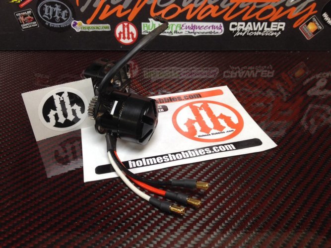

Next up was a new Holmes sensored outrunner is a new smaller size:
The new motor did not last long. Roughly 30 seconds in the yard before it caught fire. Thankfully it did not melt down the delrin chassis. The motor is being sent back to Mr Holmes for inspection. The 30 seconds that it did run were glorious on 3S with plenty of torque and speed from a small motor.

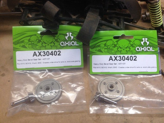

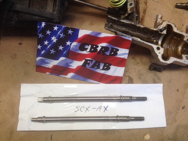

Since the outrunner didn't work out and I had the 412 sitting around, I installed it in this rig. Geared 52/20 on 3S draws a lot of amps, but it is decent for power. Not water cross able, but good for bash fun. It was good enough to explode the rear axle pinion bearings: ImageUploadedByTapatalk1414356285.875406.jpg

That is terrible about the outrunner. I really want to try one of those.
It is, but it's also better that it happened to a Team Driver for Holmes Hobbies like myself. We (team drivers) R&D electronics for Holmes Hobbies and we understand the risks involved. In order to make advancements, testing has to be done. Holmes will get it figured out and we'll have several different versions of outrunners to choose from"thumbsup"
In this case I think it was error from Holmes. It was a proto and I forgot to label it ABC for Eddie. There is a combination where they seem to run great, but amp draws are about double until near full speed and then it pulls like a shorted motor. Seems to drive fine, but they go up in smoke pretty fast. My bad! I'll be sure we get them labeled next time!
That's a great description of how this motor acted John. :oops:

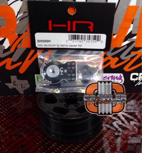

New Aluminum Servo Saver

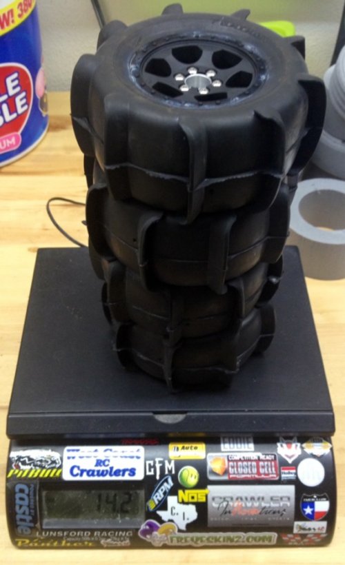

I'm going to test a different size paddle tire.
Proline Sling Shots
1.50" 6 Bolt Wheels
Custom Deuce's Wild Foams
Size comparison to the previous Panther Paddle I ran:
