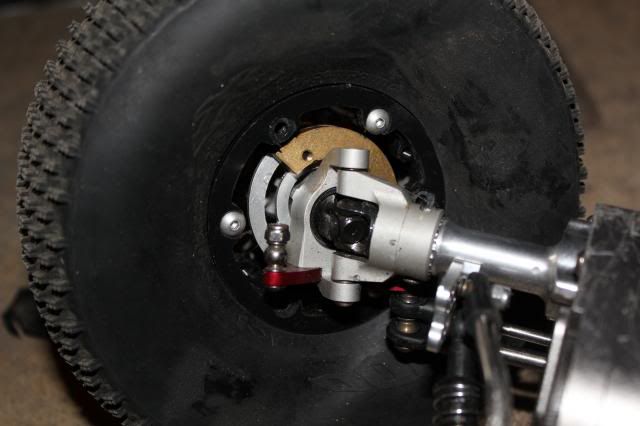

Would you mine posting a pictures to show off that Steering
Thought I did:ror:
anyhow...
This is as far as my tie rod will allow for now. It hits the servo. Needs longer 0 ackerman arm I think.(Edit: Just ordered some from RcBros)

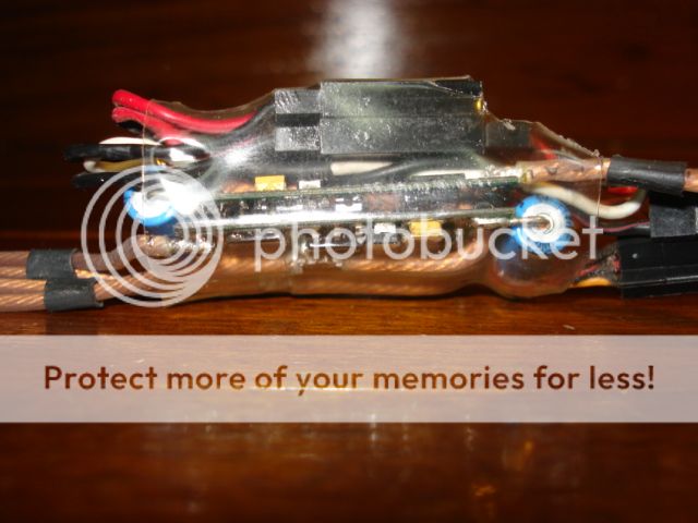

On a roll tonight:ror: Figured I would get back on my bastard child rig. Redone the electronics since it was just thrown in before and had an older sidewinder micro sling a rod.
My first smash job. Don't laugh to much. Two sidewinders, BEC, 18 ga TQRacing wire and a y adapter to straight feed the servo...

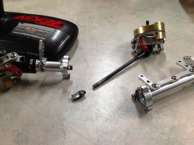

What happen?
srry I jacked ur thread ted....under load in a jam ...truck pushed steering farther then I had it set to on servo and then I gassed it ,the joint was turned to a point of lock up and snap . I need a steering stop to prevent it from pushing past the servos end points.
The point where the weld meets the shaft will always be the weak point, anyone in engineering will know that, the other down fall is the shaft diameter... Ive heard some guys say they are strong cause they are from nitros, The fact they come from a nitro doesn't mean they will be good in a crawler, it's like saying a Ferrari axles are perfect for a truggy.

First off, there are two different types of shafts. The first type is the Bully style shaft I have been making for awhile now. I have been making these for a bit longer and I sell these on my site. These are proven. I have sold many sets including sets for supers and to date, ZERO have broken. The second type is the Axial shafts such as Tedrockz and TheWheelman have. The Axial shafts are based off the Ofna/Bully shaft. Even though I assumed they would be the same, small differences can make big changes.
The metal that Axial is using is pretty much junk. I am getting a lot of porosity and I have to put way, way more heat into the shafts than I want which can cause other issues. The Bully or Ofna shafts are a much better metal and that is why there have been no issues while the Axial needs a slight revision.
I am not selling these shafts as of yet. I dont have them on my site. This is for a reason. Anybody who has PM'd me for a set will tell you, I am being really up front that they are prototypes and even telling people that they may break on the first pack. So, in a case just like this, there should be no surprise that they break. Please dont make me regret offering them up. I wanted to offer the prototypes to people who are in desperate need. The final product is not yet released, when they are, they will be bullet proof.
The shafts that are in the picture are a great example of how the design can change. That was a version 1 and I have been making version 2 for a bit now. Thats how testing goes. BTW, even though there have been some flaws in V1, they are still proving to be a great shaft. I have sold quite a few sets and only had 3 failures out of all of them. On an even brighter note, if one does break, you can send it back to me and I can fix it and upgrade it to the newer version.

the solution seems to simple , thanks for the advice I knew I would get from all you guys!
I spoke to rc bro on making a set of stops, he informed me he uses the arms off an old axial knuckle. cuts off the arms and taps to fit. as I don't have 2 sets of arms for the vp wraith knuckle ,this seems to be what I will try.
any other steering stops out there?
