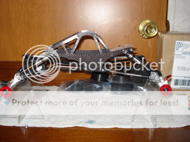

Tedrockzs 2013 Special Agent Berg build

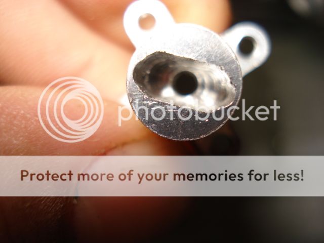

With a set of calibers, a $15 harbor freight vise and a hand drill I did a set last night. Measure 6 times, Drill once and take your time. I started with a 1/16 drill bit for the pre hole and worked my way up. A good tap is a must. A drill press is for sure ideal though!

Harvo was referring to drilling the inner diameter of the tube to fit the Dlux modded inners. It lacked +/- 1/2 a mm to work"thumbsup"

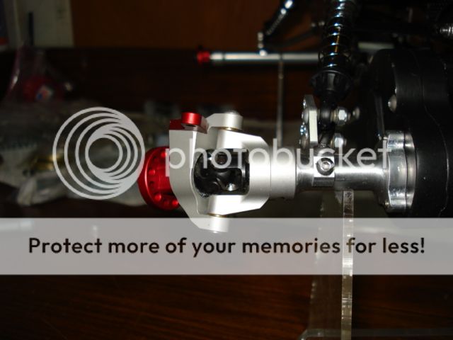

Erik put these in the mail Saturday and I got them in today. Pretty uneventful install. The only thing with the RcBro tubes is you have to back out the link mount and servo mount screws @ 1 turn in order for the tang area to pass by. Not a big deal.

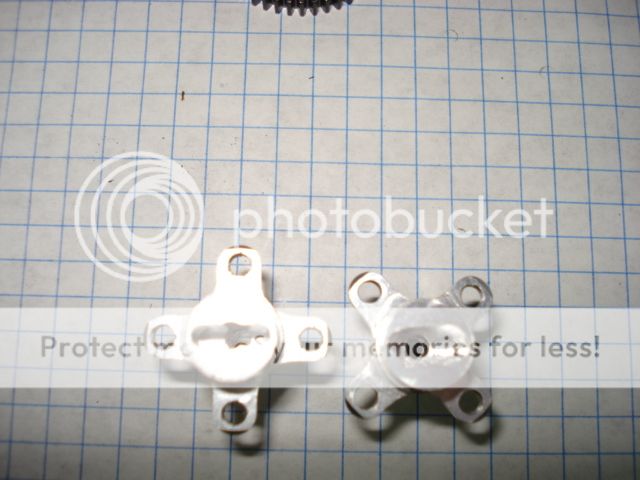

Milled out RcBro locker to make way for the larger tang. Dlux is including these in the set up. He was waiting on some to arrive so I sent him a spare I had to shorten my wait:ror:
Side by side of the RcBro as manufactured compared to the modded one.
Installed along with the Shifts
Everything is smooth and bind free. Now to fashion up some steering linkage...

Did, bolted a motor to the axle and run them straight off a 2 cell for a bit. Gears needed run in too! Had a tight spot in them(gears), was gone in about two minutes. Shafts are smooth"thumbsup"

You didn't have to mod the tube? No drilling out needed?
I used a 9/32" drill bit. If you do it with a hand drill it is grabby as hell and easy to off center. I built a makeshift fixture on my drill press. Shoulda took a pic. Was kinda neat:ror:
