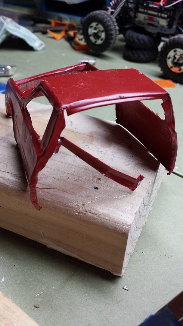

Oops, just realized I didn't snap any pics. Painted basher body, cuz, well,I could. Wanna see how it gets torn up. Shoe gooed tires on, they've just kinda been on there since I tend to work more than play. And pressed first trial floor pan. Started sculpting a posts and rockers, but got distracted playing with my old xmod. Realized how awful a crawler it is, and when my three and a half year old realizes that he will get bored and my bonding project will just be a normal hobby. Guess I have an excuse to tear it apart and rebuild it, or buy him one, or, hell, who knows..

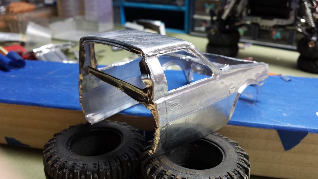

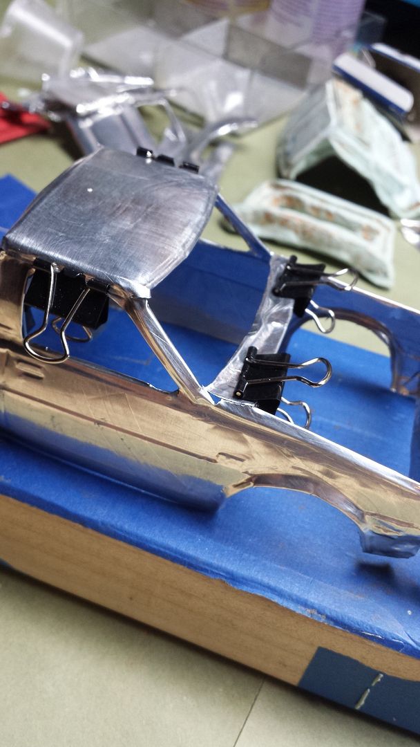

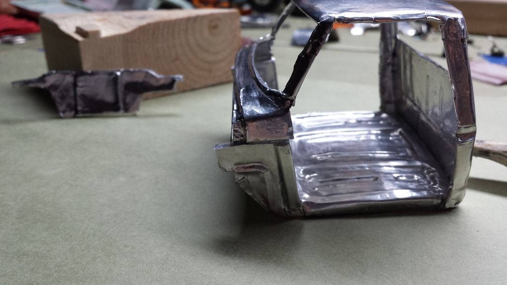

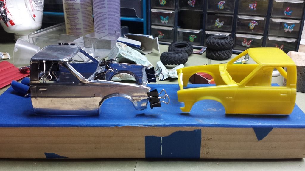

Quick update. I made a mold for the a posts a few days ago, want super happy with the design after I pulled clay and stamped a part. It fit Ok, but I am still not convinced. So I pulled out some brass I set aside for the frame, and made a post by wrapping material on square tube, and pinching the bottom for fit. Basic cab is now glued together, but it's a test bed. Roof fits like crap, no inner structure, but I have all that figured out for the next one.

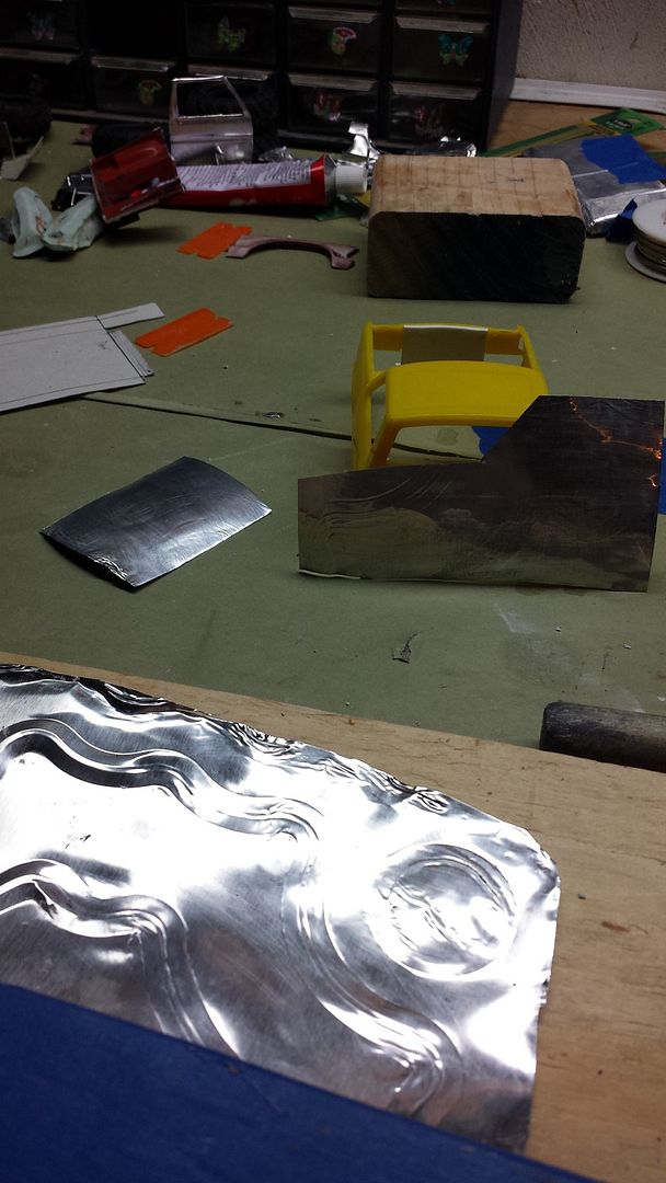

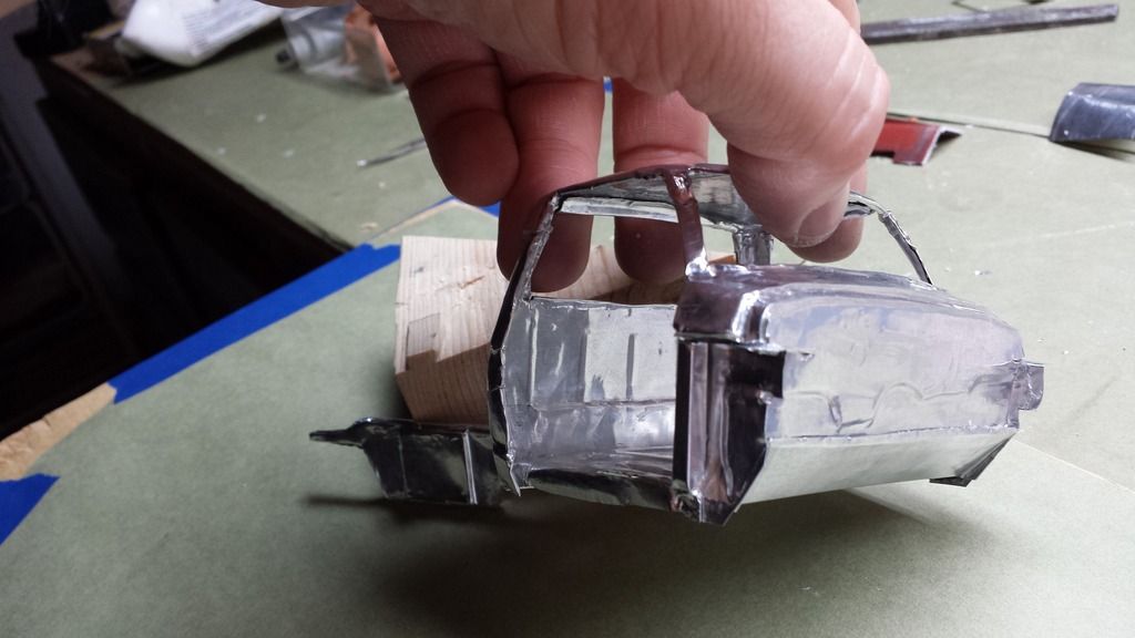

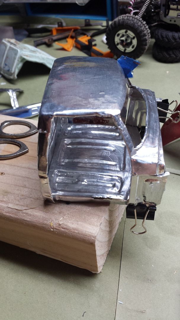

Update. I am learning allot in finishing the cab, like how I don't need to make a mold for each and every part. Case in point, under cowl, firewall, a post area ties the cab together, and I didn't like the look of the panels I molded, so hand making them allows me to make a super strong pinch joint, like a pinch weld in 1:1, but easier at this scale. I've found all the week spots just in handling the cab, but once it's mounted on a chassis it should look pretty real. I have trouble not giving in and building the frame too mount this to, but I still have to do inner fenders, and the entire bed. I made a core support, part of which you can see in the pics. I cut into the fresh metal too, still have baking pans to experiment with, and scraps.

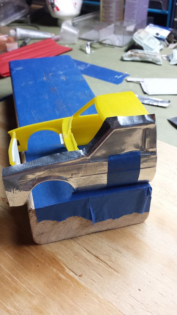

Just had the bad idea to glue together a frame from some thicker aluminum sheet metal I have just to see if it works. This idea includes a wooden form and pressed metal too...Damnit.

Sounds like you just challenged yourself to build a fun little tin pan beater to me!! What's the worst that can happen, you get a few cuts on your fingers, you have fun? You don't even need to start making an entire cab, a couple fenders and a hood like I made for my three year olds truck take plenty of a beating!! I think I need to press a fleet of trucks, this is fun!!:lmao:"thumbsup"
Haha fenders,hood,and bed are actually what I figured would be the best place to start
