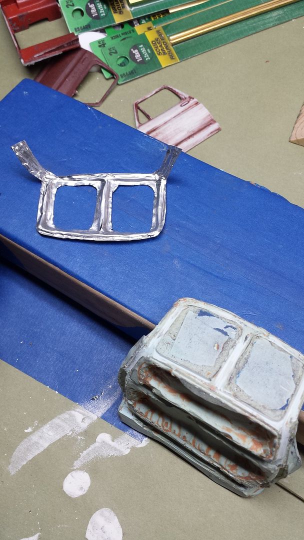

Got my mold for cab structure done, well, the first one anyhow, need to sculpt one for a posts and lower firewall, which will add a ton of strength to the cab.first test part ugly, realized needs to be done in sections, but it will work. Body filler I admit won't last forever, but not intending to make a production line either.

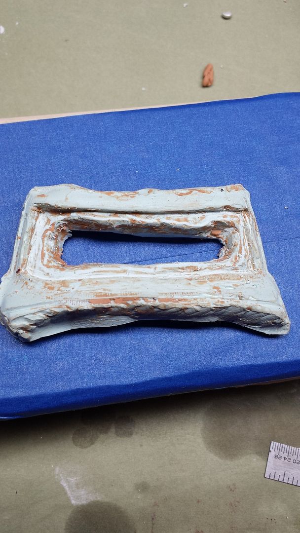

Somehow I just deleted my unposted update. Here we go again. Got some done, as this is Winter project, I'm doing well, but can't wait to crawl! Panels I made already get really strong with inner panels, just like 1:1 counterpart. Negative relief mold worked, but was too deep the way I made it to press metal into, so cast in resin to make positive.
Also sculpted windshield posts and frame, the models roof was broken, and I didn't like how it came out before, so this will sit under roof frame and be the exposed a posts.

Next up, sculpt the floor,a posts, and lower firewall. I really like oil clay method. I have background in styrene, but I like reusable mediums, if I screw up, no big deal to do again, no midnight runs for material!

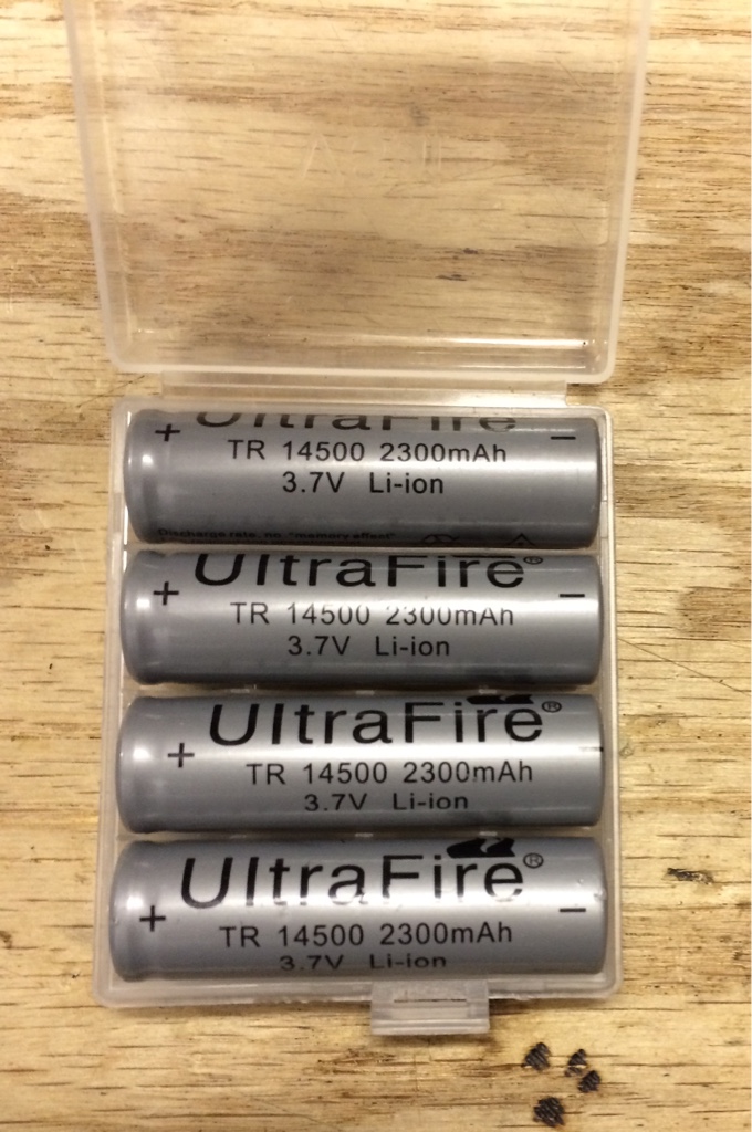

Keeping this question where I can find it. Curious what power options other guys and gals have used in their Sumos? Mah? Successes or failures? Got lost in battery stickies, figured I'd ask all the same.

Are you asking about power from batteries? "Mah" would be capacity. If you are speaking about motors you can take the gear head off the stock motor and install on a Losi motor. I think the stock motor is faster so that's may not be desirable, but you can run a custom wound motor on it.

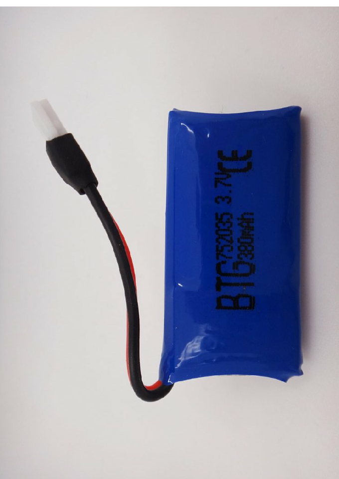

Awesome, I'll try to clarify. I get Mah and running either parallel or in circuit. Honestly it has good power for what I want as is, gears aren't a concern either. I don't want to fry the esc or other components with the batteries I jumped into. They are small, powerful, meant for helis.
I'd also like to know for certain what plug this is, as they fit, but are not correct, and I don't want to clearance them for car and be loose in charger, which I understand is the potential danger in Lipo. Going to re read some posts in battery threads sorry for lack of good progress, head is in five places at once, none long enough to do any good!

As far as the plug, I can't really tell. You'd have to be the judge. I personally like to use micro deans so I change all the plugs to them on all my micro RCs,lipos & chargers. If the polarity is right and it fits securely it should be fine. Each cell has a peak charge of 4.2v and the 3.7v is nominal. The higher discharge won't hurt anything. It just means the battery can discharge more if it was actually needed. 2s lipo won't fry anything on a Losi or Sumo,but I've read on the HSP it can fry things with 2s, I don't have any experience with the HSP or HBX however
