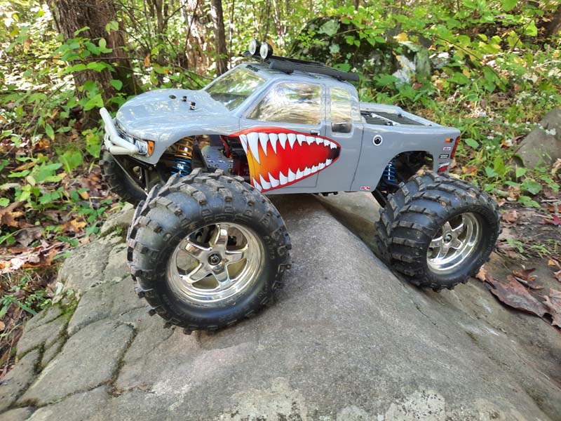

Getting to be leaf time... on the trails, this thing just eats. Everything! Big fat tires, decent clearance, and lots of torque goes a long way.

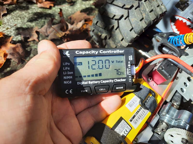

After almost 40 minutes of wheeling, I only used 24% of a 2200MAH 3S pack. Not bad! It's not that heavy, I have TRX4's that weigh much more. Kinda surprised it gets that good "mileage"

Rocks, roots, doesn't matter. The C-maxx eats it up.
