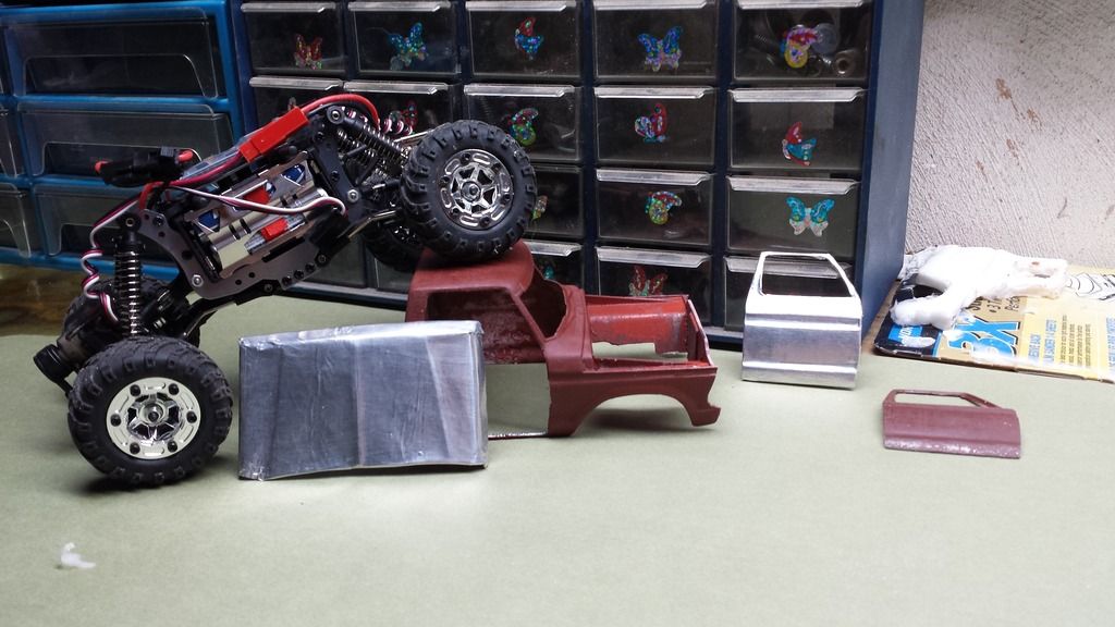

Short update. I cut the body since it was hacked previously, and I figured I could make better parts if I did. Cowl got separated from doghouse, as did the fenders. Windshield post was cracked, so cut them evenly.not the best place, but it will work. The metal is easy to work, if your patience is topped up and you think a few steps ahead.
Fenders probably won't get much better in this scale, detail was lost just a little, May hand stamp marker lamps in more crisp, we will see. I don't have interior from the model, and being of scale mindset,I plan on making a full cab with potential for one. So, I'll be making that up as I go, sue me.

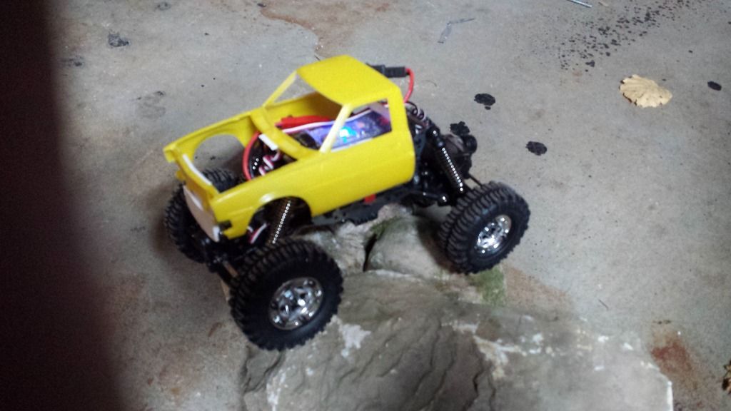

Ok, I just spent a bit of time on the truck. Let me say, building a cab this way is super fun, but super challenging.I am glad I had a beer and a taste of wine, or is never have lost my attention enough to actually PLAY with my little Ford. I grabbed a model cab I cut probably ten years ago or so for my x mods, and used it to protect the Sumo as I played.I am testing for the inside crawler park that's in my mind anyhow. I did make clay molds of the rocks seen, then poured plaster in them to make copies, another proof of concept.
The real thought in this project is in building the rest of the firewall and floor, as it strengthens the entire cab.This is a test, only a test, and will be destroyed.
My little man played hard with his xmod or monster truck as he called it. Hope I can instill done engineering and thinking into this project. He knows it's a icky weather activity, but asked constantly to play with me until I gave in and neglected my other chores.thanks for the random thoughts forum..

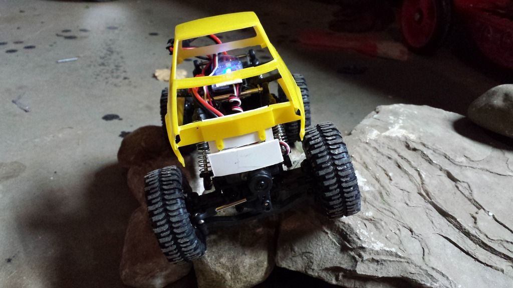

My model was all busted up anyhow, so I pulled it apart. Now of course I see an easier way to do the cowl so I'll probably have to reinforce cab with tape to mold entire windshield apature together, then glue roof skin to that, too hard to keep cab square otherwise. Here are some flex shots, enjoy.
Sent from my SCH-I545 using Tapatalk
Forgot, tossed on the swampers too, crawls awesome, way more scale. Here's a crummy progress shot of the cab, I'm building a brass frame, not a monster, don't worry. Sectioned stand in floor and firewall, taped together for fit proposes.

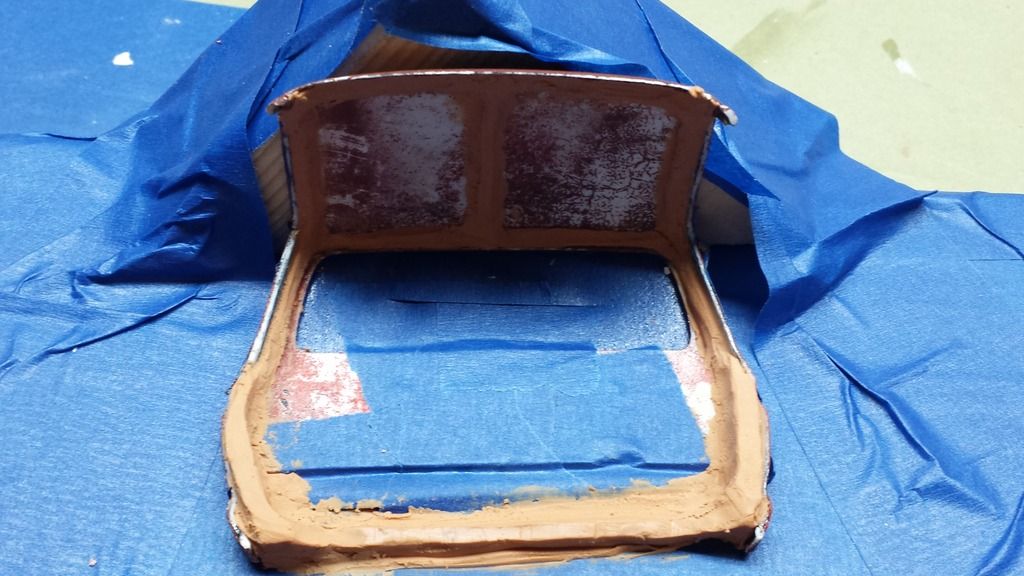

Ok, I was tired last night, and didn't take pics. I am currently laying clay inside model body to mold inner reinforcing panels. After spending more time crawling than working the past few nights, I have realized as soon as I bolt up even my ugly test body I am gonna destroy it rather quick. So, I am making it braced inside, and molding the inners and assembling much the same way as a 1:1 truck panel is, glued, is much stronger and better looking. Also I will have a place to nicely seam the roof skin to the a posts and cab corners, and it wont have to locate the other parts during assembly.

Anyhow, here is the sculpt, pre polyester body filler mold.it should hold up fine to pressing metal, and I have extra going to waste otherwise.letting it set up overnight.

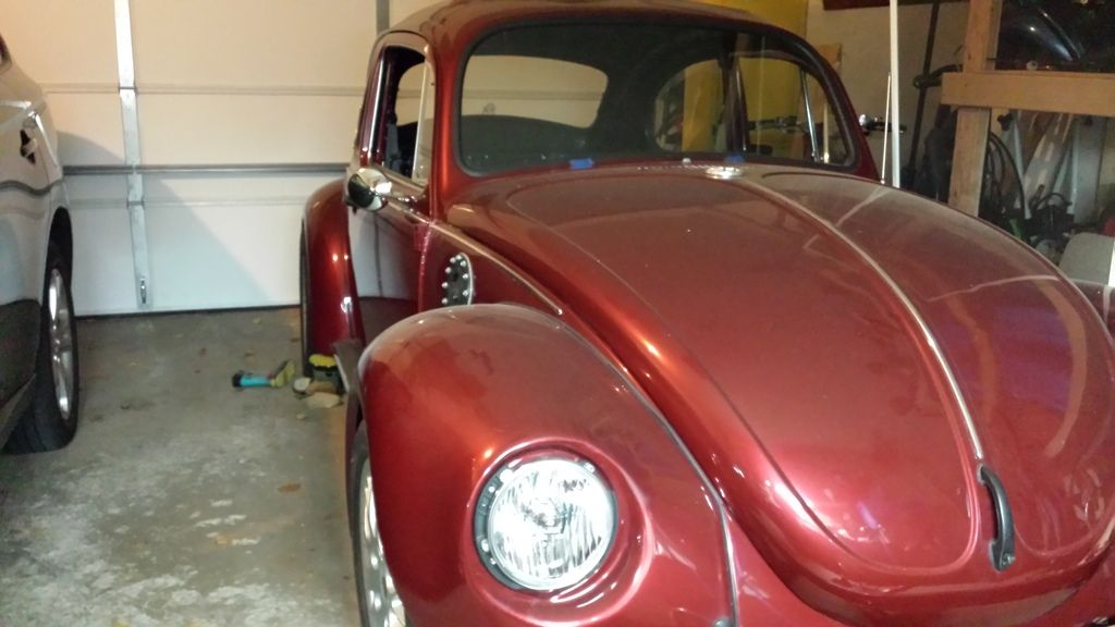

I completely agree on wanting to keep my posts for hobbies, specifically RC private. We're not the only ones that feel that way and a few of the RC groups I visit on FB have private settings. I actually just sent Jim the group admin a message about changing the settings to private so others will be more comfortable joining. We shall see. As far as the late 30s being old, I guess that makes me old haha (37) at least most people assume I'm much younger (for now)
Sweet beetle BTW, I've always wanted one...or two. One that's mostly restored and another that's a wicked volksrod
Preach on brothers! "thumbsup" I'm personally not on FB, and would rather post here. I love this place even if it's a little slow sometimes. By the way, I'm loving the bug! "thumbsup" And the truck! I've thought about doing this with one of the 1/20 Toyota's, but I don't have enough patience or time for anything so involved. I admire you for being able to do this. I can't wait to see it get mangled! "thumbsup"
