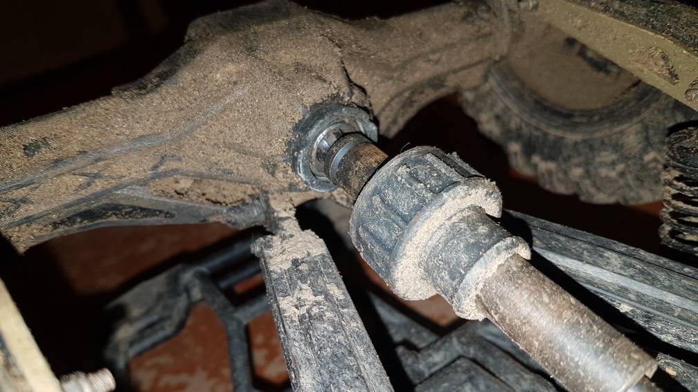

Hi all,
Just an update on the shaft cover I made.
So far it's been bloody amazing!
I went for a long bash session today on damp dirt and after inspecting underneath the bearing is completely clean..
I know it's hard to tell in the photo but it is..
You can see how caked up the axle is so I'm really happy!!
