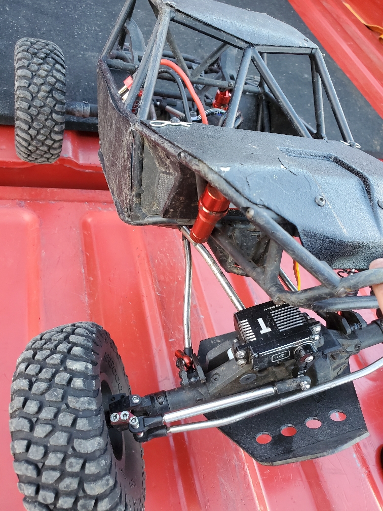

Washed it up and plugged a battery in to dry the tires some
Was having all kinds of glitching, and the Mamba X was giving me a receiver error beep
I opened the receiver box expecting water but it was bone dry
Suspicion lead me to the on/off switch with the broken rubber boot, cut it off and wired the leads together and it works flawlessly again

Lower shock mount came unscrewed from the front axle. Time to look for something decent
