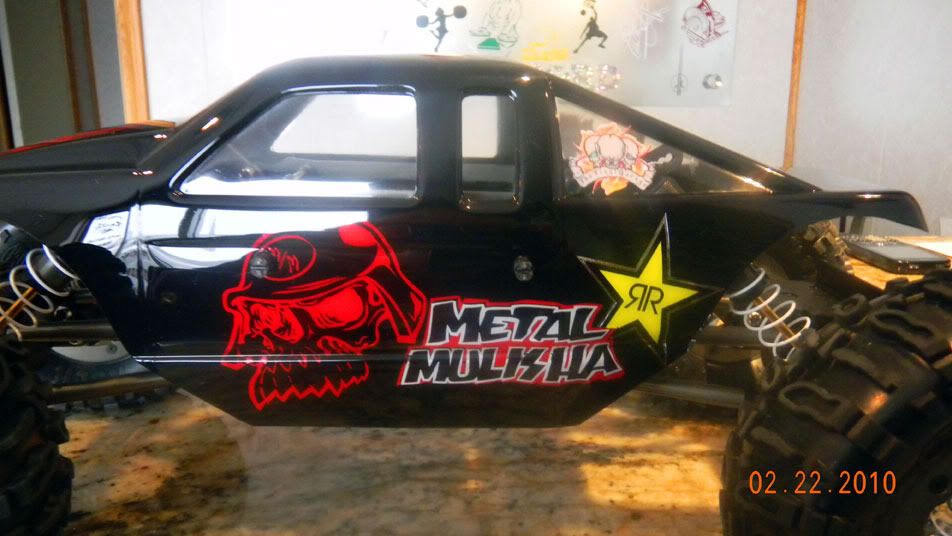

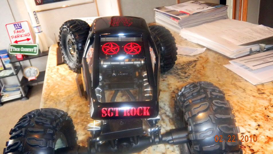

Hey guys I got my crawler & thought I would post pics of it here. Thanks so much for all the help everyone has given me so far!

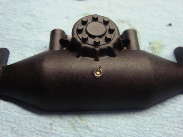

there are a couple guys here that are tapping their losi axels and putting in a grub screw to make for easier greasing. if anyone has done this could you please post some pics as to the best way to do it. in theory it sounds like a good idea
several of us have done that, read through mine or Eeepees thread and youll see a some examples.
(forgot to add pic)
