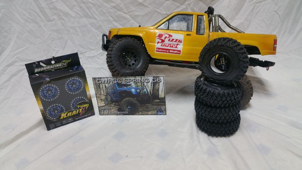

First event is done. Motor performed flawlessly. Drag brake is on par with my tekin pro4, it would still creep on steep inclines, a 2pole 17.5 would not. Im not sure if its a function of a 4pole vs 2pole or the difference in kv. Pictures/more info later when I get home.
Took 1st place.

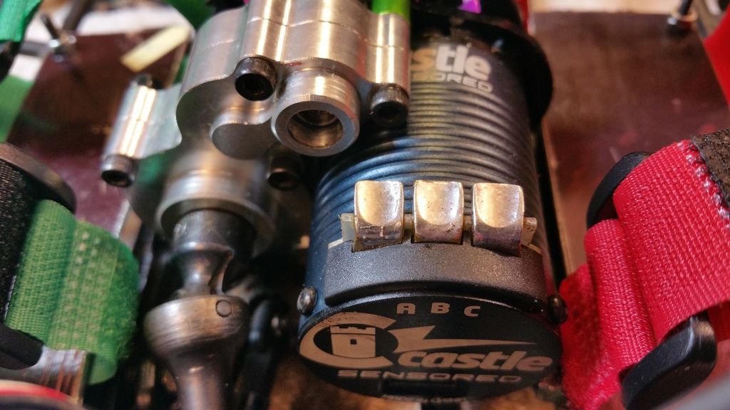

The most important thing. It's a motor, it spins forward, it spins backwards. It works for what it was designed to do. It does it while costing almost 50% less than the competition.
Esc: Micro X v2.02
Batts: 2x 2200mah 3s/ 5200mah 4s
Gearing: 10/56 32p
scx102 axles, old style 3 gear trans.
Motors: 2280kv(ran on 3s) and 1400kv pro4(ran on 4s)
I've never been super picky about motor/power setups so this is a bit general.
Overall power is on par with the pro4, although I haven't found a motor lacking power when run on 3s.
Super low end startup seems to be better than the pro4. It's hard to test without hooking the truck up to a ton of weight. When running with sensors nether motor cogs.
It seems quieter than the pro4.
Drag brake is equal to the pro4.
Sensorless operation is slightly worst than the pro4.
Sensors actually stayed working after running the truck through water. The pro4 motor lost the sensors about 20min after first getting wet.
Ran for ~5hrs on 2x2200mah 3s in parelel. Batteries are at 3.77v/cell. Runtime is a non issue.
Side note: Upgrading to an X series esc would be my priority over a new motor. If you have any BL motor on a different ESC spend the $$$ on an X series before a new motor. I am continually amazed a what the 2.02 software can do, even without running sensors. :shock:
Solder tabs are spoon shaped and have to be 3+mm thick. They can be a bit of a PIA to solder different wires too.
Thats really awesome news whitrzac! Congratulations on the win. Hopefully you'll put the prize items to good use, the new Boom tires look like they may perform well.

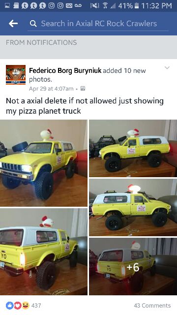

(Off topic a bit) but what the hell, Crazy I saw this from a notification on my phone the same time I read this post. Its a Pizza Planet Hilux but in TF2 form...just thought I'd share.
