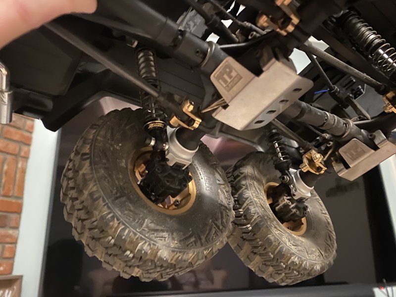

Just a small update:
I installed the aluminum rear c-hubs with adjustable lower shock mounting points. The rear shocks now sit at a more desired angle with more efficient shock travel.
