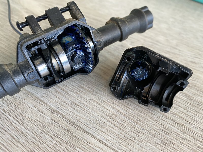

Small update: I was very disappointed with the TREAL intermediate axle housing. It was very poor quality. The matching diff cover it came had so much play that I could not trust it. I went with Yeah Racing’s cast housing instead. I bought a matching Yeah Racing brass diff cover to add some weight to it.
Just like the front axle setup, I attempted to install Hot Racing’s helical ring and pinion but realized I needed an extra pinion to send power to the rear axle housing. I had to put everything on hold and ordered an extra set just for the pinion...
The extra pinion finally arrived in the mail and I had time to wrench on this thing. During installation, I accidentally slipped the Allen screw head that holds the ring gear to the differential. :( Went to a few hardware stores and finally found one that carried a metric screw in the small M2.5 size.

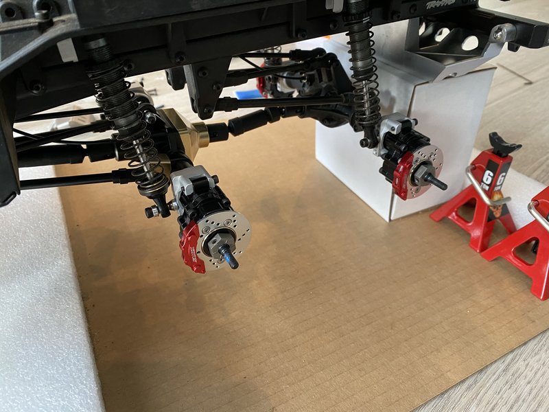

Finally got it all together. Installed the rear Samix brass portal covers with the awesome-looking brake kits to match the fronts. Now to search for an aftermarket rear axle housing for the TRX-6... Anyone know where I could find it for sale by itself without having to buy a full kit?
