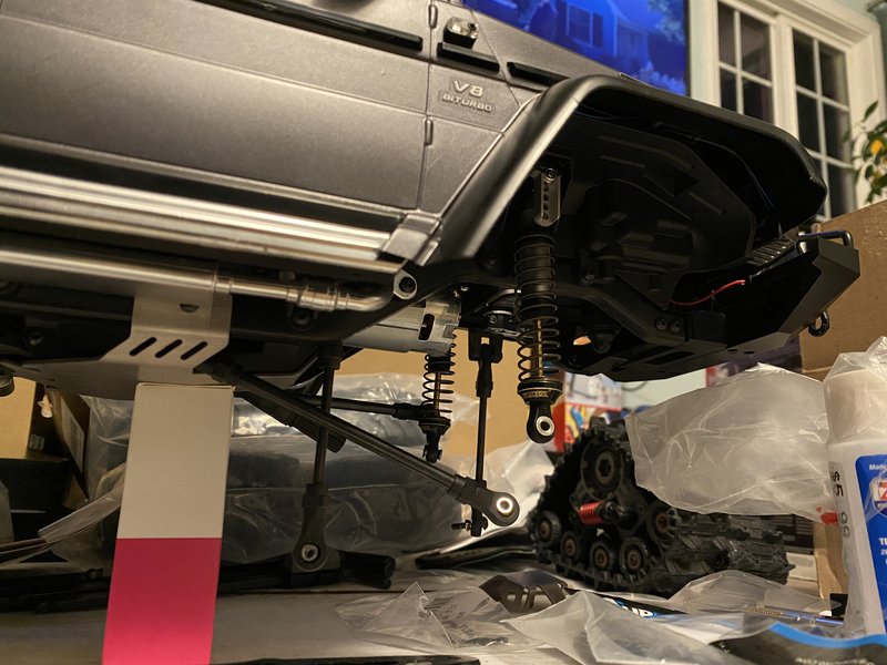

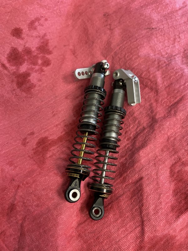

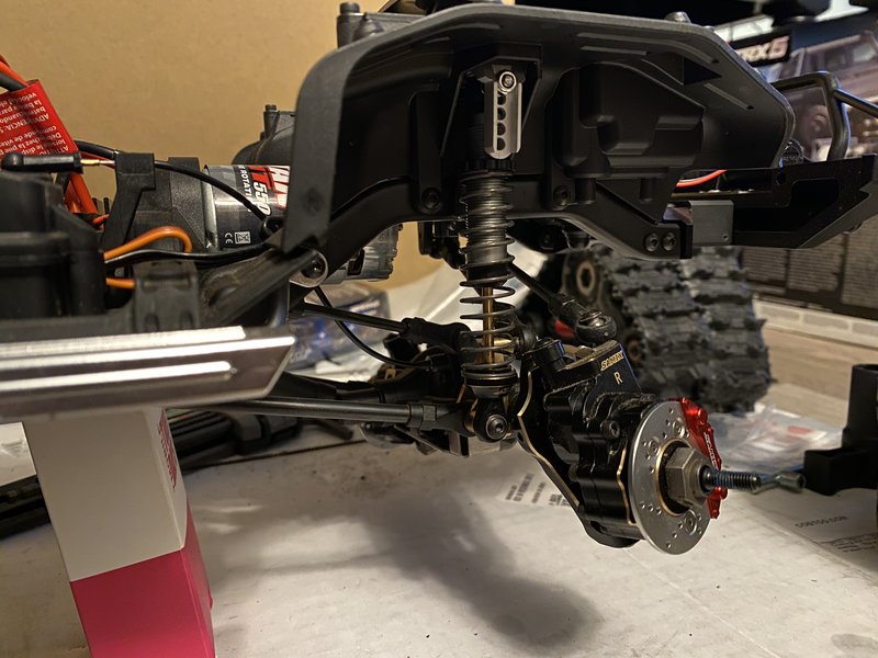

Rebuilt my front shocks with ti-nitride shafts and new seals. When I disassembled the shocks, they were both low on oil. I tried filling the oil with just a new o-ring on the filler cap. When I fully compressed the shocks, I can see the oil slowly seep out. Took the caps off and tried the Teflon tape trick that Jeff6x6 mentioned. No leaks! :) I don’t feel much difference between the ti-nitride shafts and the stock stainless shafts. But they do look a lot cooler!

Usually indicated they are overfilled. A major cause of leaky shocks is simple overfilling. If you fill it to the top with the shock shaft all the way out, when the shock compresses the volume of the shock shaft displaces the oil and it has to go somewhere. Puts a ton of pressure on the seals and will eventually blow out/leak.
Fill the shock about 8/10 full and then slowly compress the shock shaft...when the shaft is fully compressed, the level of oil should just be at the top. Then screw on the cap. That eliminates any internal pressure (actually will create a slight vacuum in the shock body when extended)
Maybe you know all this, IDK but thought it might help. "thumbsup"
Thanks for the tip. That's exactly what I did. I filled the shocks little by little when closing the cap with the shaft at full compression until it reached its limit. Once I put it all together, I fully compressed the shock and held it upside down for about 15 seconds and saw the oil seep out very slowly. So then I took it all apart and wrapped teflon tape around the threads of the cap about 3 times around. Did the same test and no leak. That info was thanks to Jeff6x6.

Benp: I’m glad I have an audience :) I did install the high-flow pistons. They are the red pistons with four channels. I ordered them based on Traxxas’s recommendation on their upgrade for the GTS shocks. However, when I disassembled my GTS shocks, I realized the high-flow pistons were pre-installed from the factory. Now I have a pair of spare ones lol.
Once I installed the rebuilt shocks onto my truck, it did feel smoother. That’s just my subjective opinion though. I also used 27.5wt oil. I don’t know enough about r/c to know the difference between different weight shock oil. This seems to work fine. BUT... after install, I received the Yeah Racing aluminum front axle housing in the mail. So then I took everything apart almost immediately after I put the shocks back on.. lol
You definitely have an audience lol. At a little over 1,000 views in 3 pages - - - I just don't comment a whole lot as I prefer to lurk and watch. Figured there is enough opinion out there haha.
Think about the oil weights. The thicker ...the slower the shaft can travel. On impact to a rock ...you want the suspension to go down and give your rig a chance to get forward momentum before the shock expands back to normal. Difference can be getting up or sitting there with a big wheelie. I run 80wt now. BenP good to hear from you also.

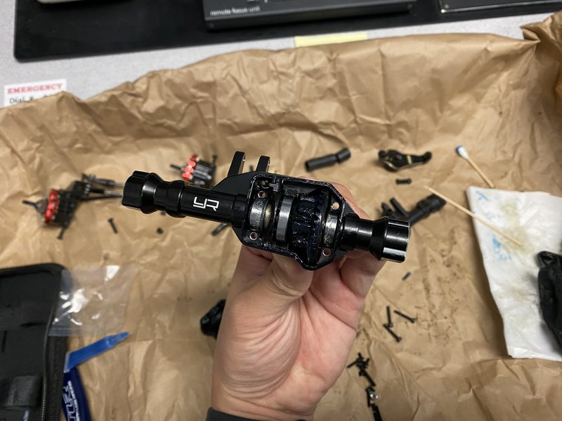

Installed a Hot Racing overdrive 12T/33T helical ring and pinion to the Yeah Racing Aluminum front axle housing. Easier than I thought, but also messier than I thought with all the grease. I used Team Losi great grease for the ring and pinion gears and marine grease for the rest of the components. Everything fit together perfectly with the Samix brass components. Finished it off with a Samix brass differential cover. The setup is heavy!
