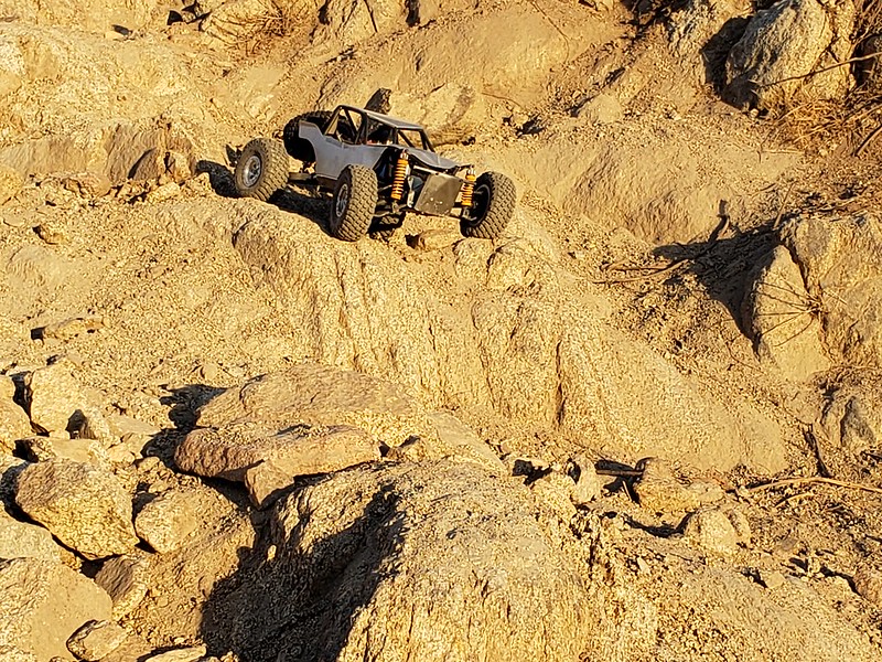

I just couldn't wait for Saturday, so I crawled this afternoon. As far as I can tell, this thing is amazing. Granted, I have nothing to compare it to, but it pretty much goes anywhere and well. Here are a few screen shots from the video I shot to prove it works. Well, I guess that needs to be video. It does need a beefier steering servo. Run time is great, 2 hrs of messing around and it still goes on the first battery.

I put it on the roof 3 times, no so much as a scratch or dent anywhere. .040 body takes a beating. Scotch tape is the duct tape of the RC world!!
I love that rear suspension. How wide is it? It looks wider than stock ar60s.
Sent from my SM-G960W using Tapatalk
13" out to out, so 2" wider than the 11" width Bomber dimension I found. The numbers for w/b and width are close to a Yeti SCORE TT.
