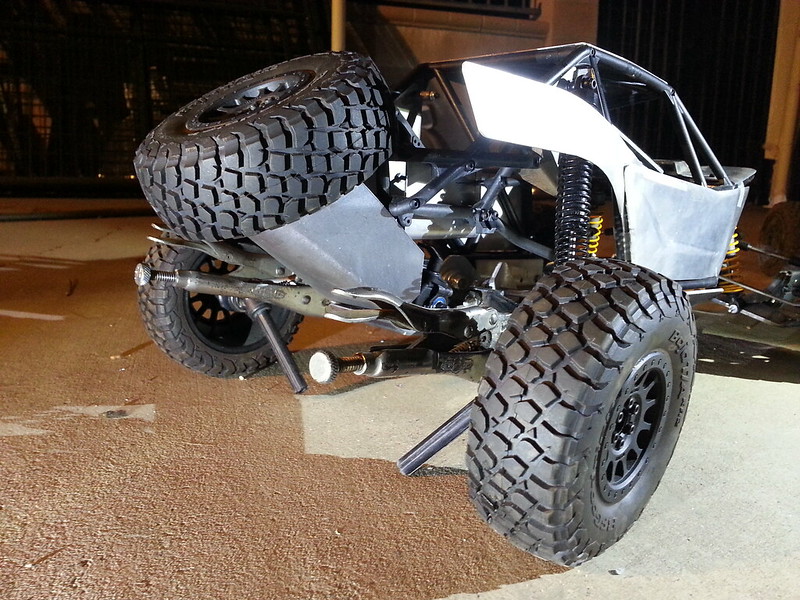

Wish I could say the same about the front. Got the front driveline in, front wheels turning happily. I get 45 degrees either way in steering, but the stinking bell ranks hit the center shaft at full lock. Soooooo annoying. I like the larger shafts because of the 6mm input/outputs on the diffs, no replacing worn parts because they're huge. Slash 4x up front....???
Pics? I think I know what you mean but I'm not sure. What Bellcranks are you using?
Sent from my A0001 using Tapatalk
Modified Slash 2wd bell cranks, simply because I have some lying around. I think I now have it working, I just need to raise the bell cranks about 1/8" more, then I will lose the bump steer I now have at full droop and also clear the front drive shaft. Steering servo should tuck nicely into the drivers side of the cage, leaving plenty of room for everything else. Probably going to spool my extra 2wd Slash tranny so I can be test driving it before too long. I'll post a couple pics tomorrow so you can see. Then I need to figure out how I'm going to align the thing. Guess I should square the chassis up then align the cage afterwards. Ideas anyone?
That driveshaft doesn't look centered :p, and to increase clearance maybe instead of using plastic driveshafts you could find some smaller sized steel dog bones? technically those Bellcranks are upside down, though they probably wouldn't work properly right side up. You should also make a top plate to stop the screws from bending
Good eye and correct. Bell cranks will be double shear with a gusset leg to somewhere, I'm still working the geometry. Driveshaft is offset, have no choice there. All the metal axles available are huge on the flange, whopping 6mm output shaft. I could make dog bones I suppose, hadn't thought about that. With the bell crank upside down AND backwards, it eliminated the Ackermann altogether. Sadly, I can't run it that way and have it work. I have another idea for the spreader where the rod ends at the bell cranks are vertical instead of flat. Tie rods connect where they may, speaking of elevation, (upside down bell cranks with a lift kit) I really don't want bump steer. Just another day in the scratch build life.........
