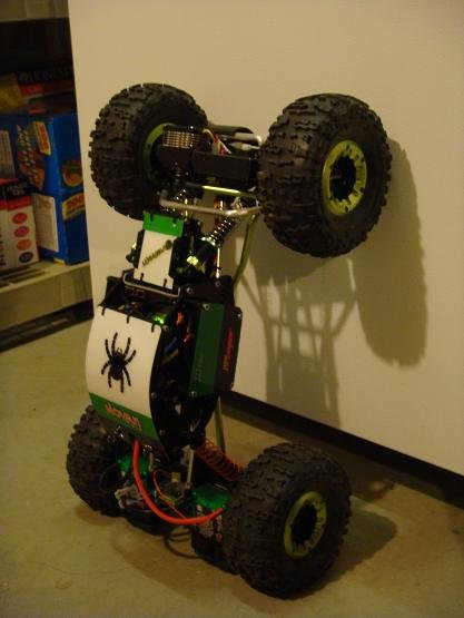

i've been playing with the weight distribution myself. i've found 5.25oz in each front wheel is working pretty good. for the rear i have a saddle pack battery that adds about 9oz total to the rear axle. so, i'm pretty balanced right now and it feels stable. i was able to crawl up a 60 degree slant. when i put a small lipo on the front axle (no saddle in the back) i get a more forward weight bias and can get up to 65 degrees. i happy with the way it is running right now. i need more time on the rocks to check things out. that and a new 4VP chassis! :)

hey jebster how do u build one of those degree testing boerds that u have in the picture
i had a 2x4 sheet of 3/4" plywood laying around. i also had some 18"x18" carpet squares (the kind they use in office buildings). so, i just stapled the carpet squares onto the plywood. went to the local hardware store and picked up the angle gauge (about $10). it has a magnetic base so i put a small metal angle bracket on the wood. took all of 15 minutes to put it together but i did have most of the stuff already.

got a few things in the mail today. decided to put an flm locker in the rear axle (still using lockable diff on the front axle), put in a new large inner hub bearing to replace the blown one and best of all a hitec 7950. that servo is awesome!!! its pouring rain outside right now so i just ran it around the basement. hard to believe how quick the servo responds and the power it has. i held a front wheel on the ground with my foot and the servo was able to slide the rest of the rig around.

i'm just curious. mine is currently at 6lb 9oz. i'm betting that is pretty heavy. i have the large saddle pack on the rear axle (~9oz), the front diff lock servo, 5.25oz in each front wheel, dig, etc.
Mine weighs 6lb 2oz , with 2 2s lipos, 4WS, 12 oz comes from my chassis alone.
looks like i need to put mine on a diet! i've been keeping an eye on your build thread (nice rig) and if yours is lighter than mine given your chassis i need to think about trimming things down. eliminating the front diff lock setup would drop some. i also have extra weight from a wantAsummit 2-3 position adaptor and a servo stretcher.
