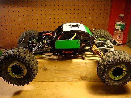

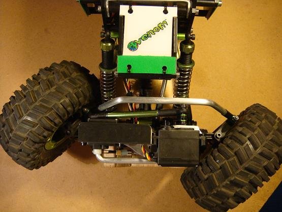

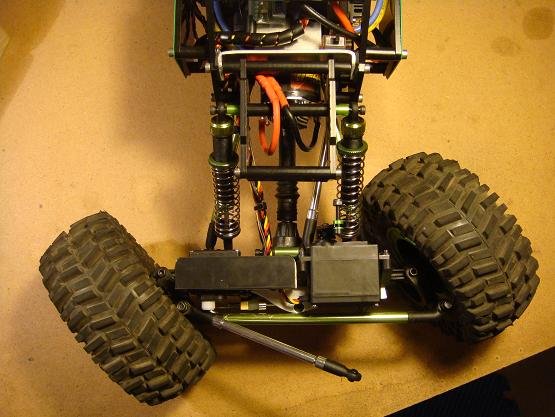

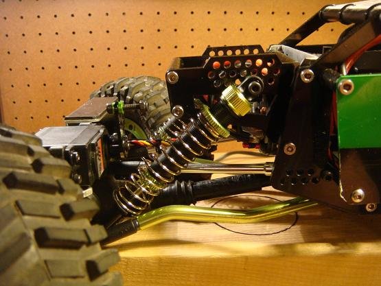

so, got my new 4VP short nose plates (thanks adam! "thumbsup") in the mail today and a length of derlin rod. install the plates and narrow the front to pull the shocks in close so i can increase my steering angle. all moving well with no binding and plenty of articulation. still playing around with the steering setup, which seems to be my latest challenge.
i also got a module (little board with blue pots in the pic below) that allows my tq2.4 4ch to get true three position function out of the 3 position switch. now i can use all three dig settings (4x4, free, dig).
a few pics of my rig on the workbench:

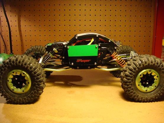

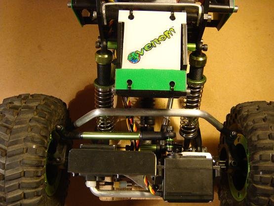

i decided my xr-10'ish BTA concept needs a lot of work before it is a reality. materials and fabrication tools/skills are slowing me down so in the mean time i went with an up-and-over BTA link like everyone else. works fine except i need a longer servo arm to take full advantage of the available steering angle.
at this point i need to invest more money in wheels/tires and a stronger servo w/ BEC. until that time i want to beat the crap out of this on the rocks and see what it is really capable of. it's been a workbench baby most of this time so i need to push it. it also gives me an excuse to put together a course in the back yard!
