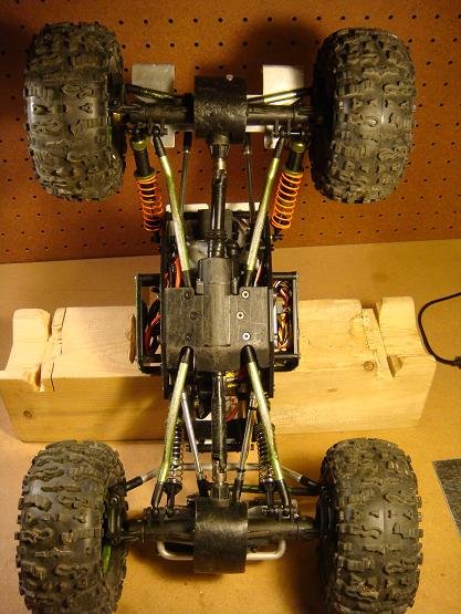

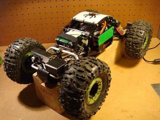

got my links bent and added plastic pipe skids under the axles. my creeper is handling breakovers better and with the skids it's getting snagged on sharp edges less. got some rovers in the mail so i'm looking forward to the increased traction. had some pics but deleted them accidentally. have to get some more next time out.

i did get a couple pics from the workbench.
