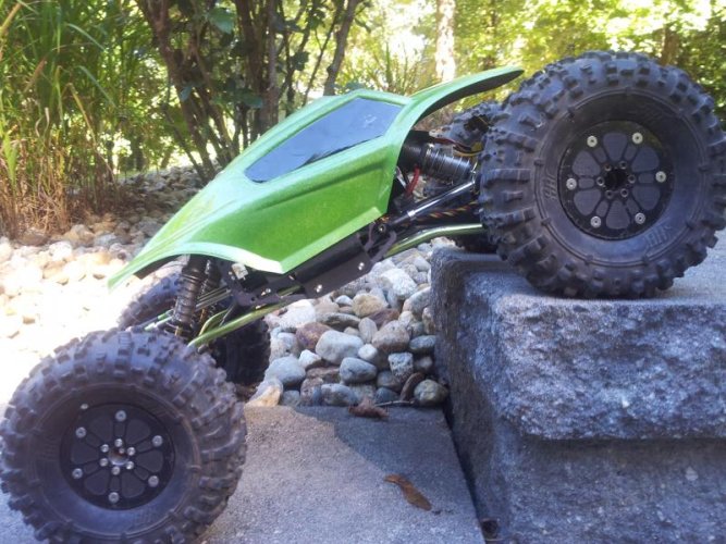

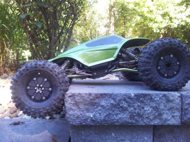

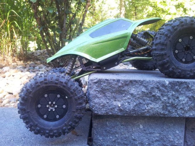

thanks. i had been thinking about something like this for awhile but until i torn down the rig it was tough to assess whether or not it was possible. i hope to get it on my practice course in the back yard this week to try it out.
Got the creeper outside on my steps and retaining wall to test it out. I'm pretty happy. In the past the tranny would catch and I would have to use speed and a bounce to get up. With the flat skid it slides right up and over with a little blip of the throttle.
I will try to upload a video later but here are a couple pics to show what I'm talking about.

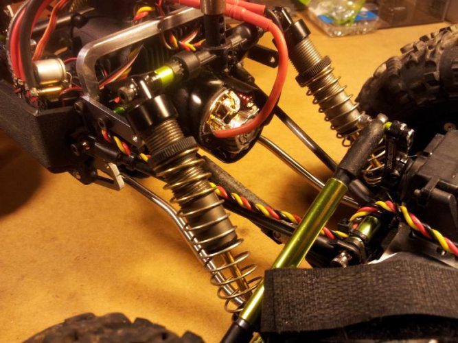

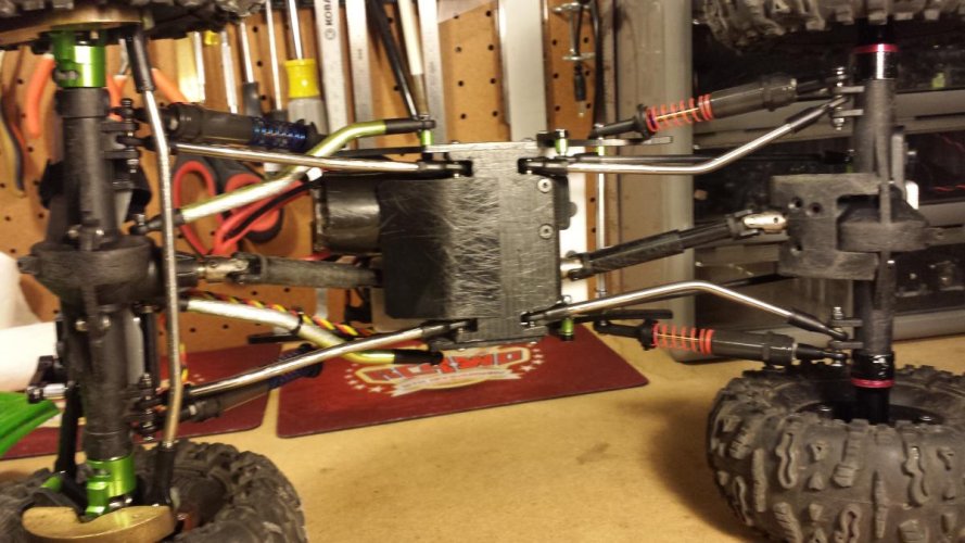

Some guys in my local club were making carbon fiber rod upper links for their pro rigs. I decided why not do it for my shafty. I don't worry too much about my rig weight but the difference between what I was running and the carbon fiber is impressive. A few pics below.
So, got the rig out on the rocks this afternoon and had mixed results. The new flat skid let me get over some ledges I couldn't in the past. But the motor placement and changes in link geometry seems to have increased the torque twist. Makes steep verticals more difficult than before. My rear lowers are binding a little and the shocks need tuning (stiffen the front and soften the rear) so hopefully I can tune the torque twist out.

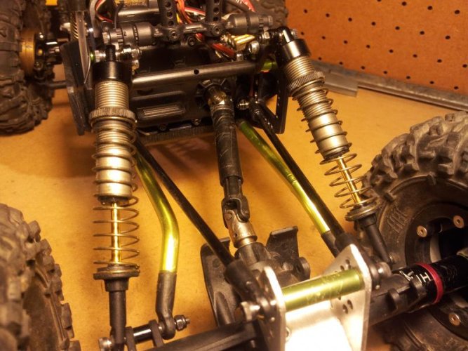

Decided to get some titanium links and bent up new lowers. Worked out nice. Strong and light with he beef of traxxas rod ends all around.
Notice he front of the skid was catching more than I like so I double sided taped a thin strip of derlin to make a little bit of a smoother transition.
After all he changes I ran he rig in a hammers style race on Saturday. It was brutal! Half mile long course along the cost over very rugged terrain. The rig was tossed, dropped and bound up a ton but it survived without and breakage (did loss he tranny plug cover). Out of the 10 rigs in the field only 3 made it back under their own power with the creeper taking second.
So far I'm liking most of the new setup. Still has more torque twist than in the past so I need more tweaks.
