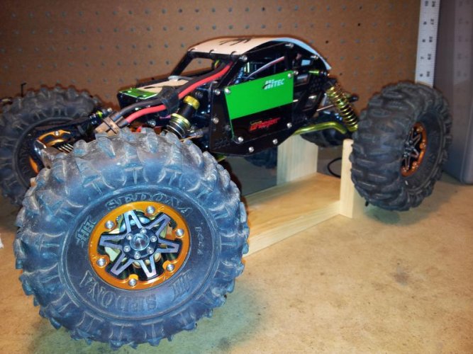

Got some upgrades. First up was creeperbob straight titanium rear axles. Awesome! No more slop or wiggle. Next up was VP wheels. I added some new wheels to my xr10 which freed these bad boys up for the creeper. I will be switching the sedonas over to rovers but you get the idea.

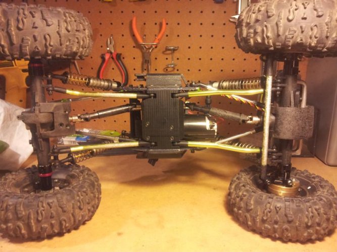

It's been awhile. Decided to swap the slw wheels for some custom made lightweight rims. The only issue was the offset wasn't working out so I had to make some spacers. Just used a hole saw bit and a slab of delrin. It worked out good.
Weather sucks so it may be awhile before I get it out for some testing. In the mean time here are a couple pics.

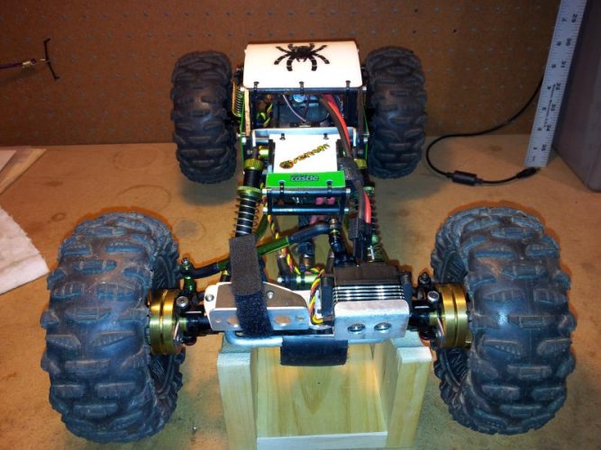

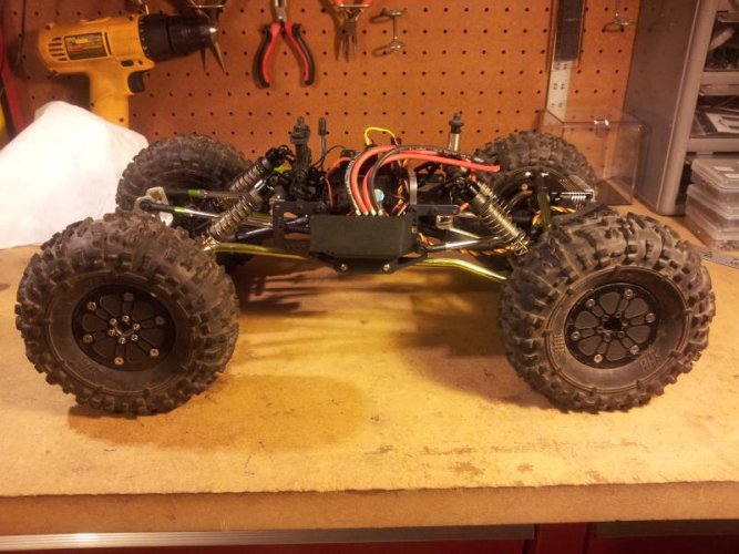

The local club is running the bodied 2.2s class so I needed to change things up. Decided to completely remove the existing chassis out and went back to the basics, ie the original creeper chassis plates. I kept the links and axles all the same but used xr10 shock mounts to lower the upper shock mounting points. Lowered the entire rig down for a lower cg. I took it for a test run and I really like the way it rides.
I have an xr10 hardline body on the way to give it a nice sleek look.
Can't wait to get it out for a comp. Now for a few pics.

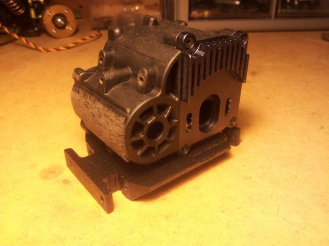

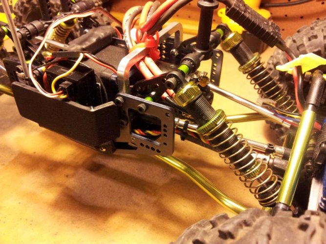

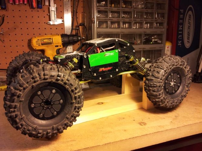

Been awhile. So, earned a ticket to nationals in Prescott AZ so me and the creeper went on a trip. First major comp I've ever been to. Did OK in my book (54 of 75 in 2.2s) and I was really happy with the rig. I do believe I was running the only creeper in the field.

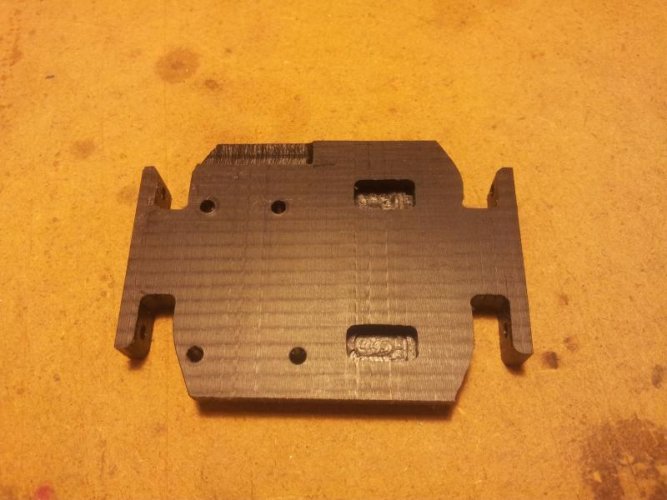

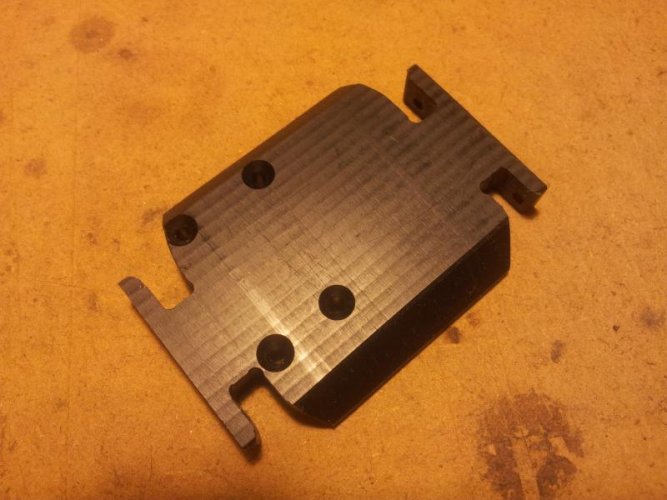

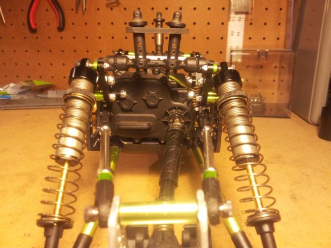

The nationals highlighted to issues with my creeper: 1) I need more steering and 2) the skid is a major hang point. I decided to work on 2 first. I figured that I could lay the tranny on the side. It would keep he driveshafts low and drop the motor down for better cog. Out came a slab of derlin and I started milling. Got it finished up and I'm pretty happy with it. Need to get it out on he rocks to see how it performs but I'm confident it will be an improvement.
Here is a bunch of pics.
