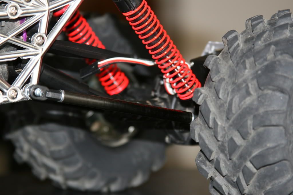

I went a little different route and used carbon fiber hunting arrows. They are way stronger and look better. The inserts that come with the arrows are tapped at 8-32, so you just have to drill out the hyme joints/rod ends. Then cut arrows to length. I used the same thing for my steering, but haven't finished it just yet here's a pic of the front.
those arrows tend to splinter when you bash them on rocks.
and the glass can really hurts your fingers.
i found a little super glue arond the ends help but they still crack after awhile.
