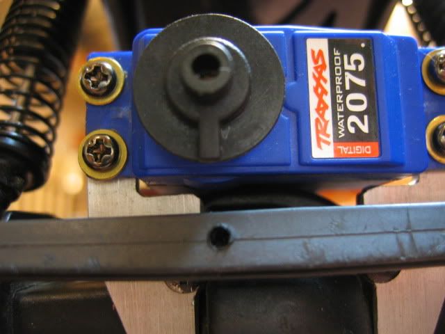

1st things first: The steering, it doesn't. Servo On axle (SOA) works well and was a no-brainer. The trick is mounting the servo. A quick trial shows the HPI servo was gutless-- I settled on a used Traxxas 2075 I had in the parts bin. It's waterproof (always a nice feature) and it has relatively high torque (around 100 Oz).
This was the hardest thing to do.
Thanks to HndsWthtShdws for posting the template!

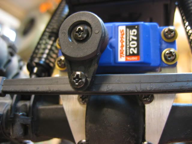

I re-used the stock HPI servo saver because the 2075 has plastic gears. I shaved off the stub on the backside & then drilled it out to the size of one of the HPI pivot screws that I had removed elsewhere. This allowed it to pivot freely on the shaft of the screw.

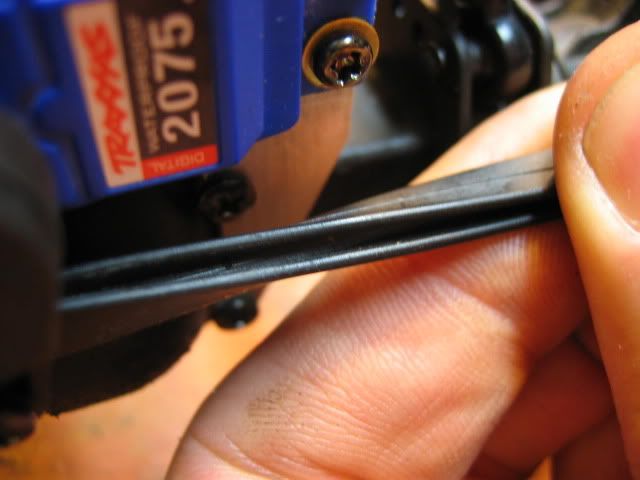

Drilled a hole in the stock tie rod. I used the servo saver as a guide. I know it's a bit hack, but the tie rod is SUPER flexible, so it easily allows for any up & down movement of the pivot point. The steering now works 400% better then the stock 'system'.

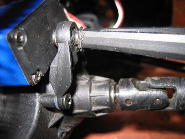

NOTE-- in order to mount the servo here-- I had to move the upper control arm mount back. I did this by flipping the axle bracket. I shimmed it off the axle a hair with nylon washers. All this required that I cut about 3/8" off the end of the control 'wishbone' and then drilled the hole deeper. A washer was put on the outside to prevent the ball joint from pulling through.

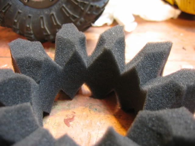

Lasty was the tires. They were hard as a rock! My Chisels (I bought hem used, so I am not sure what foam is in them) flex like mad and have a bit of sidewall bulge even when the rig is not moving. These tirese looked like they had 35PSI in them & rode that way too! I was surprised to find that the rims were already vented. So what could be the problem? I took one apart and found that the foam was very stiff. OHHHH-- this is why folks cut thir foams! I went alittle easier than this on the first, and it wasn't flexable enough-- so I got more agressive with the rest. This is the last foam I cut.
OEM
half way done
done & they flex great!

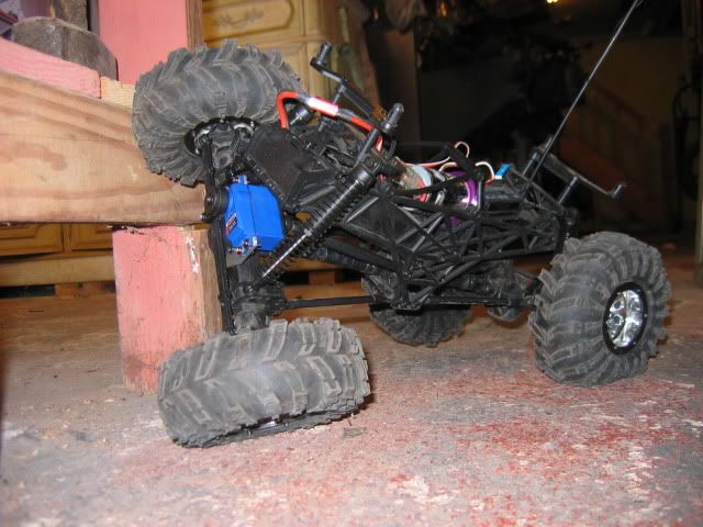

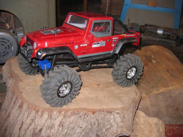

I have to say the OEM shocks/springs are set up pretty well. This thing flexes great & is surprisingly stable! I drove it into place here and drove out of it. Note the reat tire compression... that's the way I like it. 8)
Detail shot of the servo clearance in above shot.
