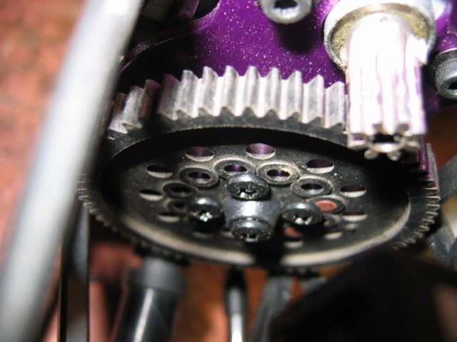

I change spur gear and pinion for 96t and 15t impossible adjust pinion on spur gear because the motor stop on the top of transmission.you have a solution for me.Now run with 96t and 21t for me it's too fast.
You need a larger spur gear
The gearing was next--
THe OEM setup was a 90/21 tooth count with 48 pitch gears. That comes out to a 4.285 : 1 gear ratio. The parts bin had a Traxxas 66 tooth 32 pitch spur gear that I had to drill (using the OEM spur as a guide) to fit the hub. The parts bin also had a 8 tooth 32 pitch pinion. The 66/8 combo gives us a 8.25 : 1 gear ratio -- NICE! No more motor stall and MUCH more control in climbing-- woohoo! "thumbsup"
