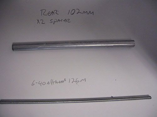

whats the length?
I was looking at it cuz I'm building one but I got confused with the length of the arms, like the pic is to small for me to read and I can't figure ot the length of the all threads of the front and back, plus the Y- thing, (can't remember) really glad for the help."thumbsup"
Here you are
I am still waiting on stage 2 and 3
Build the shafts by cutting the aluminum tubing and allthread to the lengths shown in the photos.
Make two of these for the front
And two of these for the rear.
Next, we'll be lengthening the top link with another allthread/aluminum tube assembly. For this application, use the 4-40 allthread. Cut the front to 28mm and the rear to 37mm.

What is the length of the top links?
Or what is a good starting point?
Thanks
I found what I was looking for....
how does the link go?
I have a wk and it's freakin sweet but looking at the pictures to convert how do you cut the suspension link then put it back on with a new suspension arm? I'm really confused!! please help

The other option is buying some 4-40 all thread from a hardware store and cutting it to length.
