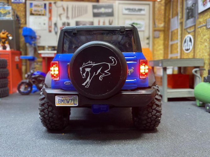

I tried to capture the brake, tail and reverse lights in the following pic, but it is hard to tell.
- First pic is with headlights and running lights on.
- Second pic is with brake lights on. (Brake lights are always on when rig is not moving)
- Third pic is reverse lights when triggered to go in reverse.
- Fourth pic is rear running lights when rig is going forward.
