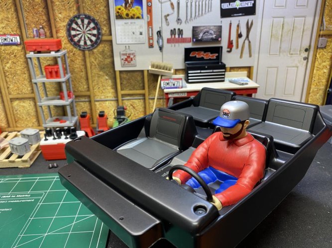

So today I'm working on getting the interior finished up so that I can get it installed. The weather here has warmed up enough to shot some paint. I added Tamiya PS#55 Flat Clear to the top of the interior to take the shine off of it. It also gave me a good layer to paint some clothes on my naked driver! After I painted the driver, I applied another coat of clear to help protect the paint. I only had some cheap Walmart matte acrylic paint on hand, so it will have to do. The clear should protect it from the elements.

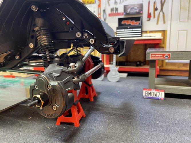

Added some Samix 8mm hexes. I wanted to widen the stance a little more than the stock width. Also, stole the Vitavon brass portal covers from my Capra since it has been sitting idle since I built it. Before I installed them on my Capra, I coated the portal covers with Brass Black to cover up the shiny brass look.

Looks absolutely fabulous. That driver looks like he's wearing a batter's helmet though haha.
Thanks man!"thumbsup" Batter's helmet!:lmao: Yeah, it sure does look like it and now I can't unsee it!:lmao:
I could draw on some stitch lines, but I don't think it's going to help the looks of it!

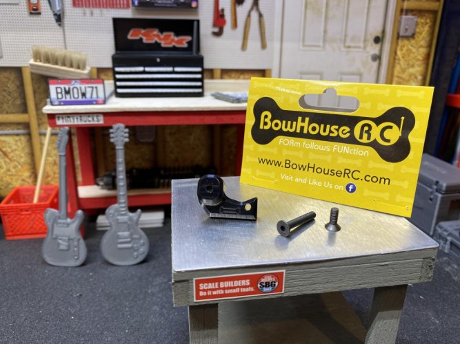

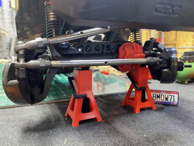

I got a couple more little upgrades done this morning. I added the Samix brass shock spring cups and the Bowhouse SVT panhard reinforcement bracket.
I run the Samix brass shock spring cups on most of my rigs and I really like them. They hold the spring tight, add a little weight down low and since they slide over the shock shaft, there is no fear in having one pop off out on the trail.
The Bowhouse SVT panhard bracket is a great add-on to help support the plastic panhard mount on the axle. It is made of aluminum and wraps around the axle bracing and is held on with two screws. I also have this on my 10.3 JLU and it really stiffens up the axle mount so that there is no worry of breaking the mount off of the axle.
