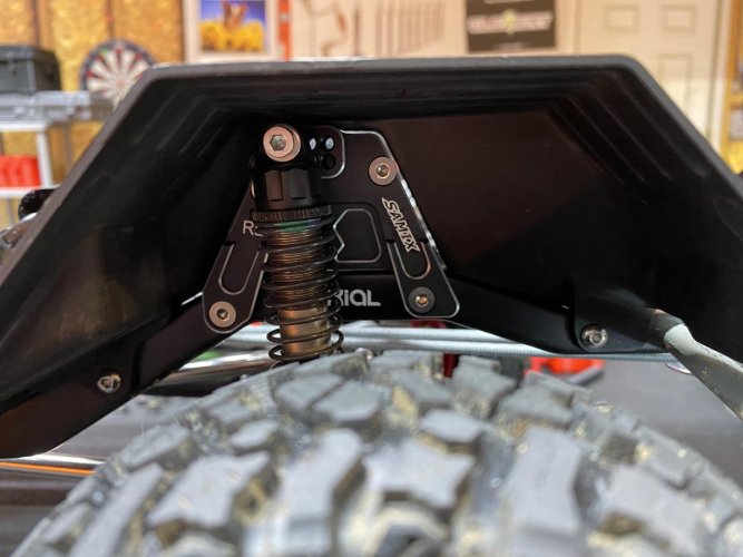

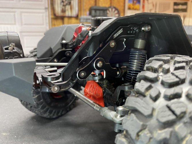

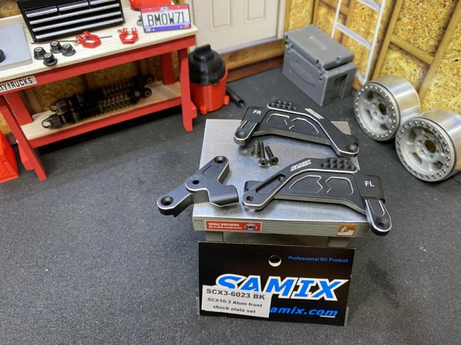

Picked up the Samix alum shock towers for the front and rear. These shock towers are super beefy and have an indestructible panhard mount. I run the Samix shock towers on all of my rigs and have had zero problems with any of them.

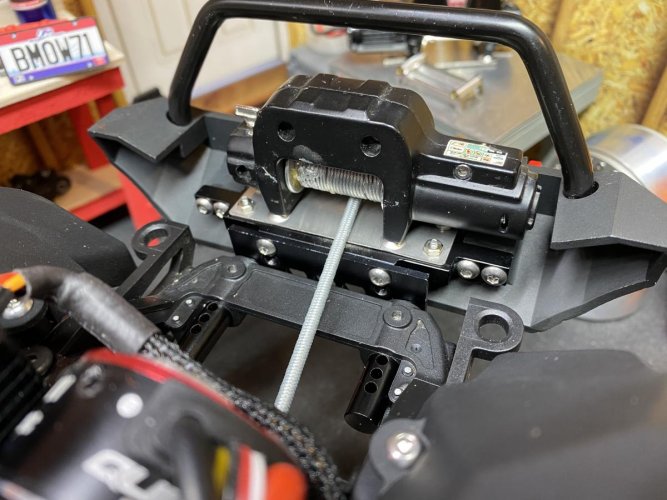

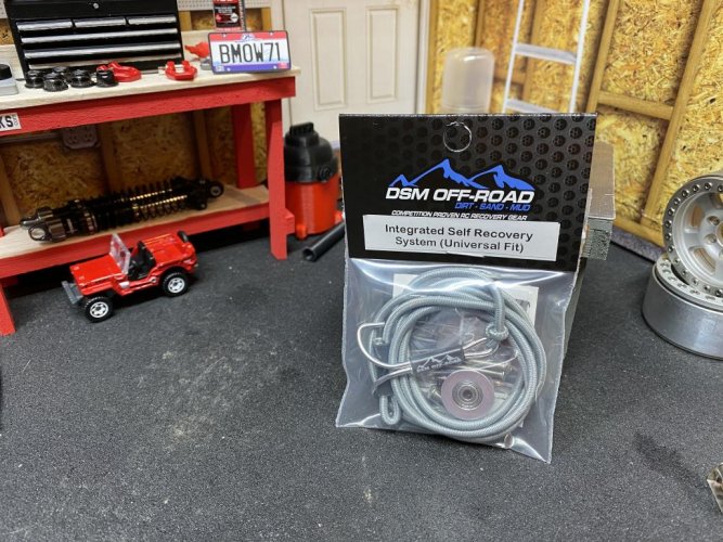

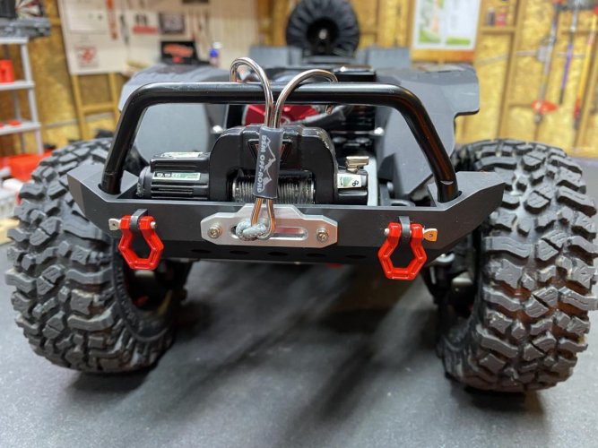

I've been debating on whether or not to add a servo winch or just add the DSM Integrated Self Recovery System. Since I have decided to use bumper #2 with the RC4WD winch attached to the bumper, I decided to go with the DSM system. I have this system on one of my other rigs and it works very well for how simple of a design it is.
I taped out one of the holes in the rear bumper mount studs to attach the DSM spool onto. The instruction say to mount it to the underside of the rear bumper mount, but I didn't like that it was out in the open and may get scraped or smashed on a rock when descending hills. Mounting it farther in protects it better and also helps hide it.
I mounted the fixed end of the DSM bungy to the front bumper mount as the instructions stated. It is up out of the way and should be fine mounted there.
I routed the bungy in and around the trans and over top of the DIG servo lever. After a few pulls on the bungy, it looks like it will be fine where it is at. I was afraid it may interfere with the DIG servo and the front suspension, but it is flexible enough that it just moves out of the way when the suspension is compressed or steering is turned.
The RC4WD winch that is mounted to the bumper is one that I had burned up a few years back. Actually the gears are stripped out of it after a few runs it had on it and instead of throwing it away, I threw it in my spare parts bin. I went ahead and cut the wires off of the motor and added a few wraps of steel winch line to the spool to make it look like the winch is still operational. I used some Gorilla glue to hold the winch line in place. I then ran the DSM bungy cord thru the chassis, thru the faux RC4WD winch and out the fairlead in the bumper.

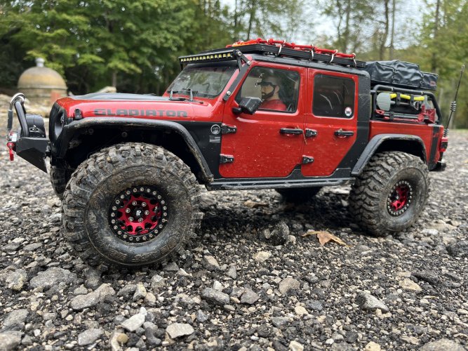

Looks like I forgot to post the Gladiator’s first official outing. Took it out for a drive back in September 2024 at RC River Cliff Trails here in Ohio.
This rig was a blast to drive. Its weight and longer wheelbase made for some great scale trailing. I put many scale miles on it that day and it never let me down. It’s a beast! The only issue I had and it is common on these Axial rigs is the annoying click that comes from the transmission. I didn’t notice it too much the first time I had it out when it was box stock.
So the plan will be to drop in a Vanquish VFD transmission before it hits the trails this spring.
Here’s a few pics of its day on the trails.
