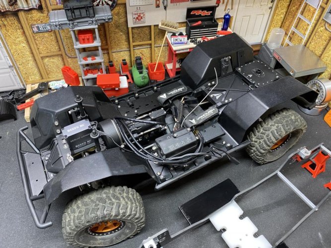

Here is a look as it sits present day. Origin body gone topless with a Knight Customs roll bar with VP Method 310's with Pitbull OG Rock Beast tires.
The new GSpeed TGH-V3 carbon fiber chassis kit and accessories. I decided to go with the Team Garage Hack Dual Servo mount so that I can keep it similar to how the stock Origin is with the servo and winch up front side-by-side.
Here is an under body look at how the Origin is currently sitting.

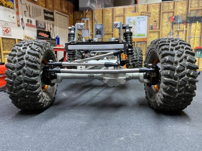

Pulled off the complete front and rear axle and also the VFD trans. This is all I will need of the Origin to add to the GSpeed V3.

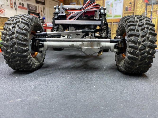

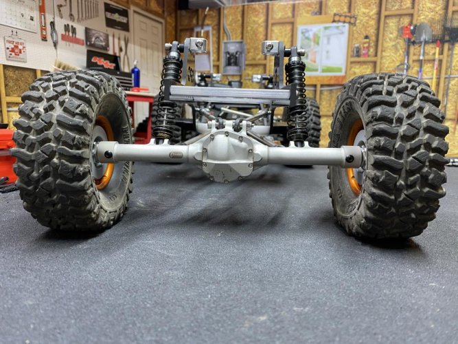

And here some pics of the axles installed. Very easy install! Everything was basically plug-and-play! The only issue is the panhard link. I'll have to work on getting the correct length figured out.

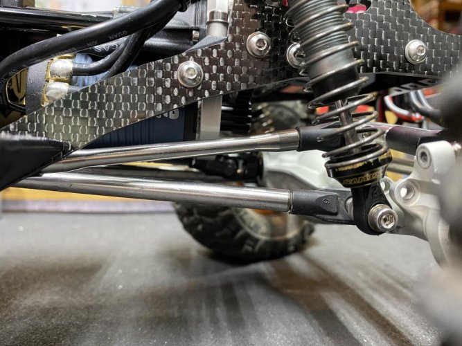

I did spend a little time last night lengthening the panhard link to see if I could get it to work. Right now the link is at 113mm long and the axle is fairly centered in the chassis. But, and a big BUT, the panhard link, servo horn and axle all make contact when compressing the drivers side. More work to be done! But that's what makes it fun!!!!!
If you end up trying the TFR mount maybe this may help, it has a double bend. You can use the rod ends in a few combos to change the lengths to 89mm or 93.5mm or 98mm.

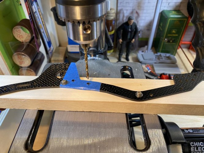

Mounting holes marked and drilled. Added a piece of tape to each rail and screwed them down to a scrap piece of wood to help keep the holes straight and keep the CF from splintering.

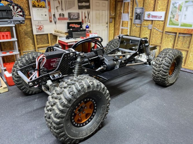

Got the chassis back together and the VFD trans fitted in. Instead of using the TJ RC Products skid plate that came with the TGH-V3 kit, I decided to use a TSS delrin skid plate that I purchased a few years ago for my SCX10.2. I wanted to keep the black theme throughout the chassis rails and didn't like how the white TJ skid looked. The TSS skid is basically the same except for it being a wider front to back. It is still the same width between the rails.
I need to give GSpeed Team Driver Phil T. a shout out for giving me the inspiration to start this build. He has converted many VS4-10's into these GSpeed V3 chassis' and it is his vision that I followed to get the VFD trans into this chassis. He has some absolutely beautiful builds and if you haven't seen them then you need to take a look at them. Thanks Phil!
I set the VFD on the skid plate and marked where the holes needed to be drilled. Drilled holes and then countersunk them.

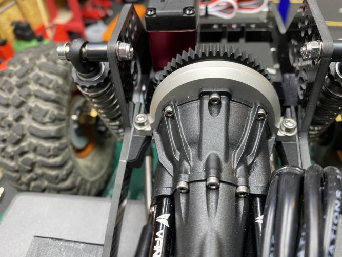

I used 9mm alum spacers on the two mounts on the right side and an 8mm spacer on the left mount. I had to add a washer on top of the front alum spacer to get the spacing right before I tightened them down.
Here is a side view showing where the motor sits inside the chassis rails. At full compression (this pic is not at full compression), the motor sits slightly above the lower links like it did in the stock VS4-10 chassis.

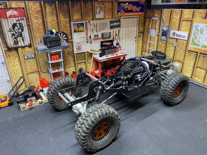

The next two pics is a look down from the top and up from the bottom to show how close the spur gear is to the front servo mount. I moved it forward as close to the servo mount as I could and still left a little room to spare. I really wanted to use the stock spur gear cover to protect the spur and pinion, but that would have pushed the trans too far back on the skid plate and the trans mounting bolts would have been to close the rear lower link mounts. I also had to notch the skid plate for the front upper link to clear.

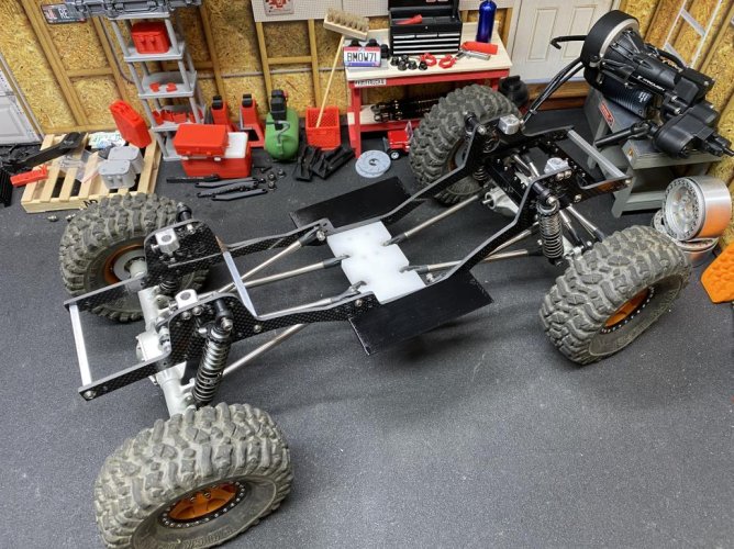

And a couple aerial views of how the chassis sits now.
Here is a look at the front end. I still need to work on the panhard link. I'm having issues with the panhard link hitting the servo horn at full compression. I have a GSpeed laydown servo mount on order to see if that will help me get the clearance that I need.

If your transmission is in the same location as the VFD skid or any further forward you may run into clearance issues with spur gear and G-LD mount. I had to grind mine down a few millimeters but there is plenty of material that can be removed. I have no clearance issues with the servo horn and any of the links up front at full compression. Awesome Build!!
Thanks for the heads up!"thumbsup"
I did a side-by-side comparison with your pics of yours and it looks like my trans sits a little further back and slightly higher. It looks like the stock VFD skid sits lower in the chassis and moves the trans farther forward compared to the flat delrin skid that I am using. The G-LD servo mount looks like it mounts in the same location as the TGH dual servo mount, so I'll find out for sure when the new servo mount arrives.
I'm fairly certain by switching to the G-LD mount it will allow for full compression since it puts the servo horn vertical out front of the axle.
