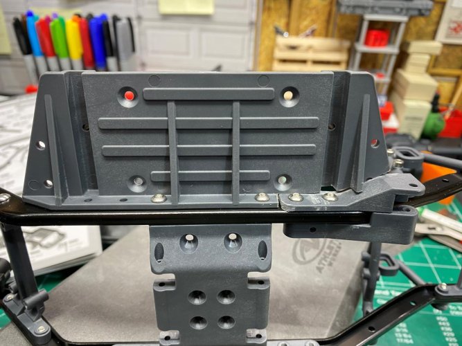

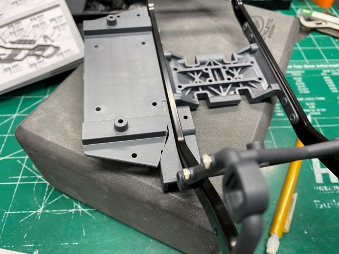

A few parts have arrived and I started working on adapting the GKS trailing arms to the Knightrunner sliders.
I cut off the trailing arm mount off of the stock GK sliders. I used my Dremel to sand the surfaces smooth so that I could fit them into the KR sliders.
Marked out where the trailing arm mount will be and cut out and sanded the KR slider.
Mounted the sliders and trailing arms to the chassis rails. All fits good and has a solid mount. Not the prettiest fit, but it will get the job done!:)

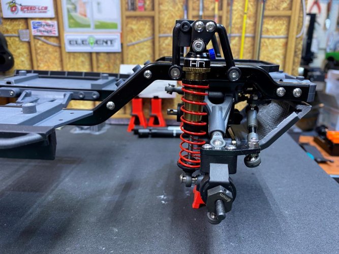

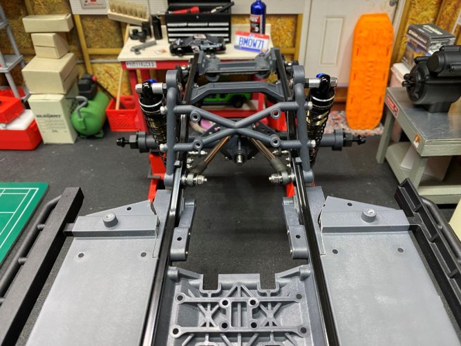

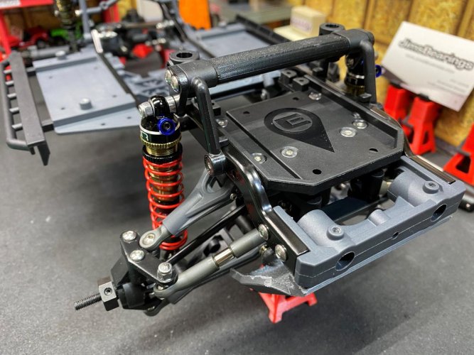

Made some good progress on the GK-Knightrunner this past weekend. I was able to get the Element IFS installed into the chassis.
Here's one more pic showing the modified Knightrunner floor boards and GKS trailing arm mounts. Like I said previously, not the prettiest cuts, but it all fits and operates like it should.

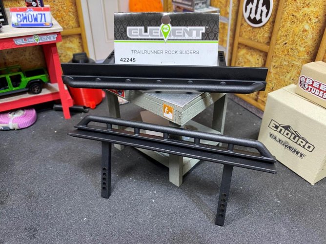

Picked up the stock Knightrunner sliders. Nothing fancy with these, but they do have a slot built into them to hold the edge of the body in.

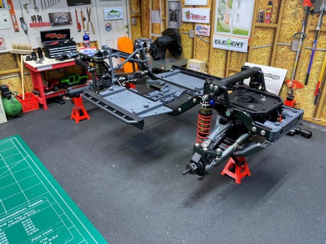

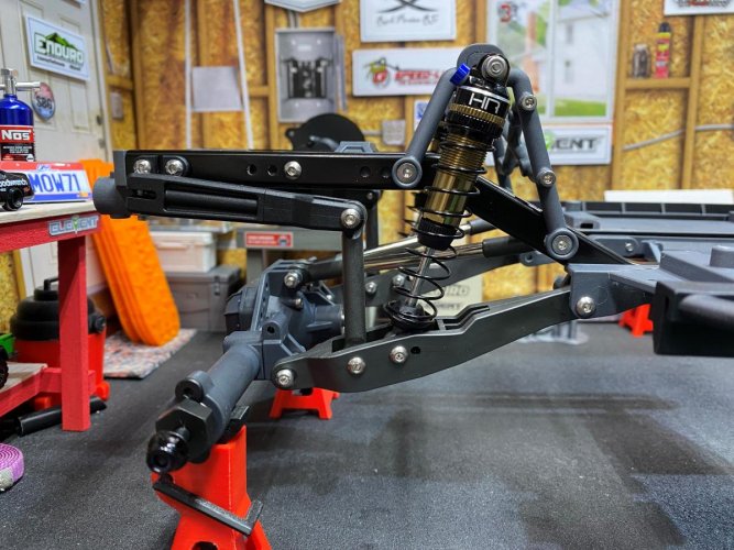

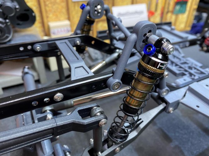

Here are a few pics for your viewing pleasure. IFS installed into the chassis without issue. Also a few pics of the rear suspension.

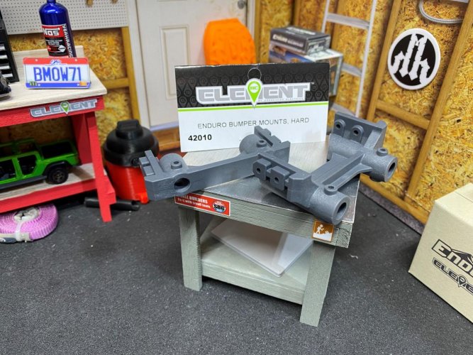

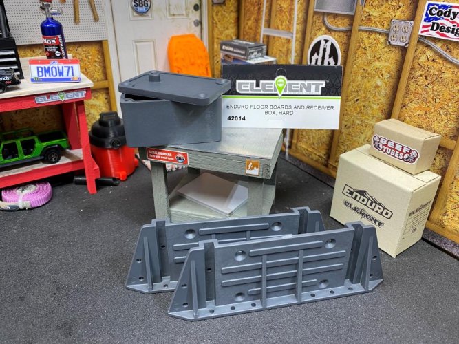

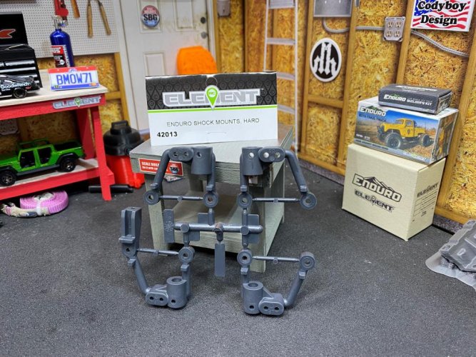

I also picked up the Enduro hard shock mounts. I figured since the rig has the gray "hard" plastic theme in it that I may as well make the shock towers match.

Here is both the Bowhouse RC steering rack and bell crank parts to fix the slop and bump steer found in the stock IFS setup. The parts are anodized aluminum and the steering rack also comes with 3D printed bump stops.

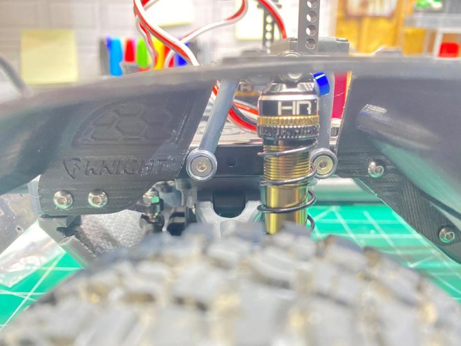

After installing both sets of steering upgrades, I found out the alum steering rack put the tie rod links too low and caused massive bump steer issues. I even added spacers to the knuckles to lower the links. You can see in these 2 pics how far uneven the links are compared to the top a-arms. As I said, when the suspension was cycled, there was massive bump steer.
Edit: I forgot to mention that the IFS has the Knight Customs 3D printed lowering parts. The Bowhouse steering rack does not work in this setup, but does work extremely well when used with the stock Element IFS setup without the lowering parts.

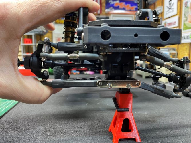

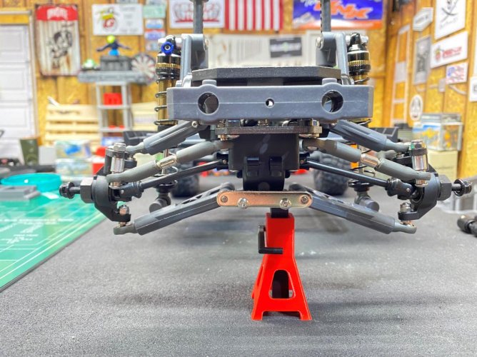

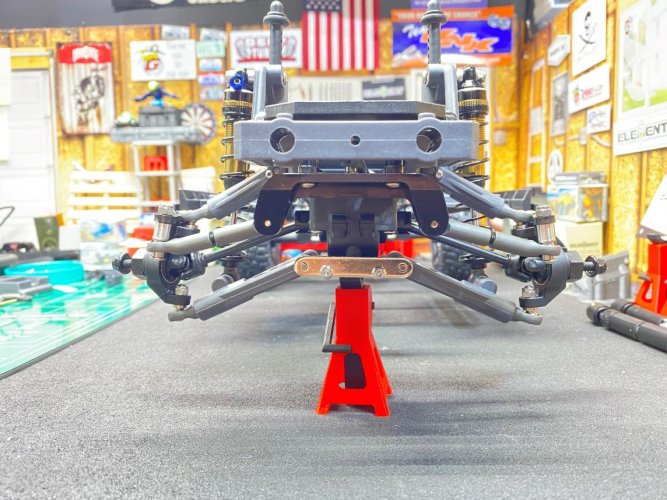

So to fix the bump steer caused by the Bowhouse steering rack, I decided to go back to the stock steering rack to see if it would help with the bump steer.
By removing the BH steering rack and installing the stock metal rack, the links are more closely in line with the a-arms. I stole a tip from Tekin Builds that he has previously posted in his Bronco build thread and applied it here. Ty's tip is to add a 6mm spacer on the knuckle to lower the links to put them in line with the top a-arms. By adding the spacer, the suspension know cycles better and eliminates most of the extreme bump steer that it had. Thanks for the tip Ty!"thumbsup"
So to be clear, I am not using the Bowhouse steering rack, but I am using the Bowhouse alum bell cranks. The bell cranks do work with the Knight Customs 3D printed lowering parts. The bell crank does take out most of the slop that was found in the stock plastic bell cranks.
In other words, it looks like people have to go with either the Bowhouse upgrades, OR the Knight Customs upgrades, but NOT both. I'm sure there will probably be those who will disagree with what I'm about to say...but, everyone is entitled to their own opinion (so, for those who oppose my thoughts, is accept your thoughts).
Personally, between these two choices, I feel the Bowhouse road is the better road to travel. Yes, the KC route does increase clearance...but, I'm thinking the 3D-printed parts (no matter what the material) would never be as strong as the original plastic parts. As for the steering, likewise, the aluminum parts from Bowhouse should not only remove 99% of the steering problems of the original parts, but also provides a much stronger strong solution.
Whichever road anyone chooses to go, at least you know you'll be ending up with something better than the 'factory' IFS...and,b that's what matter most, right? [emoji1688]

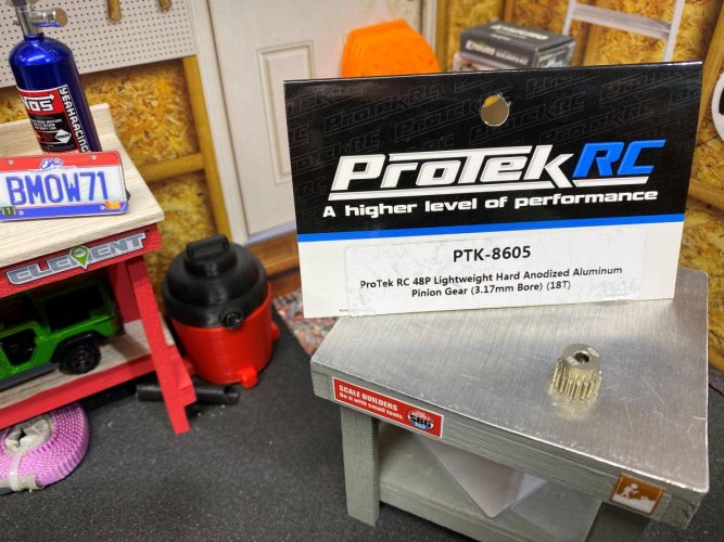

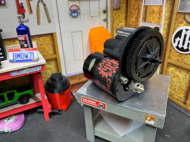

I'll be running the same motor that I have in my GK-Ecto. These motors are smooth and can be had at a great price. Also picked up a Pro-Tek pinion gear. I'll start out with an 18T, but may go down a couple teeth once I get it on the rocks.

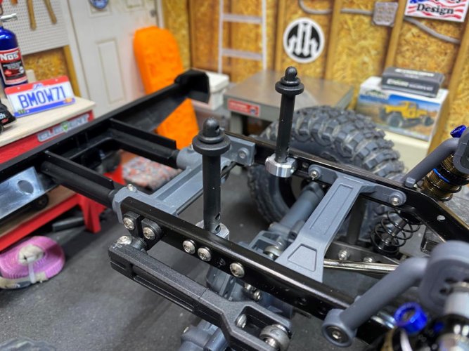

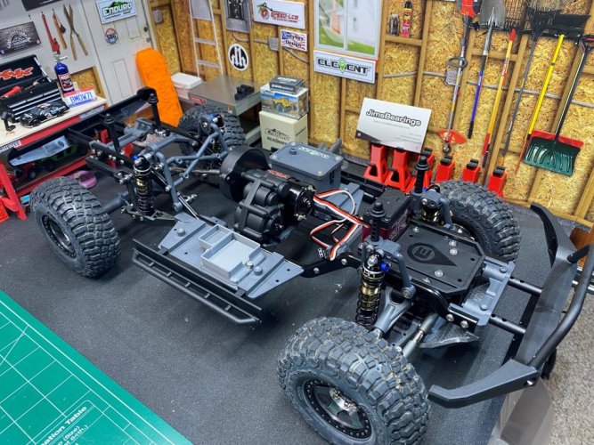

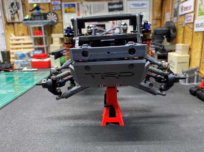

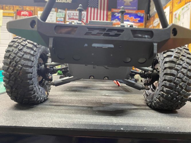

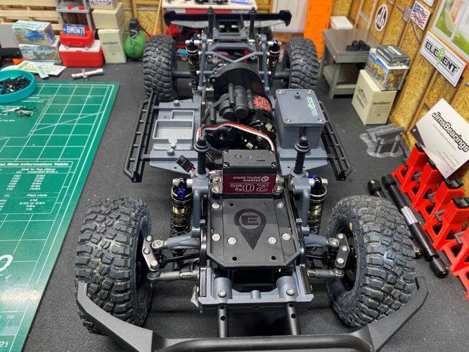

And a few pics of how it sits now.
I forgot to mention the shocks and servo that is currently installed. For now I'll be running a cheapy Amazon servo because that's all I have on hand at the moment. It will eventually get a name brand more powerful servo.
The shocks are the stock GK shocks with the bronze shock bodies. I have them setup the same way as the GK-Ecto build with the Hot Racing bleeder caps. I would have used CODYBOY's shock tip on these, but I already had the HR caps ordered and on the way. The front shock springs are the black springs that come with the IFS kit.

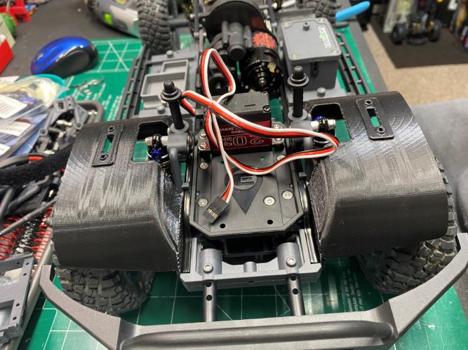

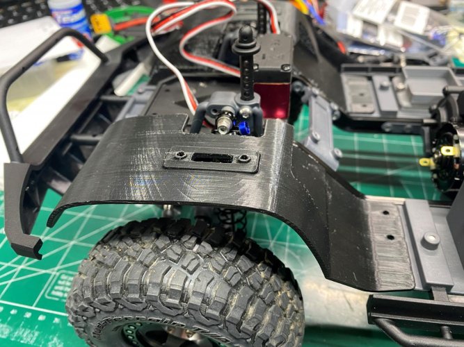

Next on the list is getting the Knight Customs 3D printed inner fenders and rear floor board attachments that are found on Mymininfactory. These are straight off the 3D printer and will need a good filing and sanding. The plan is to shoot these with a couple coats of flat black paint after the sanding to give them a more real look.

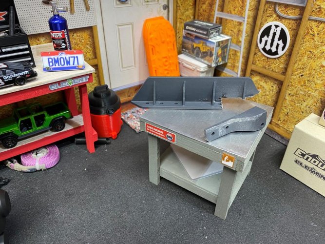

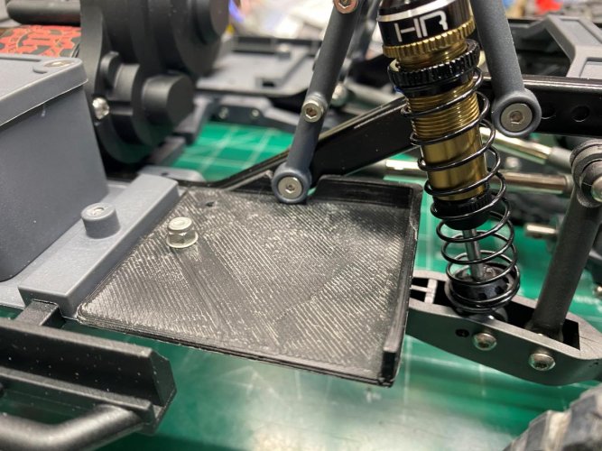

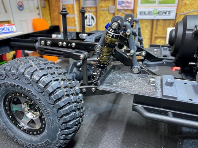

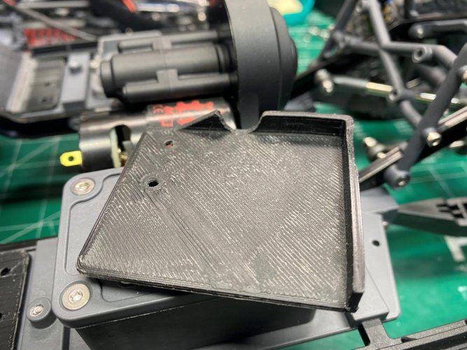

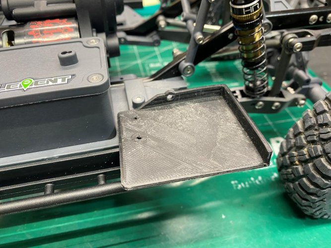

These are the rear floor boards that attach to the rear of the Element stock floor boards. Since I have modified the stock floor boards to use with the GKS trailing arm mounts, I had to modify the rear floor boards to fit.
I Dremeled out part of the side to fit around the rear shock tower. Also put a slight bevel on the rear of the floor board to give clearance for the rear shock spring.
The rear floor board is designed to mount with two screws, but I was only able to mount them with one screw and nut. I think the one screw will be enough to hold it in place since it fits snug around the bottom mount on the shock tower.

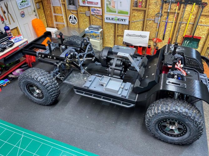

Another photo dump of the GK-Knightrunner in its current state.

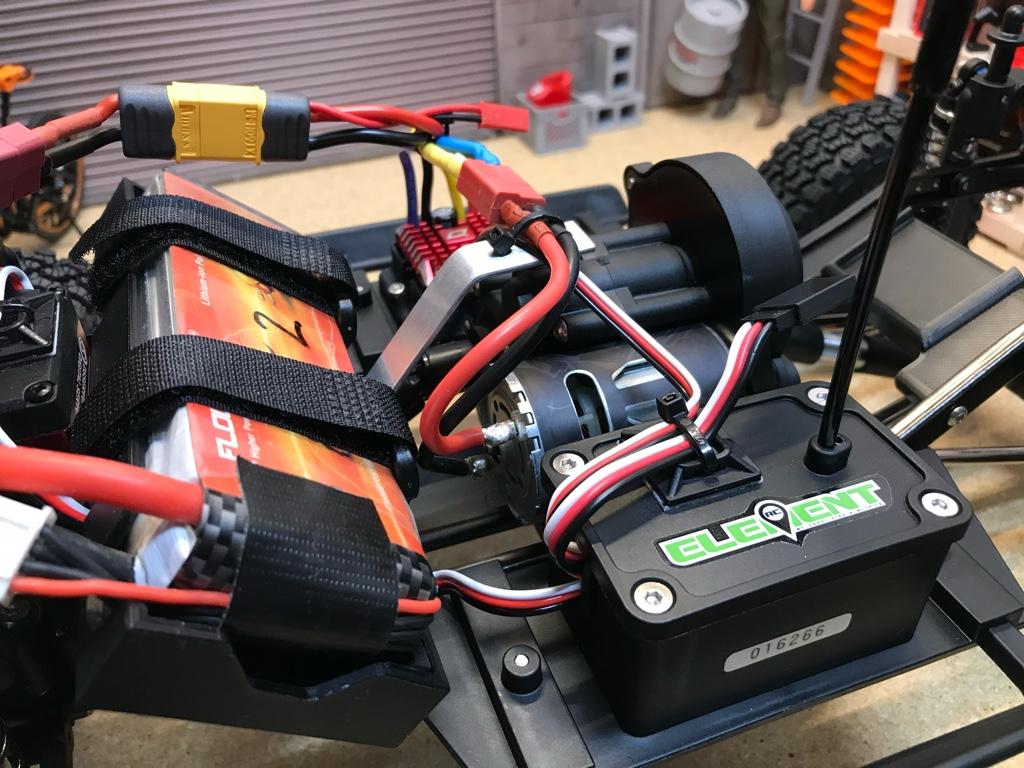

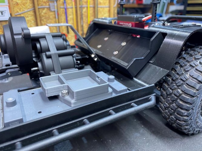

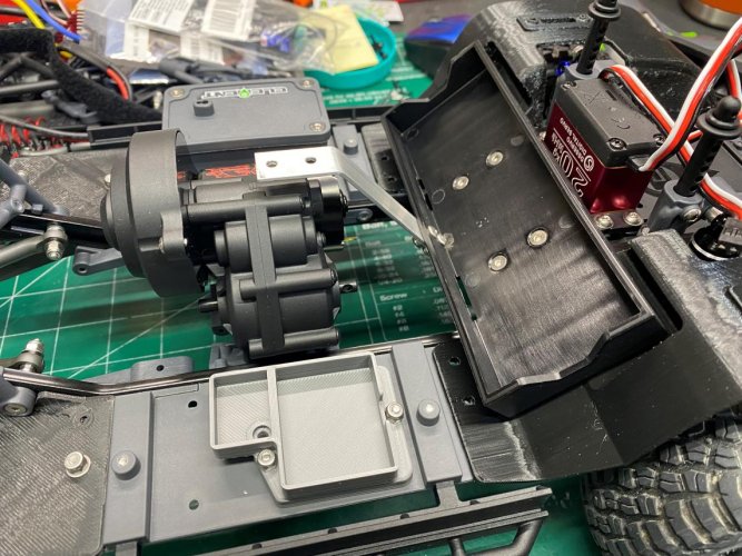

Added an alum bracket to the battery tray to route the wires over the trans. I've used this method on all of my Element rigs and it works out well. Once I get the electronics installed, you'll see how it works.
Also printed a HW 1080 ESC mount and attached it to the floor board. I forget who designed it, but it can be found on Thingiverse. I've used this on my other Element rigs and it works well.

Top view of how she looks now.

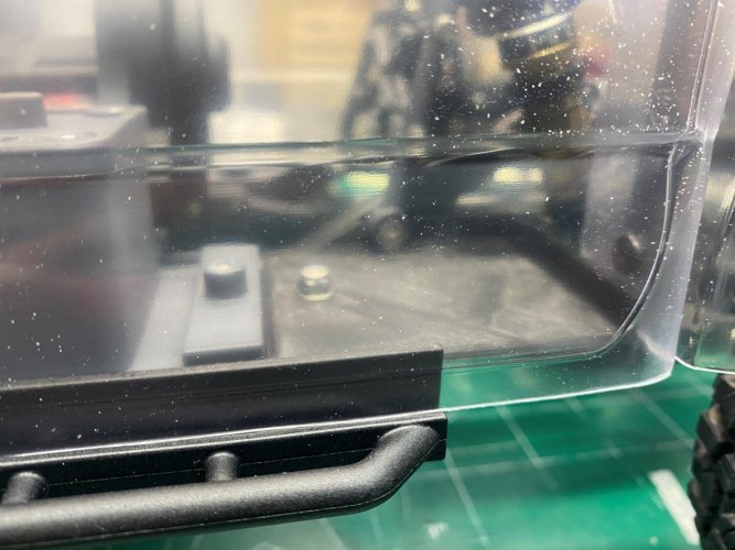

Here's what I came up with to mount the rear of the Knightrunner body. Since I'm using the GKS rear trailing arms, the shock tower is farther forward than where the stock shock tower sits that holds the body mounts. This method sets the body post further back and helps support the body better. These alum mounts are the Rock Pirates RC body post mounts. I'm also using these on my GK-Ecto build and are mounted on the front shock towers.
