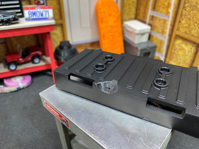

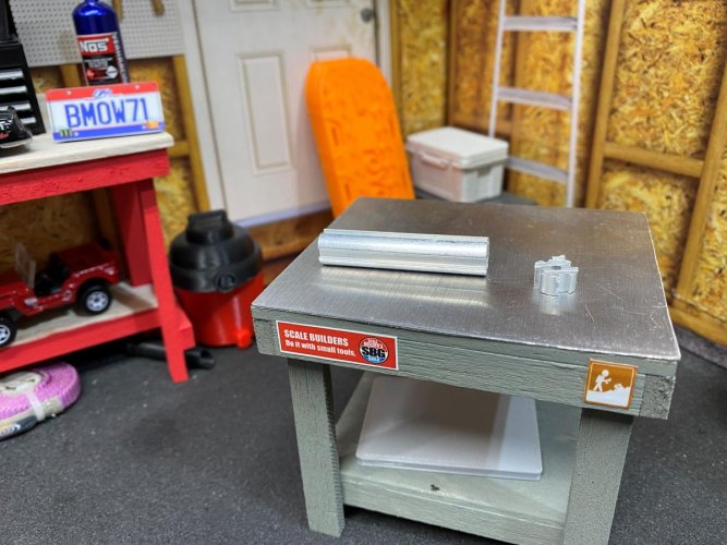

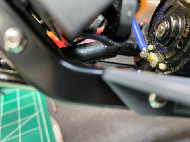

So I thought I was having some binding in the front driveshaft when I cycled the suspension. I noticed that something was stopping it from going to full compression. I immediately thought that alum center piece in the driveshaft was too long. So I cut about 5mm off of the length and reinstalled it. Come to find out, the driveshaft was hitting the bottom of the battery tray. Duhh! See second pic:

Took the battery tray off and Dremeled a spot on the tray to allow for the driveshaft to clear when suspension is at full compression.
While I had the tray off, I notched out an area so that when the front shocks are installed in the rear mounting hole the shocks clear the battery tray.

Installed the front shocks in the rear mounting hole. Clearance problem solved!:)

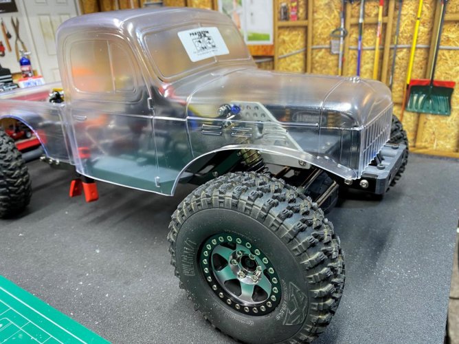

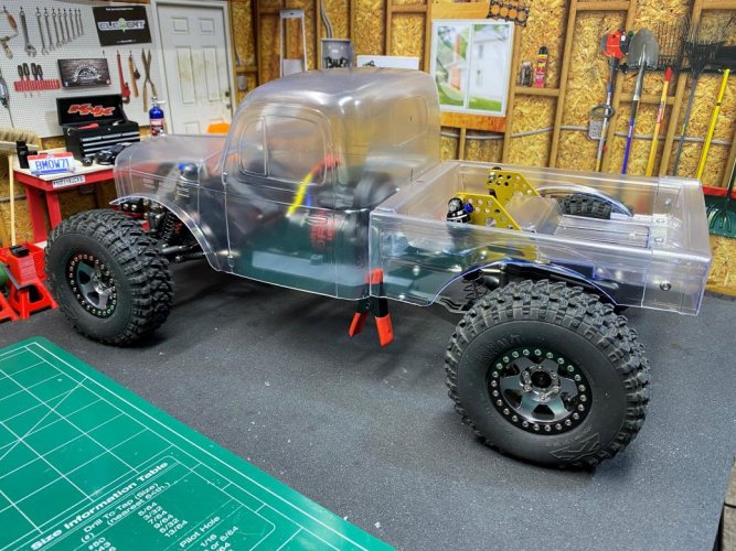

I decided to steal the Pro-Line Power Wagon body from another GSpeed build that I am currently working on until the clear Ecto body is back in stock. I got it cut out, trying to save a portion of the front fenders, but I'm not sure if I will be able to since I have the body sitting so low. I'm afraid once I install bigger 1.9 tires that they will rub the body. I guess I'll find out later.
I cut out the inside of the bed so that the Rock Pirate RC shock towers would clear and also cut out a section so that the rear sway bar would have room to cycle up into the bed area. Also did a bob on the bed to shorten it up a bit.

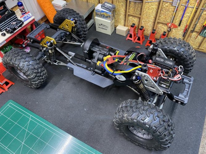

I just about forgot to show the electronics I plan to use, so here is a look at what I plan to run at the moment. I had to rob from Paul to pay Peter or something like that! Since my Capra is now in pieces (axles got stolen to put in another GSpeed build), I'm going to use it's power plant to give life to the G-E-K.
It'll be a Holmes Hobbies Crawlmaster Sport 540 16T motor paired with a Hobbywing 1080 ESC. For the money, these two are hard to beat and they perform very well together. Not exactly sure on the pinion size, but I will be keeping the 48 pitch gearing in it. I love how quiet the 48P gearing is.
Also, as you'll see in the pics, I stole the wheels and tires from my TRX-4 Sport for now until I decide which wheel and tire package I want to go with. A set of Vanquish 1.9 Method Roost with 475 hubs mounted on a set of Canyon Trail tires cut and siped. For a stock tire, these perform very well!
Everything mounted up beside the servo. I'll eventually use Conformal Coating to waterproof the receiver so that I don't have to run a waterproof receiver box. Though I do try not to run in water when ever possible.

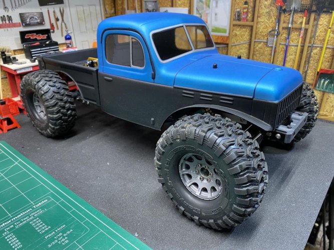

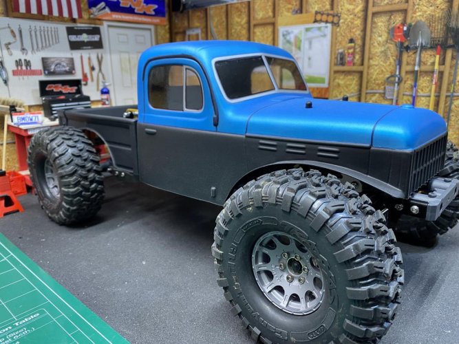

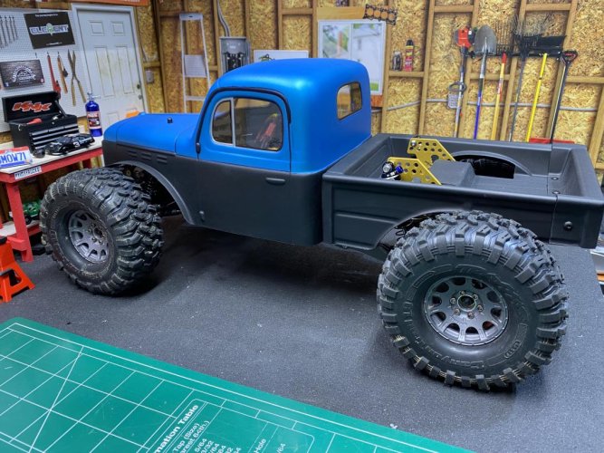

So back to the Power Wagon body. I decided on this one I would paint it on the outside and let the rocks, sticks and nature weather it as I drive it.
I'll be using Tamiya PS-12 Silver for the color on the inside of the body. On the outside I'll be trying the new Traxxas ProGraphix paint. I like that these paints come in a bigger can than the Tamiya paints.
And here it is pre-decaled. I used the outside film to mask off the windows. I painted the bottom half black first and then taped it off and sprayed the Metallic Blue next.
I then cut the outside film to expose the silver that was sprayed on the inside around the windows. I then used a black Sharpie to add the body lines and window gutter. Then a couple coats of the Traxxas Matte Finish to seal everything up and give it a duller look.
As it gets scratched up, I'll add some streaks of rust to the scratches to give a worn and weathered look.

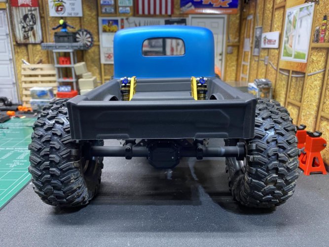

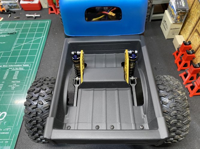

I still need to get the rear of the body mounted. I'm not too sure yet if the bed will work the way it is. Even with the wide 475 hubs, the tires want to rub on the bed when the suspension is flexed. I may have to narrow the bed up a bit to get the clearance that is needed. I'm not really wanting to do that just yet.
I may hold off on chopping this body up and just wait tor the clear Ecto body to come back in stock. This Power Wagon body was originally supposed to go on my GSpeed V3 rig with the stolen Capra axles. With the width of them axles, I would not have to do any chopping to the bed to give clearance for the tires. Decisions, decisions!!!
