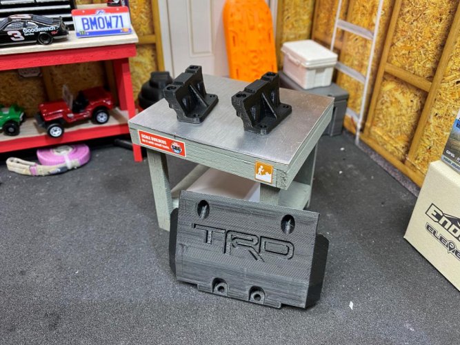

You gotta add the Knight Customs IFS parts. They really give it more clearance.
It's funny I bought the files (original non-Knightrunner version) when they first came out early on, because I could see that it would raise the skid for the IFS and give it more clearance. At the time the IFS prints were only being advertised as raising the IFS up in order to run smaller tires without it looking too lifted. About a year after he first released them.... what do you know... everyone caught on that it would give more clearance for 4" and larger tires and now they're advertised that way.
It also makes the front skid look less vertical (if you use the 3d printed skid replacement for the lifted IFS). That was always one of the things that bothered me about the IFS was how vertical that front skid plate was.
I agree, the skid being so vertical bothers me too! I do plan on doing the Knight Customs IFS conversion. It makes the front end look so much better! And it sure does need the extra clearance.
I’m still running the stock IFS on my Trailwalker. I should do the Knight Customs upgrade on that one as well!
I don't know if you remember from my Trailwalker build thread, but I was using 7430 red springs up front because they were softer at around 3.9
I later on removed them after a few times out, because the IFS skid kept bottoming out from it being softer than the stock IFS springs.
I've since put them back on again after using the Knight Customs IFS lift. With the lift and the red springs, it's perfect!

Getting ready to start printing 2 sets of the Knight Customs lifts![emoji3]
You can fit tires bigger than 4" depending on the body but the front skid is too wide at the bottom to clear a 4.75" tire. You need to narrow the front skid for it to clear.

Ah that's good to know! I've only run with 4.19, so I haven't come across the issue yet.
Also, regarding the body... Absolutely true. If you noticed, the Knightrunner uses spacer limiters on the shock shaft to limit compression even with 4“/1.55 setup to prevent from rubbing the body.

I have the KC skids and the differential raised mounts on my KR. I printed them in regular PLA and they seem pretty durable to me. As long as you're not bashing it, I think they'd hold up fine.
I don't have a vendor star so I don't think I can say too much, but I'm willing to print parts for you with a proof of purchase (from KC). PM me for details if you're interested.
Sent from my LM-V600 using Tapatalk
This is exactly what I plan to do. I'll be trying them out in PLA. I think they will be fine for the light trail driving that I have planned for it when I convert it to a Knightrunner. But we shall see!
