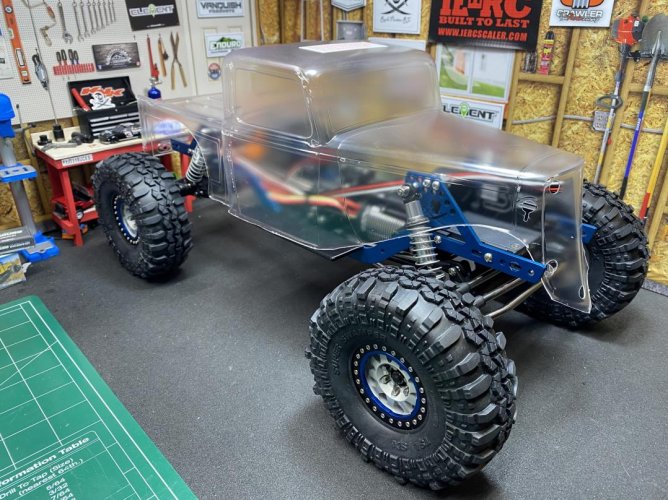

Got the Hot Rod body all cut, lowered and mounted. Chopped and cut a little at a time until the body would go as low as possible without having the steering servo stick up thru the hood.
I received my Team GSpeed order yesterday. Picked up the chassis servo mounts in hopes that I can mount the OG and DIG micro servos to them. Also ordered the One Shot clear lexan body. This body was my first pick to use before I found the '35 Hot Rod Truck body. Looks like the One Shot body will have to go on a another new build!;-)
I really like how this body hugs the chassis. It sits and fits well with the GSpeed V1-C1 sliders that I had left over from another overdue build.:roll: Also this body fits nicely and wrap around the front of the servo and tucks in between the chassis rails.
Hoping that this roller coaster weather pattern I'm currently having will swing back to warmer temps so that I can get some paint put on it. In the meantime, I'm going to work on getting the micro servos and receiver mounted so I can test her out in the basement.

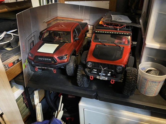

Ok I haven't seen a pic or post but you have this massive list of amazing builds already done, plenty in the works but I have a question, WHERE IN THE HELL DO YOU PUT THEM ALL [emoji1787][emoji1787][emoji1787]. Cause from all the ones I see here and IG it's starting to look like you could line every wall in a 12x12 room top to bottom.
I ask cause I forgot how much I loved doing builds, and everytime you always seem to mention a different build in one of these projects it makes my gears turn. But I'm gonna run outta room fast lol.

Looks great so far Brian. I like how it tucks over the rails up front

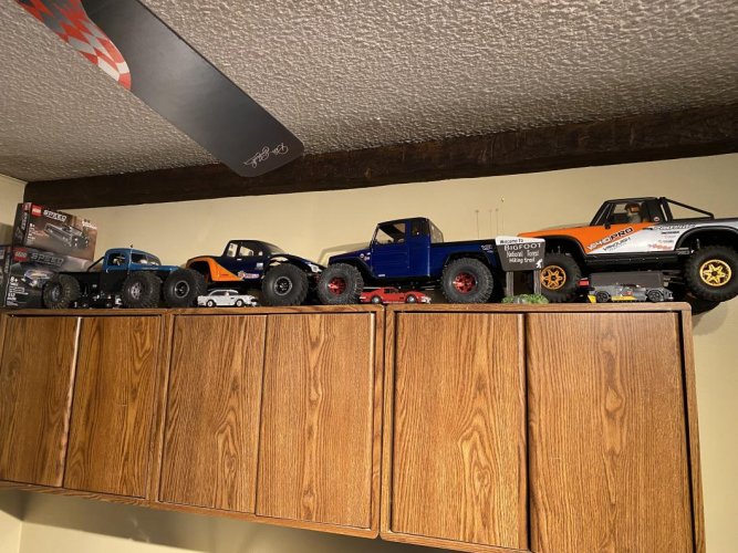

"WHERE IN THE HELL DO YOU PUT THEM ALL" That is a most excellent question and one that I would like to ask too! Ugg, I am in need of more room to store these and/or need to start liquidating!:ror:

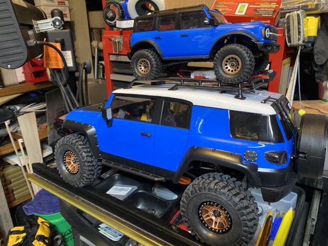

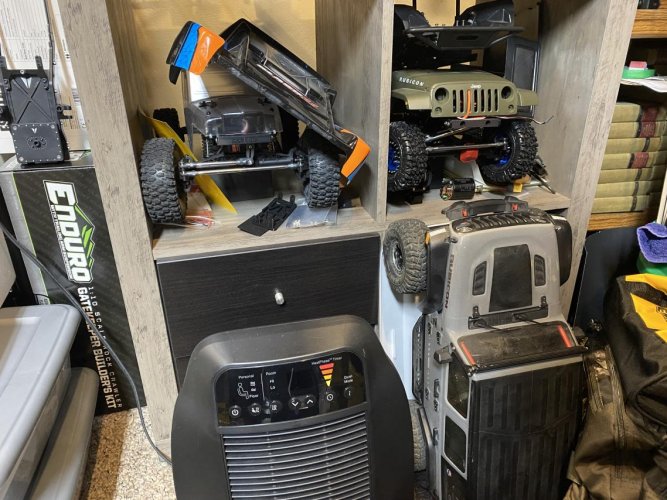

Well, my shelving in my hobby room is full so my rigs have spilled out to other areas in my basement. Here, hold on, I'll just show you! There are some on the shelf like my V3 Origin and Marlin that are buried.

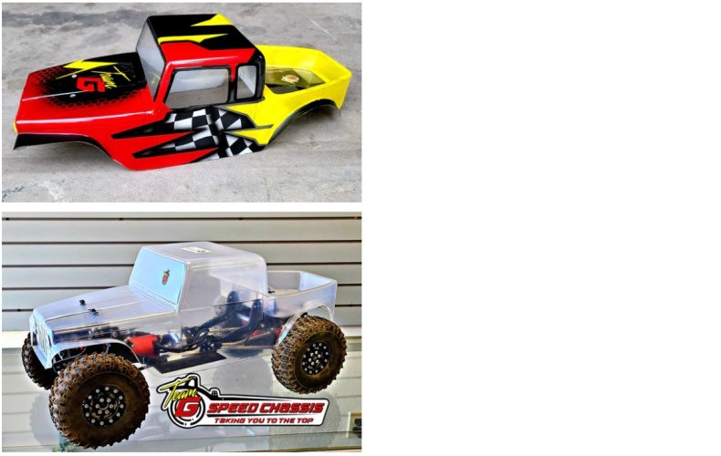

Here is a screenshot from GSpeed website. The One Shot looks like a cool body.
Thanks Tom!"thumbsup" I think it's gonna look killer with some paint on it!
I love it when when you guys show post of how out of control your collections are, it makes me feel better about the bloat I feel mine has become...lol

That's funny!:ror: I feel like I may need some picture therapy from some others collections to make me feel better!:lmao:

Holy crap Brian!!!
Now I don't feel bad now. I'm not to the point of having to cram in whatever space I can find yet and now I know I'm not the only one that does it lol.
Always see people post pics of what you have going on with the buggies and such. Nice wall full of those hooks or big set of shelves etc. Happy to see someone who's work room looks like mine lol.

I know, it's shocking!!:shock: Give it time, you'll be looking for space for all your new builds too!:ror:
The buggies are sitting on shelving brackets. It works great for them since they have a flat bottom. Not so well for linked rigs. Most everything hanging on the wall except for the Yeti and Honcho are my race buggies, late model and sprints from the late 80's, early 90's. I'd like to refresh them and get them back out in the dirt someday, BUT that may never happen!:roll:

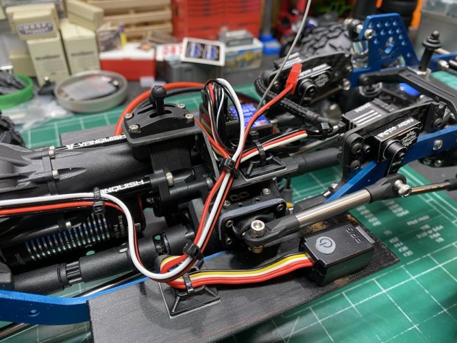

Finally had a chance to get back to the bench!

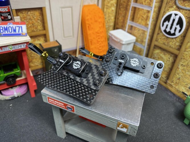

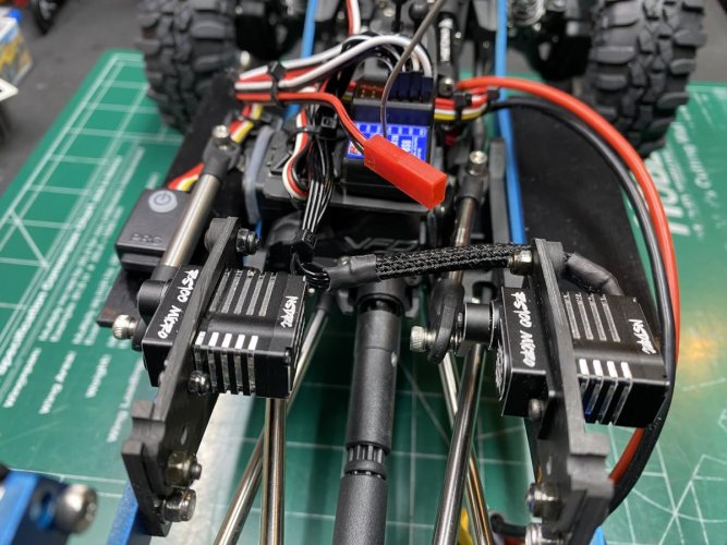

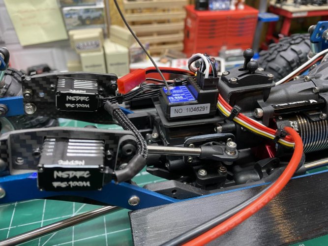

I have the DIG and OD servos installed. I ended up using the NSDRC mirco servo adapters mounted in the GSpeed servo chassis mounts. I had to get creative to mount these servos to keep them hidden under the body so that I didn't have to cut holes in the bed of the body. I trimmed the carbon fiber servo mounts so that they only are mounted with 3 screws. This keep the mounts low and under the body. I don't have a good pic at the moment, but I also filed down a few mm's off of the chassis rails so that I could drop the servos as low as I could.

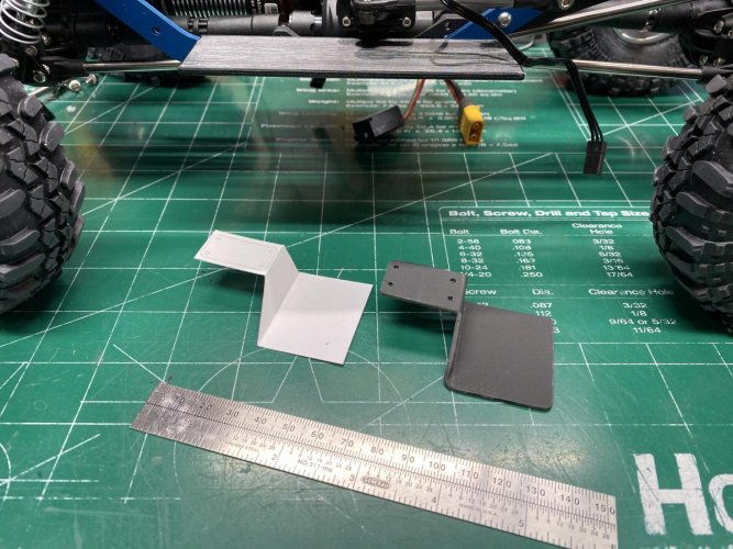

Next up was finding a home for the receiver. I had plans on mounting it up beside the 3Bros steering servo, but the NSDRC DIG and OG servo wires wer way too short to reach up to the front of the chassis. So I decided to try and find a spot somewhere closer to the back.

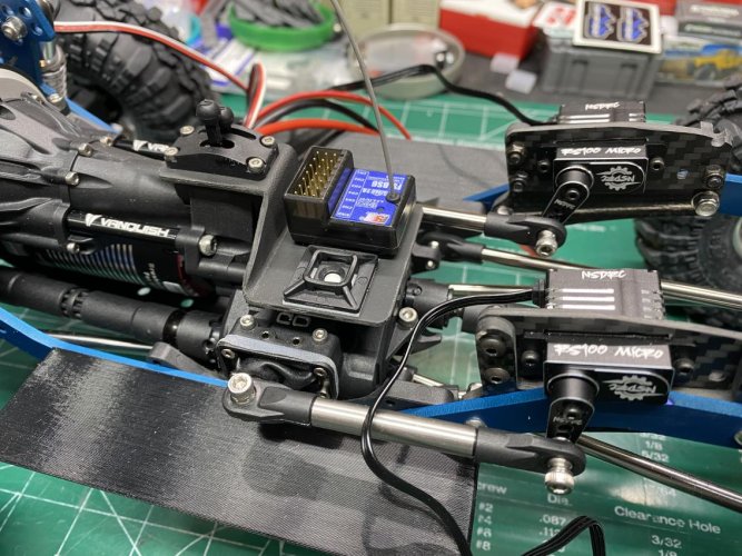

I ended up going the same route as @indybama did on his GSpeed V3 Phoenix build (pic of it posted previously in a few post back). I decided to mount the receiver right behind the VFD on top of the transfer case. I used a piece of Kydex. I cut, heated and bent it to mount to the 4 screws that hold the VFD trans "cap". I made it extra wide to the driver side so that I could mount all of the wires there and keep them tidy.
Wiring is temporary for now. Since I didn't mount the receiver up front, that gives me space for a winch servo. I'm going to get either a 3Bros or and NSCRC winch servo on order. Once it is installed, I'll get all of the wiring wrapped and secured.
Pics of it how it sits now. I'll try to get a pic of the chassis rails showing how much I sanded/filed to get the servos to sit low.
Heck yeah brian, the rx mount looks great. I just used a piece of lexan. But the way u bent yours gets it even lower n wont bounce around. Shift servo mount worked perfect too. Always good to see update brother.

Thanks bama!"thumbsup"
I thought by putting the bend in the mount and getting the receiver down lower it would allow for some kind of interior. I have an Element Gatekeeper interior that I plan on chopping up to fit in the narrow cab.

You have built up the chassis beautifully. I really like your symmetrical mounting of the micro servos. Nice attention to detail B, she's a looker...

Appreciate the kind words smog!"thumbsup" This has been a fun build so far!
