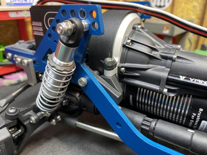

Lookin good brian! Those RPRC rails look really good, purdy shade of blue. The panhard mount having to have a locknut on one screw was a bit disappointing to me. Have to take the whole thing apart if u ever need to get to it for any reason. A buddy has a GK n the nut came loose on him on the trail. We ended up takin half the chassis loose to fix it.
Cant wait to see more progress
Thanks bama!"thumbsup" I'm really diggin' the blue rails! Glad I went that route!
The panhard mount nut isn't my most favorite part of the build! I'm hoping to get an aluminum servo mount on order soon. That will do away with that hideous nut! As for now, I do have a tiny wrench that does fit in there to hold the nut if it does come loose.

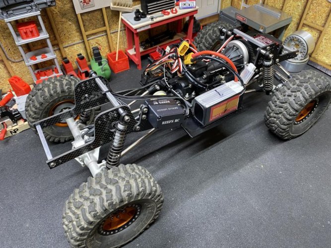

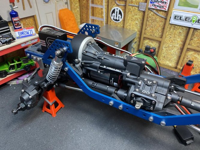

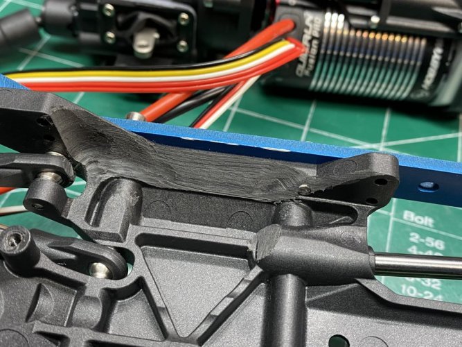

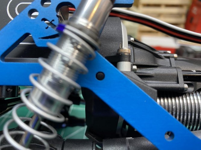

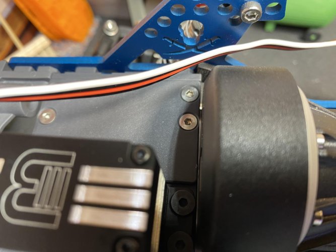

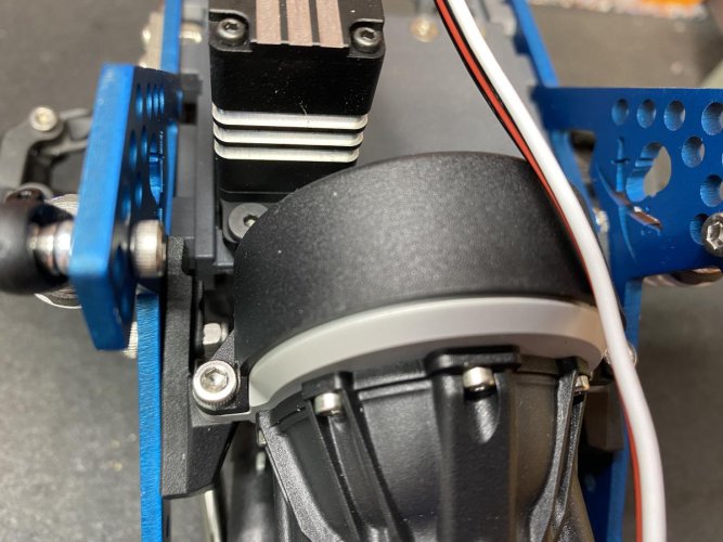

The VFD Twin trans in and mounted. It took some work to get it to fit back into the stock skid plated though. I had to Dremel out quite a bit of plastic on the driver side of the skid plate in order to get the trans to sit down in there and line up with the mounting tabs. My only guess to why I had to do this is maybe the chassis rails are squezzing to tightly on the skid plate causing it to "fold" in on itself. Not sure, but it took some time to get it just right.

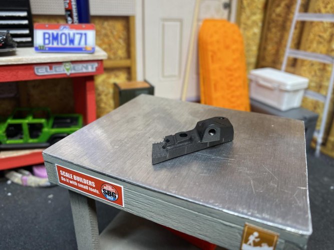

In order to mount the front of the trans and spur gear cover, I cut off the mounting tabs on the stock VP servo mount. Without the front of the trans mounted, I didn't like how loose it was sitting in the chassis. I was afraid that if/when it get under load that the trans may shift side-to-side. Maybe just me overthinking and over engineering, but I wanted the mounts in there.
The RPRC chassis rails has a hole conveniently already drilled in the side of the chassis rails that lines up perfectly for the VFD front mount. The stock mount uses 2 screws to attach it, but I think 1 screw and nut on each side should be plenty to hold the front of the trans in place.
This is how much clearance there is between the VFD and the servo plate. No room for error there! It's tight but doable!!

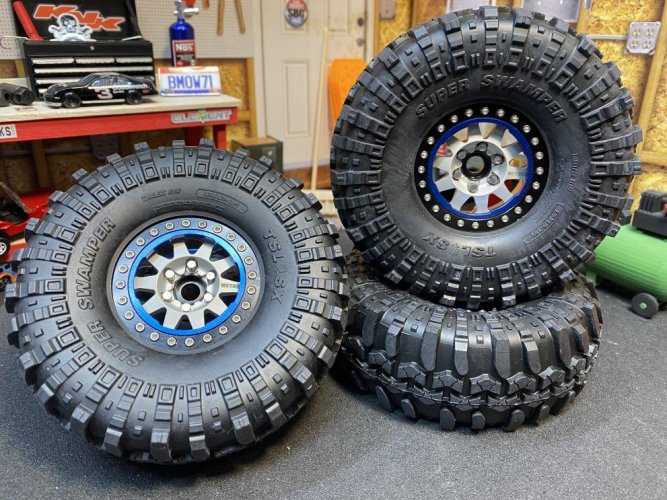

And here's a sneak peak at my WOF #2 wheels that I plan on using on this rig. I wrapped them in a set of Pro-Line TSL Super Swampers in G8 compound. This is a tire that I have never bought in the past and decided to try a set out. I've always thought the were kinda of ugly, but most guys in my area swear by these for use on the terrain that is in the area.

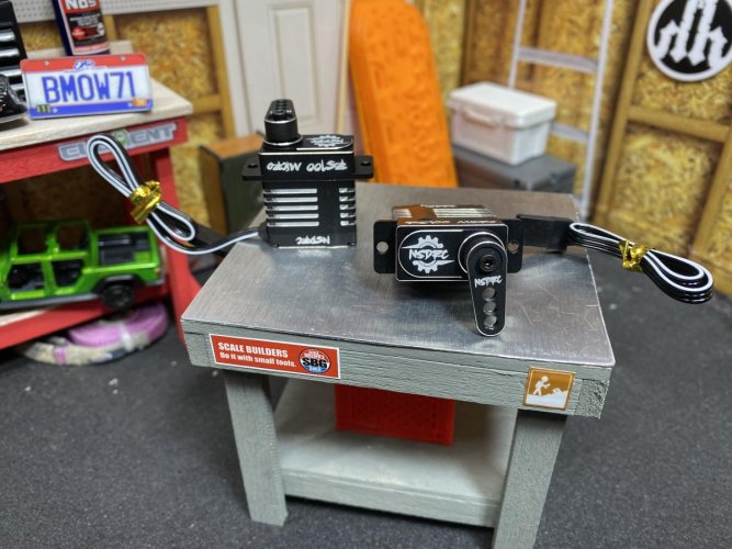

Ordered a couple NSDRC micro servos to do the OD and DIG jobs. Also picked up the servo horn made for the RS100 Micro and the adapter/winch plate to mount these little guys into a full size servo mount.
I still need to come up with some kind of way to mount the servos. I do have an order out at GSpeed for a couple of chassis servo mounts. I'll wait to see how they work out when they get here.

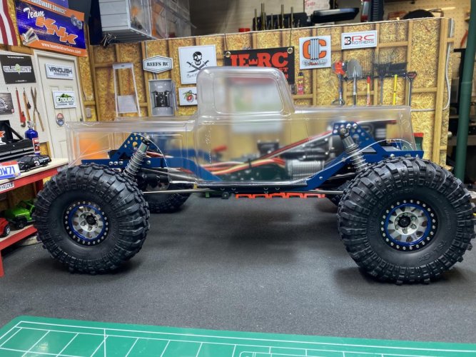

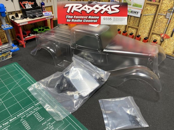

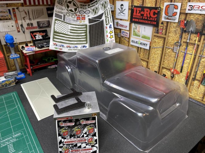

I stopped by the LHS yesterday to see what type of bodies they had in stock. I took the rig with me so that I could check wheelbase and width of random bodies.
Then I stumbled on a body that I recently fell in love with awhile back here on RCC. The once built rig by @distinctive_pd and now owned by @Fricker08 beautiful build used the Traxxas '35 Hot Rod Truck body. There it was, the same body! Quickly held up the rig to check fitment and off to the register I went.
This is a body that I think I've only ever seen used on a scale rig/rock crawler only one time by @DPD. I'm really looking forward to getting it cut and fitted to this chassis. Not yet sure of the color scheme, but It'll be something close to the WOF wheels that are currently mounted on it.
I roughly cut the fenders off of the body and sat'er on the rig. I marked out the shocks and shock tower locations to get an idea of what all will need trimmed. Hoping to get it closer and lowered down tonight after work.

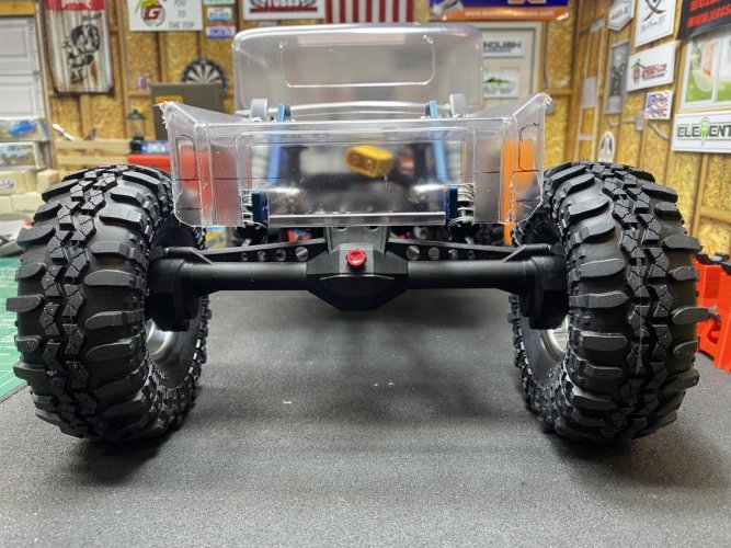

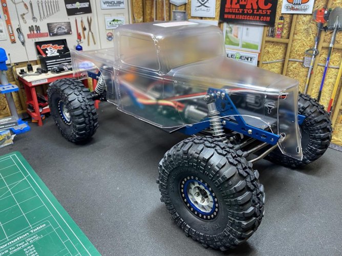

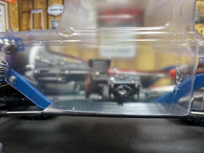

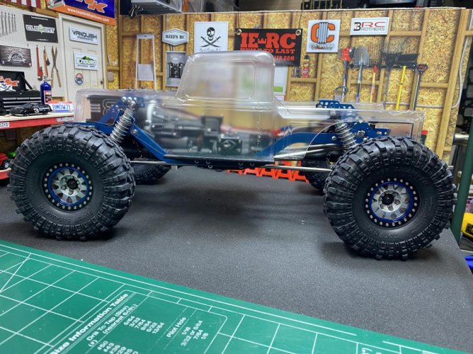

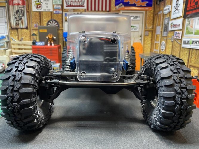

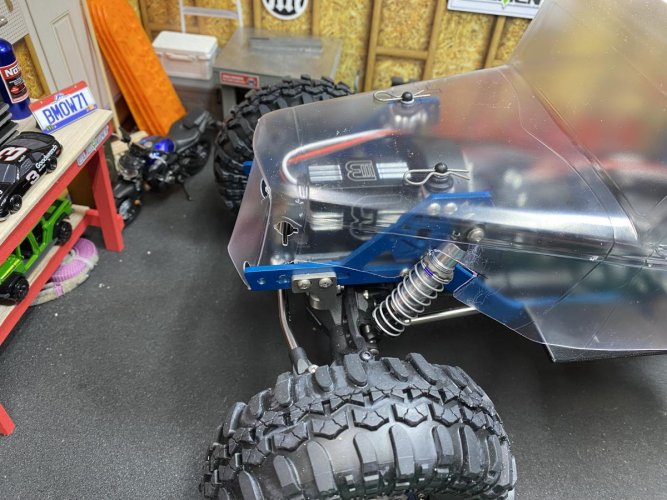

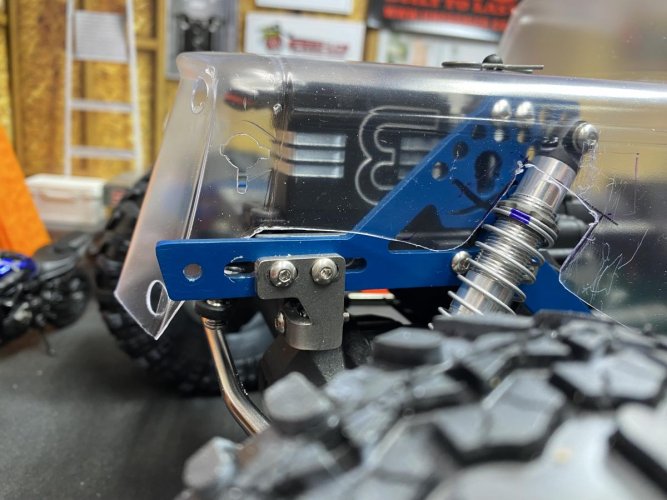

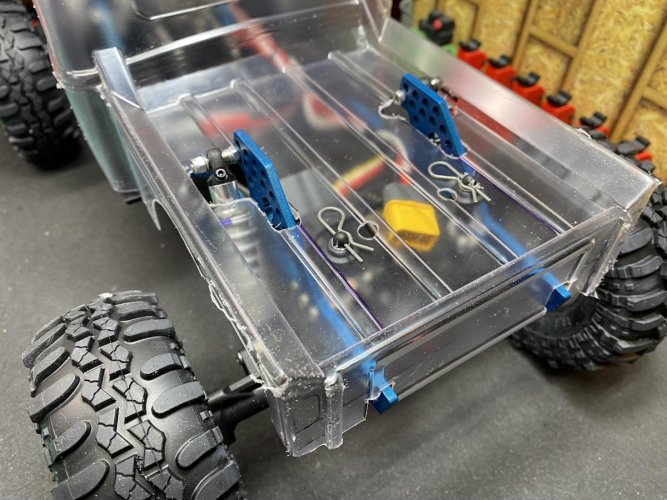

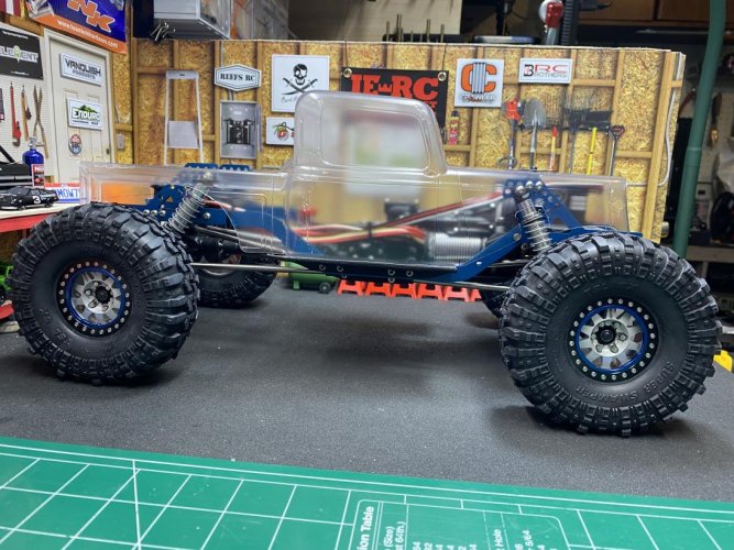

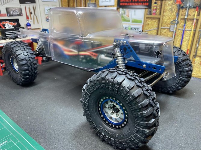

Got the Hot Rod body all cut, lowered and mounted. Chopped and cut a little at a time until the body would go as low as possible without having the steering servo stick up thru the hood.

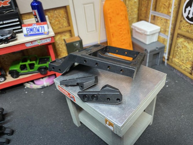

I received my Team GSpeed order yesterday. Picked up the chassis servo mounts in hopes that I can mount the OG and DIG micro servos to them. Also ordered the One Shot clear lexan body. This body was my first pick to use before I found the '35 Hot Rod Truck body. Looks like the One Shot body will have to go on a another new build!;-)
I really like how this body hugs the chassis. It sits and fits well with the GSpeed V1-C1 sliders that I had left over from another overdue build.:roll: Also this body fits nicely and wrap around the front of the servo and tucks in between the chassis rails.
Hoping that this roller coaster weather pattern I'm currently having will swing back to warmer temps so that I can get some paint put on it. In the meantime, I'm going to work on getting the micro servos and receiver mounted so I can test her out in the basement.
