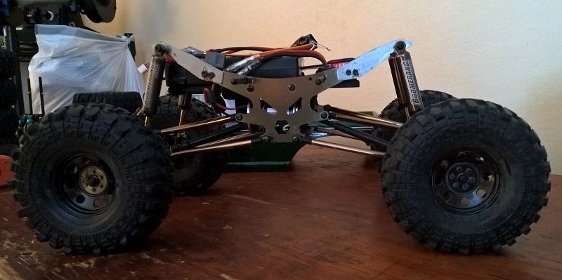

There is a Redcat part called "Connect Box(W/Gear 38T)(Al.)" Part #: 180009. It's metal and takes place of the plastic diff locker that I've heard had issues. You'll need two (front and rear). I have them installed and they work fine.
Setting it up as a faster trail truck (faster than my existing trailers/crawlers anyway). Tempted to make it a mud truck but unsure about the exposed spur and pinion (may attempt to make a cover).
Added some shocks and made some hangers to lower the truck some. Shock issues are keeping me from getting the desired droop (medium internal springs a bit too hard and soft springs a bit too soft). The lower links will be parallel with the ground once I have it set up correctly.
Had some 32 pitch gears and installed them (54/14). Looks like I have some extra slop in the meshing. I'll have to look at that. Also threw in a 20t brushed motor (just to see what it's like). May put in a 35t if I don't like the 20t.

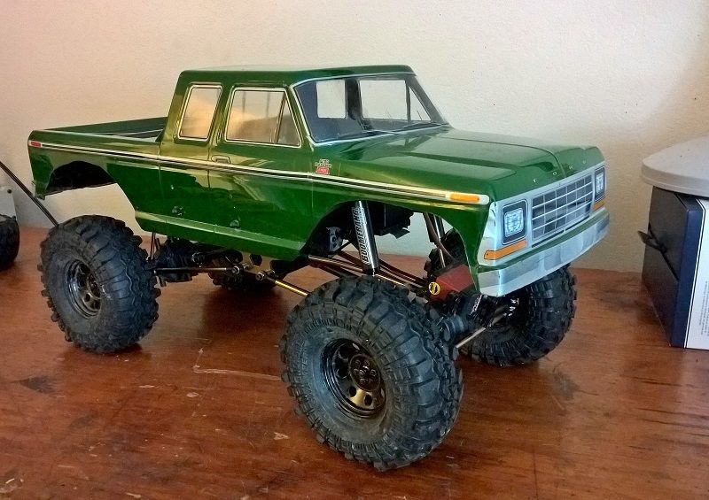

Weighted some 2.2 steelies and put on some Super Swamper TSI tires. Finished with a 1979 Ford F-150 Supercab body.
Been fun so far.
