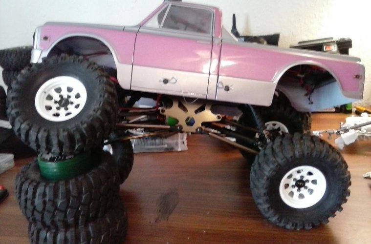

I would like a closer to scale body. What lexan bodies fit the E10 that have the proper wheelbase and width for the stock body mounts? ? I prefer a pickup body.
Here's a couple body options for ya. The Chevy wheelbase is as close as you can get. The Bronco worked out really good too.
They are both Pro-line bodies, but I don't remember what they were for. Been a while, but I think I did shorten the links a little bit on the Bronco, but it's the one with the X-trail chassis and everything was a little different on it after doing the conversion. The only mod I did to the one with the Chebby body was to put small pieces of tubing over the shock shafts to limit travel and keep the tires out of the body. Still has plenty of flex. The E10 has twice as much as it needs in stock form.
This is with 3/4" limiters on shock shafts. Perfect amount for crawling the rough stuff.
