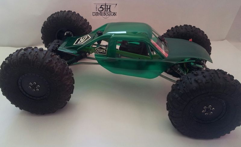

It's alive! Did a little couch crawling yesterday.. I managed to get esc,receiver, bec & a nest if wires on the mounting plate. I'll eventually shorten servo wires.
I went with transparent Green basic rattle can paint job. I was hoping paint job was going to be more see-thru to show off the green Sucker Punch chassis. Looking forward to getting some drive time on this new rig.
I think you have the front rovers on backwards, but other than that it looks great. What is the rtr weight?
Thanks, that's how I run my rover's. It's a pig 4.411lbs. Looking @ pictures again looks like my rear rovers are backwards... good eye.
