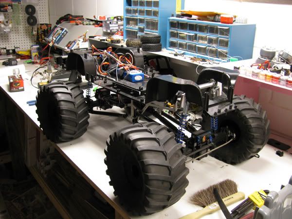

Nothing to exciting. I completed drawings for a new chassis that will be a lot more finished looking. Waiting to have that machined. Started tearing the truck down to finish the small details. Here's a game plan
- Take anodizing off integy shocks and rebuild
- Lock rear diff and rebuild front diff with thick oil
- Sleeve links with Acetol
- Mount servo brackets and servos, links etc with new hardware
- Rebuild maxx tranny to single speed
That should keep me busy until the new chassis gets here.

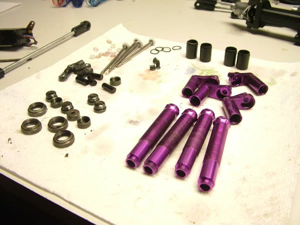

Here's the shocks now. Hopefully they'll be silver tonight.
Not a good turn out yet. EZ off wasn't working well by just spraying it on and letting it sit. I was trying not to get it inside the shocks so the inside stays smooth. Not sure what to try.
Well these shocks proved to be a challenge. The easy off oven cleaner ended up working. A few of them cleaned up after soaking for about 15-30 minutes with them being taken out about ever 10 minutes to make sure they weren't etching. The other parts took almost an hour...
Then I picked up some mothers aluminum polishing compound. $9 for the big tub.
Smeared a little on the shock reservoir and body and took the buffing wheel on the dremel and gave it a good buff. Made a mess doing it but it came out pretty nice! After another round with the wheel I think it'll be really nice. I am not sure how to clean up the threads though. Here's a shot of one that has just been stripped of the anodizing and one that had one round of buffing.

Well it's come to my attention that no one is willing to take on machining these big chassis plates. Oh well, I'm sick of the truck sitting on the bench in parts. It has to go back together. It's just to fun to drive not to.
So back to the bench with the UGLY pieces and parts mock up chassis! Changed around the upper shock mounts since there are reservoirs now. Finished polishing the shocks. Swapped out to MGT springs which look like they'll help for sure. I think I'm going to end up limiting travel and lowering it a bit but I won't know for sure until the body is mounted up again.

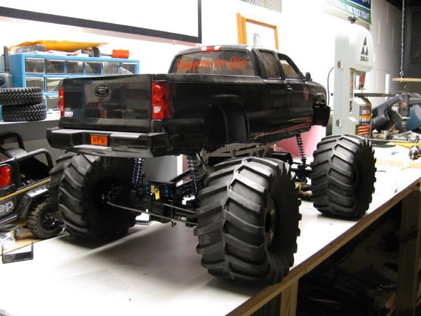

I have an update I'll have to post in a bit. I got it all back together and running. Took a few pictures and some video and too.
Got it up and running today. Found out that the upper links didn't have the right length of all thread them. First pull of the trigger ripped two of them apart
Got those redone. The airtronics servo for the rear steering wasn't strong enough to hold the rear wheels straight under power or while cornering since the rear axle is locked. Ended up taking that off. After modding the front knuckles for more steering and changing to a hitec 5955 servo it steers pretty well now.
I think I'm going to gear down though. It's pretty fast and unstable at speed. As you can hear in the video the trans gears are toast. I think it might be the trans case flexing and allowing the gears to slip?
