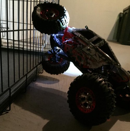

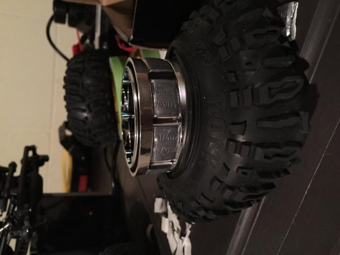

So here it is in all its glory , the only thing I’ve done at this point is add 2 ounces to all four wheels

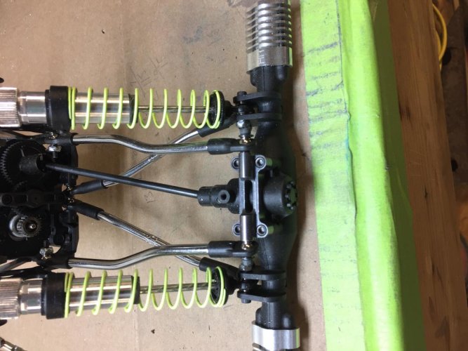

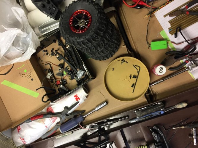

This is the scrap pile lol, at this point I have already inspected the diffs just to make sure it only had one shim on each side of the worm gear and that everything was wearing correctly. I topped off the shocks they were all about 75% full . that’s about it .

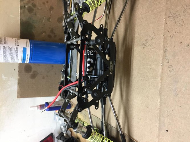

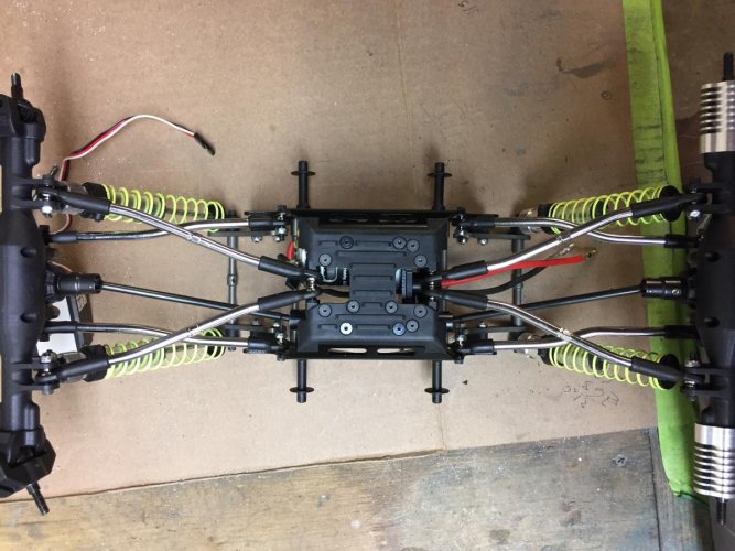

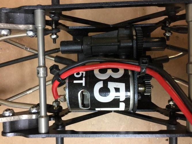

I’ve already have most of it back together i read on rc somewhere that it helps to run the shock upside down in the front ( it keeps the center of gravity lower) so I did that mod. I made the lower track rods from a set of Traxxas 100 mm turn buckles . I made the uppers from 5 mm stainless steel rod.i made the steering links from 3/16 brass rod and they all use Traxxas 4 mm rod ends. Found on eBay a set of side vertical plates that had the comp crawler pins and shock mounts( got lucky there) for a 15$ . I got a set of upper trailing rod adjustable mounts for the axles . And a set of HR lock outs . Motor tranny are stock. I’m going to run it till it needs changed ,with all the added weight I don’t think it will take long. I also got a set of inflatable wheels and swapped my stock tires over to them.now I’m building the front servo and receiver or speed control mount and a plate for wichever don’t go up front , and a battery mount, I think I’m going to make a small tray and mount it directly over the motor idk yet. To be continued
