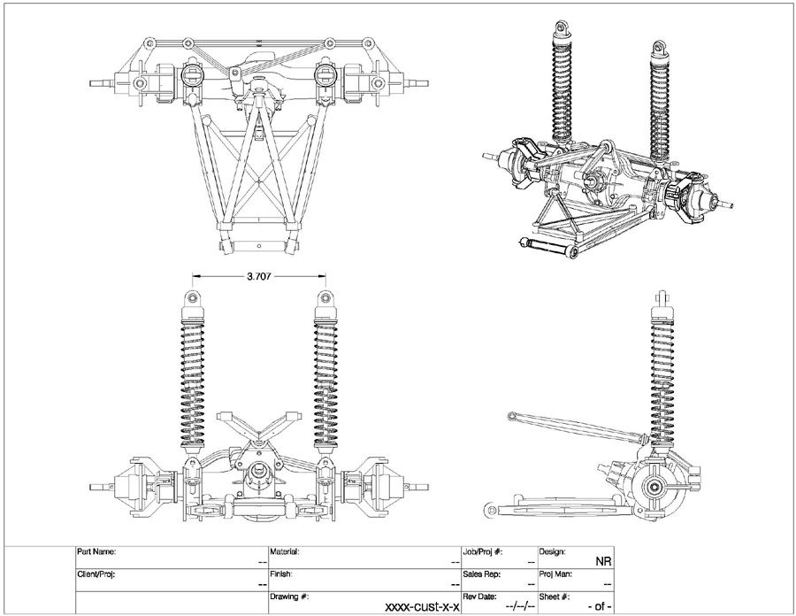

I was wondering if any of you Wheely King owners could give me a dimension from the centerline of shock shaft to shock shaft, preferably at the axle. I am building a chassis and would like an idea for width.
Thanks,
Aaron
this should be pretty close to perfect for center to center at the axle mounts.
Awesome! Its nice to see so many mechanical designers on this board! What program are you running for that drawing? It messes with my head when I see things drawn in anything other than AutoCAD.:D Im so used to using it at work....Very nice by the way!
-Aaron-

As far as the sliders go, how far do you think the stock 4-link can be extended using the stock sliders?
There are little ridges on the axle housings that look like they hold the bottom link/shock mount brackets in place - I'm trying to build a crawler a step at a time, and want to combat the twist a little - moving the mounts all the way out on the axle should help, but do you think they'll stay put?
I'm looking forward to keeping up what you do with Ralph. I've been fabricating stuff in the shop for a long time, but I've never extended that work to my R/C habit. I figure after 20+ years, it's time for me to build something of my own. Thanks for the inspiration.
You MIGHT be able to stretch the wheelbase to around 10.5" using the stock sliders but that would be getting close. There wouldn't be much material hooked together and could be pretty week. Maxx drive shafts will fit right onto the pinion shaft and the tranny output shaft. I stretched my WK to 12.5" using the maxx drive shafts. I had to cut the drive shafts down about 1/4" but it only took 5 minutes with the dremel.
