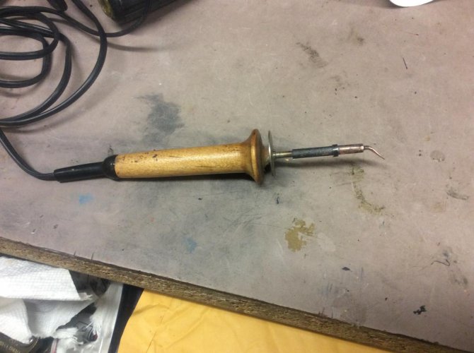

I wish there was a mini tire Groover Iron made for rc vehicles instead of using the dremel.
Isn't a tire groover a hot iron type tool? What about for a RC tire using a soldering iron with a small pointed tip?
It’s a hot iron that has a u-shaped element that “scoops” out the rubber when pushed through the lug. That element can be adjusted for depth.
What you are left with is a bunch of rubber plugs on the floor that is the scooped out rubber.
This is exactly what ours look like.
( I don’t know how big this picture is, Tapatalk didn’t give me an option to select size. So I hope it was already a small picture)
I’m sure you could do it with a soldering Iron. I think that would mess up the tip though because you are using the whole tip to remove the rubber. Maybe an old soldering iron.
Right now, the dremel and cut off wheel works well. Just noisy and messy.
I wonder if one of those wood burning kits would work better. You know for writing and drawing on wood? They have super fine tips...
Interesting. Should work.
As long as it grooved the tire and not siped it.
My thought is, if you already have a dremel that would save you an extra expenditure.
Plus that width of the cutoff wheel seems about perfect for the groove
You got me thinking. Most craft stores sell a small inexpensive tool to burn out stencils for airbrushing. Made sure to put my finger in photo to show how small the tip is.
