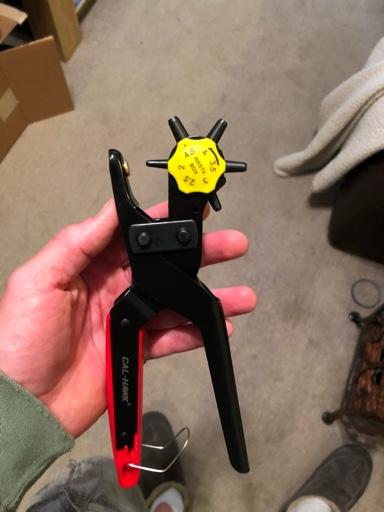

ETA- For those that are not aware, this is an excellent tool for venting tires. Pretty inexpensive leather punch. Smallest size is 2mm which is perfect.

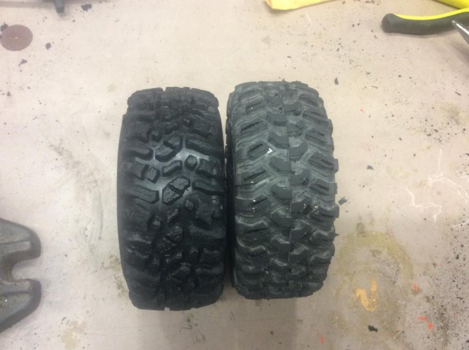

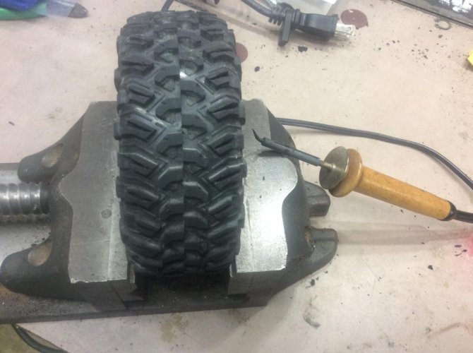

I noticed that grinding a groove with the dremmel...you dob’t Want to hit the next lug towards the center. The hot stick does not get hot enough to burn your own lines...just cleans and opens groove. After grooming it with the hot stick...the lugs are wide on the outside and open up. As they get to the center ...they are thin..then stop. So soft on edges and progress stiffer until the groove stops. I tried the Pitbull Rock beasts vs the modified Canyon Trails today. I climbed one set of rocks then switched tires and climbed again. I wanted to compare as close as possible. I did this through out my test. Though both performed great in there own way...I will favor the Canyon Trails modified from now on. They are a little stiffer and the center luge really hook up on the dirt in between the rocks. It will be interesting what Benp says about his comparison.

My experience was similar to yours. The modified CT’s did just fine and the truck wasn’t held back because of them.
I don’t have the patience in the summer to trim all the little lugs. Lol. I did the outside ones and just on the front. This winter when it’s -30 out I’ll finish the job. [emoji1787]
